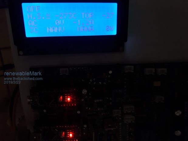

Mark,
I found what libraries are needed to run Madness's program, got them
and made MAdness's program compile OK.
Then I changed nano2 code to use the same LCD library that MAdness uses.
It then compiles and runs fine.
The library you need to make sure is installed is
"LiquidCrystal I2C" by Frank de Brabander version 1.1.2
This is the library I use now.
If you have problems compiling, maybe avoid posting the entire error output.
I know I did not read any of it. It was clear the problem is due to library links.
Best code, using the above mentioned library, and so, likely compatible
with most 20 x 4 LCD with I2C:
2019-03-23_103743_nano2_4.ino.zip
renewableMark
Joined: 09/12/2017
Posts: 1679
Posted: 02:08am 23 Mar 2019
Thanks,
that loaded ok, when the sketch is loaded the screen breifly said "NANOVERTER" then the screen lights up without any writing and the OC light comes on.
I have the reset (NC) plugged in. hit that a few times and nothing. Adjusted the trimpot then hit the reset, still the same, red light on constantly.
Cheers Caveman Mark
Off grid eastern Melb
poida
Joined: 02/02/2017
Posts: 1507
Posted: 02:17am 23 Mar 2019
If the OC light is on, the inverter will never run.
Can you connect to the menu, via the serial monitor?
type "?" and press Enter, get a menu?
I am concerned that nothing much is displayed.
Even when shutdown, the LCD should show stuff.
renewableMark
Joined: 09/12/2017
Posts: 1679
Posted: 02:22am 23 Mar 2019
Tried that, it just restarts the nano, does the same thing and doesn't display the menu.
Cheers Caveman Mark
poida
Joined: 02/02/2017
Posts: 1507
Posted: 02:36am 23 Mar 2019
maybe this nano is broken?
you could pull it out of the socket, power it via the usb cable
and upload the software again. open the serial monitor and see what you see.
(need to wait at least 2 seconds after connecting via serial monitor
for any response..)
or maybe something on the board is stopping it from working.
first things first, let's see if the nano is OK or not.Edited by poida 2019-03-24
renewableMark
Joined: 09/12/2017
Posts: 1679
Posted: 03:17am 23 Mar 2019
That got it
Cheers Caveman Mark

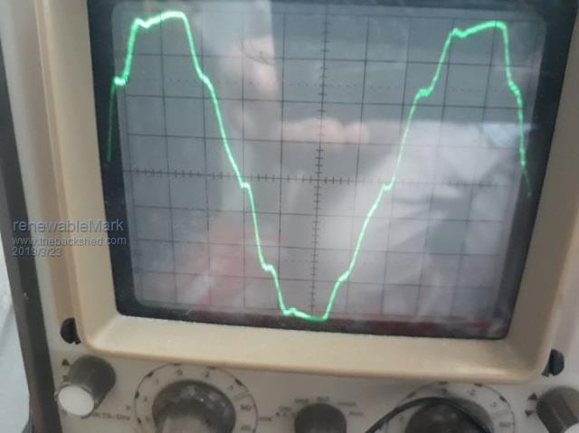

renewableMark
Joined: 09/12/2017
Posts: 1679
Posted: 06:01am 23 Mar 2019
OK running the house now, tripped a few times due to scr.
To increase the allowed current turn the trimpot anti clockwise.
So wave is perfect on everything apart from the dreaded inverter air con as below.
So how to smooth that out??
Tinker previously said to remove the ferrite, I'll give that a go.
Failing that what would smooth out the voltage to stop/reduce these spikes being placed on the machine?
Choke on air con 240v supply?
Big caps on 240v inverter output?
Cheers Caveman Mark
mackoffgrid
Joined: 13/03/2017
Posts: 460
Posted: 06:35am 23 Mar 2019
What brand and model is that inverter Air cond ?
Posted: 06:41am 23 Mar 2019
Would not have a clue Mark.
So many issues it could possibly be. But if the aircon is the only load that does it, that is probably the place to start looking.
I think I might run the aircon off the grid, and look at the current waveform as a first step.
renewableMark
Joined: 09/12/2017
Posts: 1679
Posted: 06:42am 23 Mar 2019
Mitsubishi SRC50ZSA-W
Cheers Caveman Mark
renewableMark
Joined: 09/12/2017
Posts: 1679
Posted: 06:43am 23 Mar 2019
  Warpspeed said   Would not have a clue Mark.
Yeah tried that, it's perfect running with grid.
Cheers Caveman Mark
