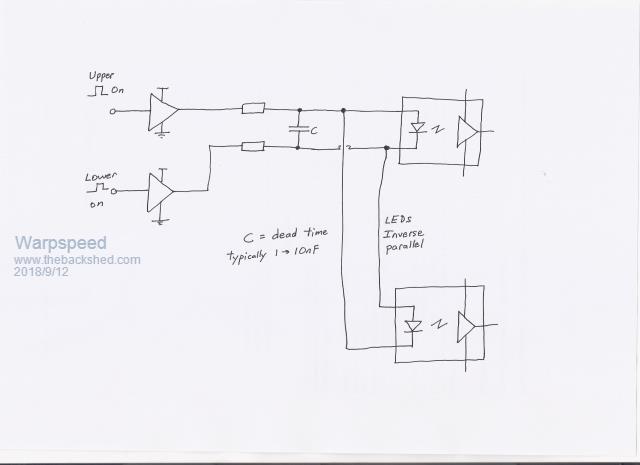

Posted: 01:45am 12 Sep 2018
  wiseguy said   Tony, I concur completely with everything you wrote. I don't rely on rails etc in important stuff - I put monitors for under & overvoltage and staged startups etc.
My only extra I am considering is to put opto-drivers before the TC4452's all close to the output stage to completely isolate sneak current paths back to the control board. I also intend to have isolated DC supplies for the upper mosfet drives - never been a fan of bootstraps with large gate loads. What is your theory for the occasional dropout restart of the inverters in the early morning hours for unexplained as yet reasons ?
Don't know about the drop out problem because my own inverter does not use PWM or any of those Chinese driver boards or Chinese controller chips or Chinese software.
My own inverter is totally different in concept, but I still had to overcome many of the same kinds of basic problems others here are still being plagued with.
My own philosophy is to build a self contained driver board that has all the required inputs and outputs, with its own ground system completely separate from the high power bridge, and only connecting to the -ve side of the main dc battery input at one specific point, which should also be the metalwork/chassis grounding point.
That should keep the worst of the noise and any massive fault currents or transients right out of the control system.
The second golden rule is to totally isolate all the mosfet gate drivers with opto isolated drivers that also have a built in undervoltage shutdown for each opto driver. My own personal favorite is the HCPL3120. These have an 11v shutdown, so need a +15v dc supply to work properly.
I came up with a novel system for connecting the upper and lower opto isolators in inverse parallel to positively protect from cross conduction, even if the driver board or software goes completely spastic. By adding a single optional capacitor across the opto LEDs it will also add some extra fool proof dead time.
This is a very simple circuit, but its been well tested and is absolutely bullet proof to cross conduction failure due to driver misbehavior. Its impossible for both opto isolators to be on together, no matter what! And the transition always has to pass through ground below the LED threshold voltage where both opto isolators will be off. So there will always be some small dead time, which can be extended by adding capacitance after the LED current limiting resistors.
Third golden rule power each gate driver individually from a fully isolated dc power source. Do not be tempted to use a common ground referenced dc supply for all the lower mosfet gate drivers. Make every gate driver identical and fully floating.
Full dc isolation is essential for the upper drivers anyway. Make the lower drivers identical to the upper drivers.
That will go a long way to eliminating noise in the gate circuits, and any cascading failures, where the +48v gets back onto any common +12v rail which could cause massive damage to spread throughout the whole system.
If one bunch of mosfets blow up, the fault cannot escape back into the rest of the system, any damage will be localised.
Preventing blow ups in the first place is only half of it. The other half is preventing the resulting damage from spreading further.
A bit of thought and planning as to possible failure modes and the consequences (otherwise known as extreme fear and paranoia) may involve a few extra parts, but it can save a lot of tears later on if it does spit the dummy.
