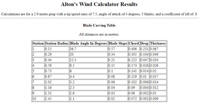

http://www.alton-moore.net/wind_calculations.html
Been using this wind blade calculator for years and it is pretty accurate

This was one of the first ones I had seen actually, but it says the same sort of thing. At the root, its like 400mm wide. That is massive.
Just doesn't make a lot of sense to me right now...
Posted: 09:29pm 11 Jun 2018
You might have missed this part.
Please note that near the hub you will usually be limited as to the blade's angle/slope, chord, and thickness by the size of the material. Usually it will suffice to use the largest result which fits in the material you are working with, or just carve the flat side of the prop from one corner to the other of the (rectangular) material. The outer part of the prop is the most important anyway.

So is that saying, if the above table doesn't fit the material, then just wing it, and make it as big as you can at the root, and 'she'll be right'... ?
Then its basically a taper from the root to the tip.
Problem with the pipe is all the slops and stuff are not exactly easy, or possible to replicate.
I think ill just keep going with my hack job I am doing now, and see how they perform.
Posted: 09:46pm 11 Jun 2018
The centre areas is only a very small percentage of the total swept area so it does not affect it by that much. Near the centre the blades speed is much slower so that is why there is the steep angle and massive cross-section. That is in a perfect world which we don't live in, blades that are straight like the Aluminium ones still work well. Look at the giant wind turbines and see how they do it.

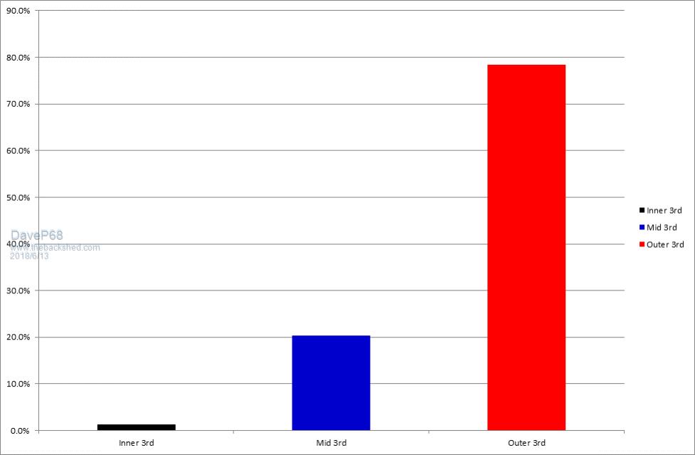

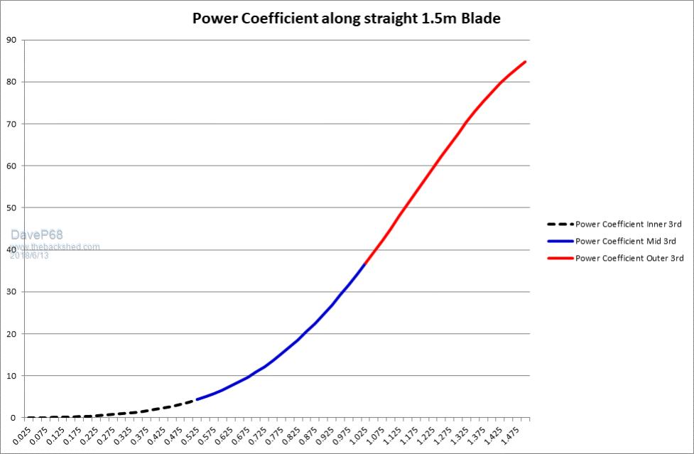

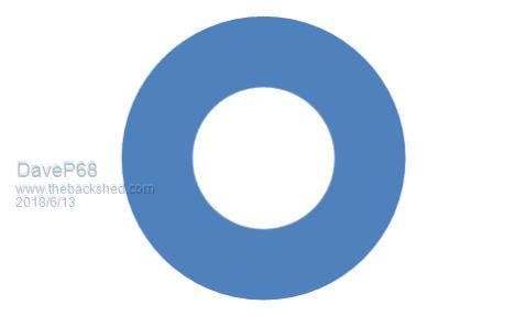

Yes Madness is 100 % correct here. To illustrate this in a visual manner I've made some graphs.
First up shows the outer part of the Blades swept area and it's not to scale.
A graph of 60 points along a 1.5 m blade at 25 mm intervals showing how much power is produced at each interval if total power on the shaft is 1000 W.
A Bar graph showing the power output percentage of each 0.5 m section along the 1.5 m blade from inner to outer.
So as can be seen the inner 0.5 m section of blade is producing only 1.4% of the total power. The middle 0.5 m section is 20.3% which is still significant. The outer 0.5 meter section is producing a whopping 78.3 % of the total.
Took a bit to crunch the numbers on this and I'm confident that they are close to what is happening in real world conditions.

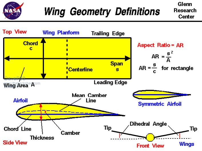

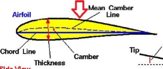

On a separate note for James, here is some info published by NASA on Aerofoils.
The trick is to try and profile the outer half of the PVC blades to follow a profile close to what's shown above. This may require a small reduction in the Chord line.

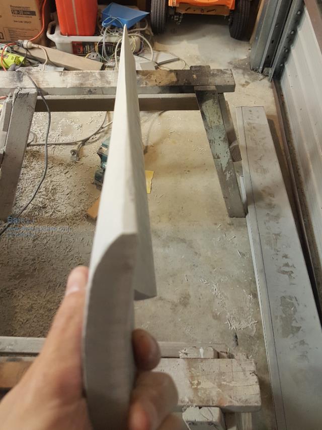

Been extremely busy with work, so haven't had a lot of time to play with this, but I am doing a bit of blade grinding each evening.
Still very much a Work In Progress

Like I stated above "The trick is to try and profile the outer half of the PVC blades" as that is where at least 93% of the power is produced and the outer 3rd accounts for 78.3% by my calculations.
Detailed profiling of the inner half of the blade is a bit of a spent force at it only contributes about 7% to the overall output power.

If you follow the NASA Airfoil closely over the blades length this will help reduce some of the blade weight. The point I made above about the outer half being more important is more to do with how symmetrical the profile needs to be.
The trailing edge of the blade should have 25 % of the overall material going by the NASA profile and end at a sharpish point which I can see is already there.

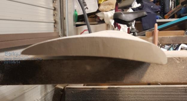

Yep, one edge is sharp from about 1/4 down to the tip. The end of the tip is still pretty solid, so I need to take some meat out of that.
Unsure exactly how the tip end should be though. Somewhat rounded to match the 3m or so diameter I assume, but in terms of thickness I assume it needs to be thinned to be somewhat sharp at the tip too (not the edge I already have sharp, but the end)Edited by BarkyJ 2018-06-15

My point regarding ending in a "sharpish point" relates only to the entire "trailing edge" along the blade length.
I wasn't making any reference to the end of the blade.
The end of the blade needs to have the profile of the airfoil.

Blades are approximately 4.5KG each, at the moment. But still more trimming to go.
I'll leave the ends like an airfoil.
