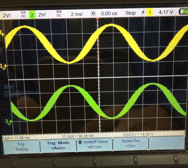

Posted: 03:04pm 10 May 2018

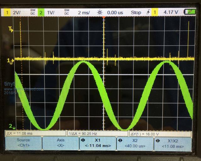

  poida said  ...I changed parts of it to make two 50Hz PWM sines come out of pin 9 and 10.
This is following Warpspeed's thoughts of getting away from using a 50Hz square wave on one end of the bridge.
I applied the code change to your original Atmel Studio compatible code and scoped the OCR1A and OCR1B outputs. The soft start takes about 11 seconds to complete. CH1(Yellow) is OCR1A output and CH2(Green) is OCR1B output. For the SPWM captures, the 'scope is bandwidth limited so I did not have to use the RC network at the probe tip.
I transferred the CH1 probe to the PORTD7 pin and triggered on CH1. With scope cursors function, I measured the frequency of the CH1 pulses and it measured 90 Hz instead of 50 Hz. Maybe the code needs some minor adjustments.
I played with NPWM value and when I changed it from 400 to 720, the scope measured 50 Hz. And when it is 600, the scope measured 60 Hz. I almost failed in math during my school days, so I really don't know what the code is doing.Edited by tinyt 2018-05-12

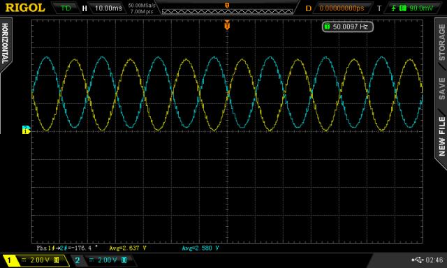

Tinyt:
I attach modified code that outputs 2 sine waves out of pins 9 and 10 which are connected to TIMER1. Changes to the code include:
clearer illustration of output frequency setup
#define NPWM 400 // 400 pulses for a full sine wave
#define PPWM 799 // clocks per pulse (Arduino timer uses 1 x system clock, 16 MHz)
// so (16e6 / 800) / 400 = sine wave output freq. = 50 Hz.
// for 60 Hz, PPWM = 666 ... 59.9816 Hz using DSO freq counter
// for 50 Hz, PPWM = 799 ... 50.0096 Hz
a full sine wave pulse width lookup table. Since a sine wave goes negative,
we need to offset it by +1. Now it is 2x too big, so the scale becomes 8192
for(t=0.0,i=0; i <= NPWM; i++,t += 2.0 * 3.14159/ (float) NPWM)

And the attached code works on my Arduino Uno, using an AVR ISP II and Atmel Studio 7.
Press the button (pin 8 puled to ground) and you get two nice sine waves at 50 Hz.

Thanks poida for the detailed explanation.
Looks like I picked up the wrong #defines:
  poida said  ....
I want to share the current code I am running.
setup() is run once and initialises the sine wave table, variables and sets up the two timers that periodically run their particular code blocks.
loop() is run repeatedly ad infinitum.
#define cbi(sfr, bit) (_SFR_BYTE(sfr) &= ~_BV(bit))
#define sbi(sfr, bit) (_SFR_BYTE(sfr) |= _BV(bit))
#define NPWM 200
#define PPWM (160000 / NPWM)
uint8_t f50,oen;
And in the first zip of the Atmel Studio compatible code:
* GccApplication2.c
* Created: 20/04/2018 9:49:15 AM
* Author : w7-64-vm
#include <avr/io.h>
#include <math.h>
#include <avr/interrupt.h>
#define NPWM 400
uint8_t f50,oen;
Using this now makes the frequency good in the NANO/STK500 setup I am using.
I wish I can test in hardware. My inverter is still un-finished and I don't even know if my inverter circuit can do bipolar. Don't we need a total of four SPWM signals?

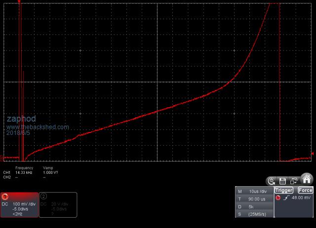

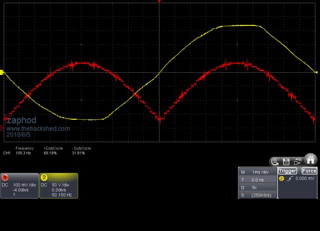

A timer ISR running at ~6.4Khz (50*4*32) outputs this to a 10 bit DAC via a 5*5 multiplier, the other 5 bits coming from a power control function.
The resulting DAC output compared with a certain 110Vrms referance signal is shown in the attached scope shot (phase & frequency locked).
As for the resolution I consider it more than adequate compared with all the non-linearities and distortions that occur downstream of the DAC referance caused in part by the power stage and in part by the loads :)
As for harmonics I live in an industrial rural area so a high impedance source (long lines) combined with high power electronic drives just about maxes them out without any contribution from me :)
Of course the principle of referance source is the same for ferrite or iron power stages.

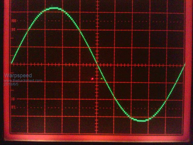

Anyhow, a three inverter stepped system with 27 steps produces about 4% harmonic distortion, about the same as measured off the the grid. A four inverter stepped system with 81 steps peak to peak produces 1% measured harmonic distortion without any filtering.
It looks like this, straight from a wall outlet on a wide band oscilloscope at 100v per division.
