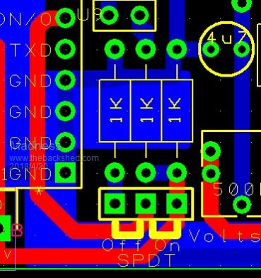

I have had one last look at your board Gary. Struggled a bit tracing all the ground tracks. went a little crosseyed.
Only question I have is where is the left 1 k resistor (of the group of 3) connected, I dont really understand what it is doing.
Posted: 12:20pm 20 Apr 2018
Hi Yahoo,
That is the off position of the SPDT switch connects to ground via the resistor.
I will see if I can post some clearer pictures soon, just redoing a lot of the area around the Nano to include temperature sensing, fan control and current sensing.
Also a slight change to the mounting holes so the TIP35c's and MOSFETs for the fan control can be flipped (if you want to) under the PCB and screwed to the +48V heatsinkEdited by Madness 2018-04-21

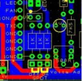

thanks, I blew the .jpg up to 300% and I couldn't see the track to the switch.
if it is any help a .gif is a little grainy but the pic can be much larger (1024 pixels wide).Edited by yahoo2 2018-04-22

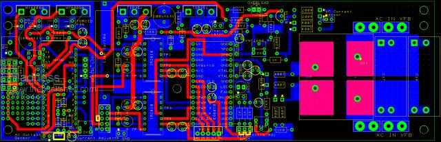

Lots of changes around the Nano, added fan control from the Nano so the seperate fan controller is no longer required, AC current sensing and temperature sensing with DS18B20 digital sensors.
This will require a separate 12V power supply the same as we are using already to drive the fans. The sensors are digital and you can have a lot of them all on one pin as each one has it's own identifying number. The current sensor is the same as already used but using a separate one so nothing interferes with the original one.
The attached PDF is much easier to read and lets you zoom right in.

Perhaps a low impedance load across the coil, and a zenner acros A0 to ground to protect the nano.
Warp mentioned some time back, that these coils can generate very high emf under some circumstances... the low r load stops this, and the zenner makes sure.
.......oztules

2018-04-22_121453_Mad_Inverter_Control_Board_V2.pdf
JohnMc, I guess the dot is for polarity, it is not needed on the current sensor but it is a bit of a fiddle to get rid of it.Edited by Madness 2018-04-23

Just had a good look at your version 2.
That's a tidy compact Control board and with the cooling board, and a nano board combined, very nice Madness.
Posted: 11:00pm 22 Apr 2018
Thanks Clockman, I have now reduced the length a bit by using shorter components for the VFB Diodes. Also I have tidied up the tracks more, unless someone finds a mistake this should be the final version to get manufactured.
2018-04-23_081023_Mad_Inverter_Control_Board_V3.pdf
