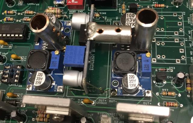

The pre-assembled LM2596HVS DC-DC I bought from alliexpress has an input capacitor marked 100 uF 63V. The chip is marked LM2596HVS ADJ, not sure who is the manufacturer. TI datasheet says that absolute maximum input voltage is 63V and recommended operating max input voltage is 60V. My benchtop power supply is a dual 30V 1.5A which I connected in series. With the two in series I was able to get 62.1V with the coarse and fine dials at max. It is this voltage that I am now feeding my experimental board which has three LM2596HVS chips for close to an hour now and so far no smoke. Current draw is 0.06A (no fans, no power mosfets).
When I powered it for 24 hours (no fans, no power mosfets) the hottest of the three chips measured 78 deg C. It is hot to the touch, but the datasheet says its max operating temp is 125 deg. C. But because it just relies on the small PCB copper area for heat dissipation, I plan to solder a piece of copper sheet to the chip tab for additional heat dissipation.

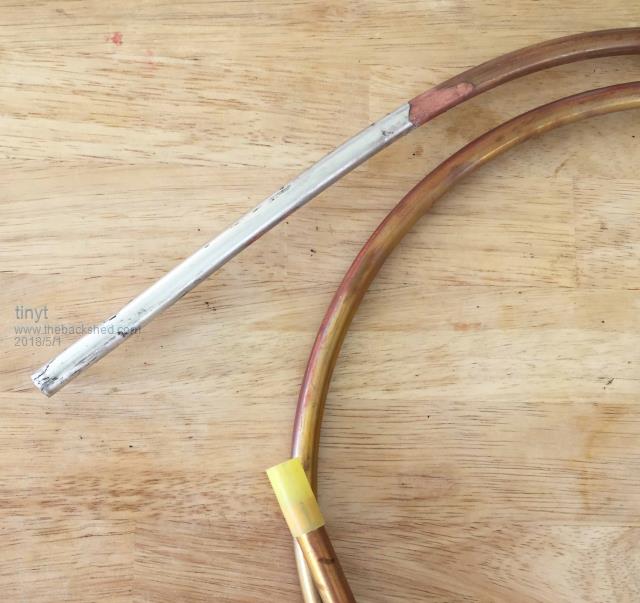

I finally finished the roof install of my solar panels. Now I can go back to the inverter. I found a leftover 3/8" dia. copper tubing for the DC-DC heatsink. I pre-tinned a section:

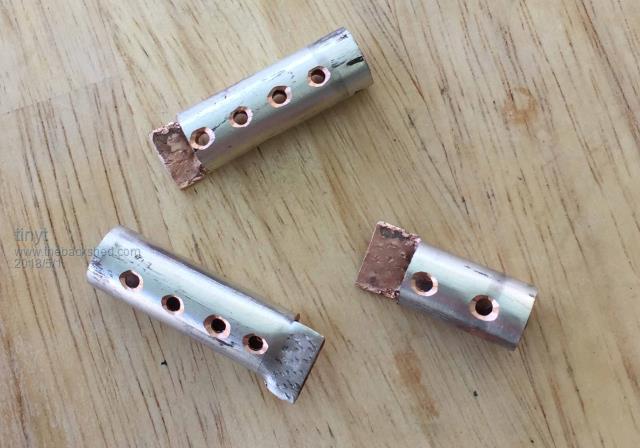

Then I fabricated the heatsinks.
And soldered them on the LM2596HVS tabs.
Again using a thermal probe on the hottest LM2596HVS, the temperature dropped by 10 deg. C. But when I get the better DC-DC converter that Madness found, I will replace the LM2596HVS pcbs with them.

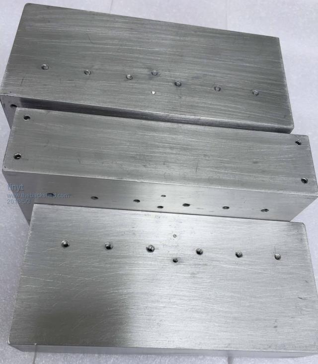

Posted: 05:09am 03 May 2018
Worked on the heatsinks.

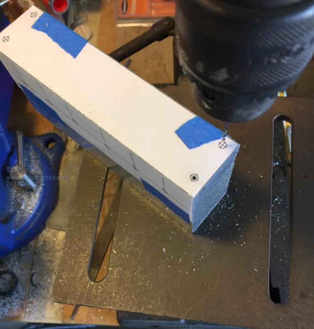

Drilled pilot holes first:
Then used correct size drill and then tapped the holes:

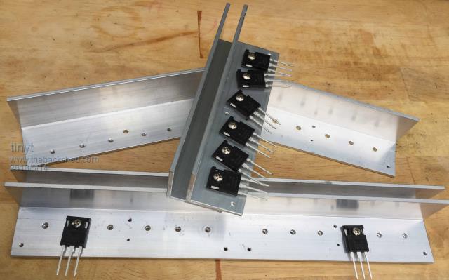

An alternative to buying or re-using real heatsink is to buy aluminum angle bar and fabricate it. This is 1.5" x 1.5" x .125" angle bar purchased from a local home buider store (Home Depot). I think it has enough mass to absorb the heat from the mosfets and enough surface area to dissipate to surrounding air.
I am going to try this first. If it is adequate enough, the re-design of the PCB will be smaller since I can move the heatsinks closer to the large capacitors.
Posted: 04:04pm 13 May 2018
tinyt, you run a risk with these angles in my experience. I have experimented with 2" x 2" x 0.25" alu angle at the beginning and still managed to blow Mosfets. These things have two *very* tiny (hair size) wires inside from the drain leg to the substrate.
There is no way these could carry the quoted amperage.
So, it is essential that any heat build up is prevented by *very* good heat sinking.
I use no insulating washers either for that reason.
Your angles might work for tiny loads, like a couple of hundred watts but if you plan to switch two or three kilowatts suddenly on you need a beefy heat sink with a large fin area and a thick base of at least 5/8" or better 3/8" thick.
Actually, you do *not* want the heat sinks close to the large capacitors, these capacitors live a lot longer running cool. I have mounted my capacitors on the opposite side of the PCB for that reason. This also made laying out the heavy current tracks easier.
Talk to your local solar installers and see if they have a junked grid tie inverter. You can salvage a very decent heat sink from even a small 1KW unit and a brilliant one from a 3KW inverter.

Thanks Klaus. I will try it on small loads then. What mosfet part numbers were you using during your experiment?
Posted: 09:24pm 13 May 2018
With no load at all you can run the inverter with no heatsinks at all. But this is only for initial testing and providing everything is running correctly, even leaving out the primary choke would cause overheating like this.
I agree with Klaus any decent load and you are going to have hot MOSFETs. You can try it with what you have there and see what happens. If you can gradually increase the load while monitoring the temperatures you will soon see what will happens.

No problem. I use HY4008's.
As mentioned, these Mosfets have tiny internal connecting wires and cannot tolerate a marked temperature difference between its case and the heat sink. The wires evaporate and the case explodes. You guess how I know that .
Any heat needs to be sinked away as fast as its generated, so no hot spots occur. That requires a thick base heat sink or a fan going flat out when heavy currents are switched.

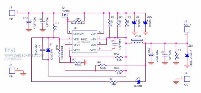

On the 90V input DC-DC I am experimenting to raise the output to 18VDC: The first of the four, I changed only R7A and it failed when loaded. The second of the four, I changed R7A and R8A and it also failed when loaded. The third of the four, I was poking around with the DMM probe and damaged it. I was left with one 12VDC output.
So I asked the vendor if they can make an 18V version, after several messages, they said they can only make 17.6VDC and not to exceed 30 Chinese watts, I ordered. By the way they increased the price now from $5/2pcs to $6/2pcs. Will see when the part comes in.
Meantime I did more web search and found a schematic that is very close and made one with values changed for the ones I previously odered. Maybe I should have changed R5 and ZD1 also when I was experimenting. I don't know if this will be useful to anybody else, but here it is.
