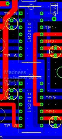

Can you get it running with 4 FETs, no caps, a series resistance and no load? When you do please post CRO shots of the 8 test points below. Ignore the IR2010 the pins are the same as IR2110.

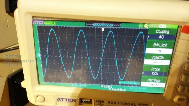

I now have working , one of madness, new pcb control board, that has been modified as suggested by tinker and shown on madness updated pcb drawing this coupled with one of clockmans power board at present only one set of 4 fets and large capacitors will update when I fit 16 fets .The on off switch at the moment is attached to the pcb as per madness,s suggestion.

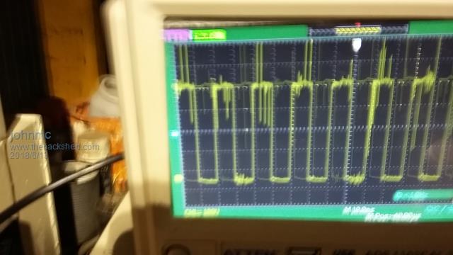

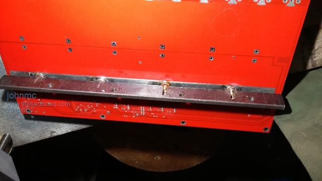

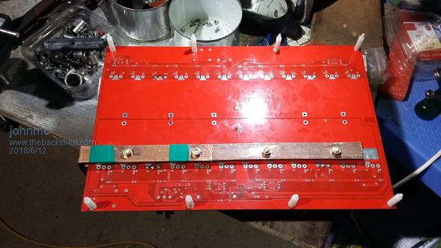

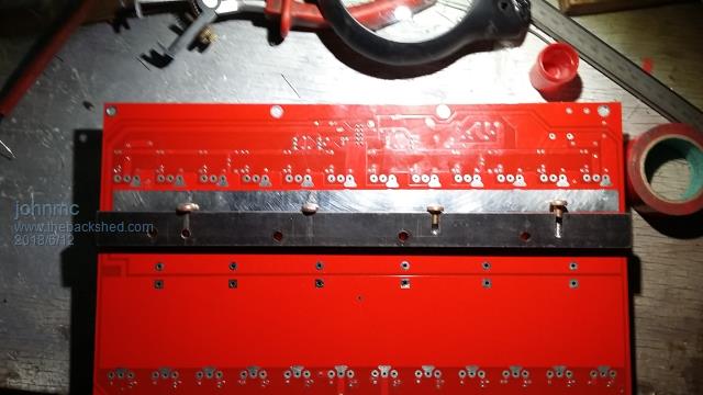

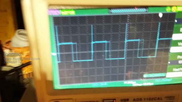

The latest inverter build with madness power and control boards with no large capacitor
The powerboard negative rail had copper bolt soldered to the PCB
The 23.5 khz signal has spike overshoot
Is this a product of my scope as it does not appear to affect the output sinewave?

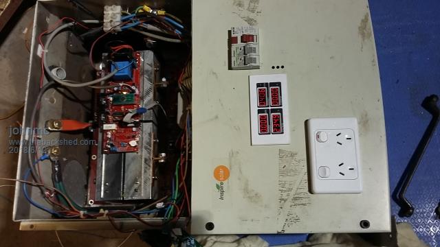

because of the history of Inverter blowups almost always on start up after overload or initial startup or the dreaded reset button.
I have tried to make removing the powerboard as simple as possible
All the connections to control and power board have been brought to the top for easy access
cheers john

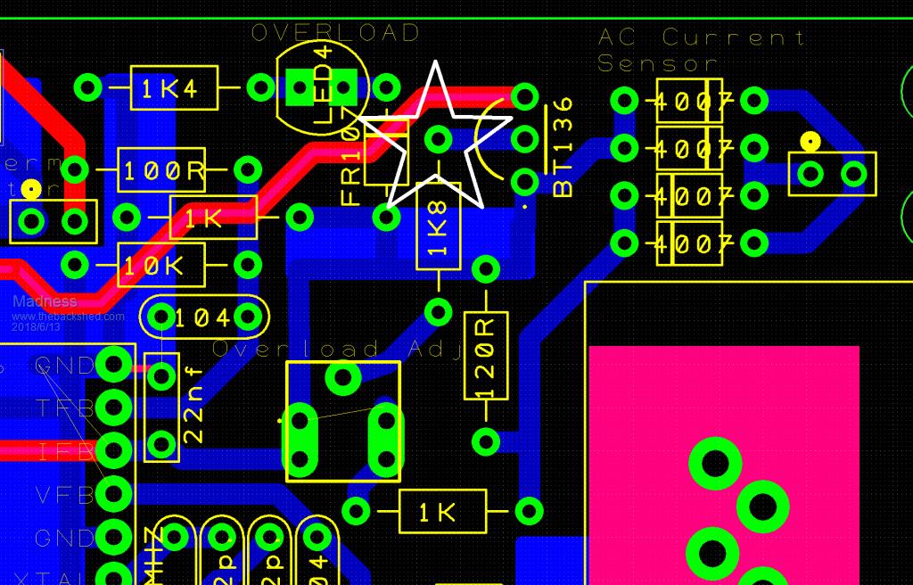

John, I have found a better way to reset the Inverter after an overload. Instead of grounding the 5W 120 Ohm resistor connect the wire to the 1K8 resistor as shown below. I have tested this when the Inverter is in overload state short this point to ground and the overload LED turns off and after 5 seconds the Inverter does a soft start. No need to turn off the power switch or anything else, just ground it as shown, the BT136 turns off, the EG8010 recognizes that the overload is gone and does a nice calm soft start. There should be no risk of a catastrophic blow up that a few of us have had doing a hard short. You can trigger an overload by connecting a 9V battery across the current transformer connector on the PCB if you want to test it.

With 4 fets fitted toroid fitted and no restriction to the 50v power supply
sinewave as previous post

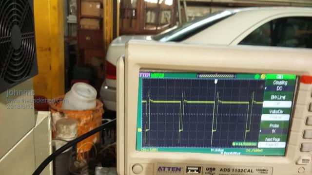

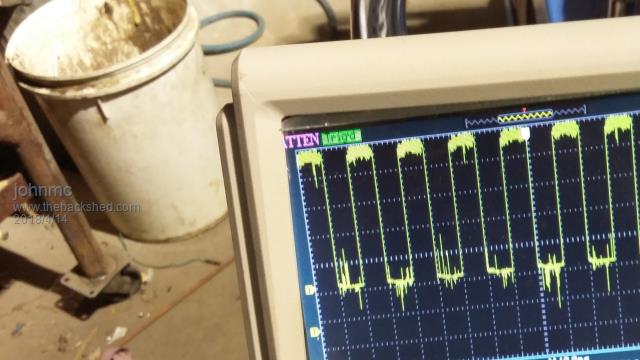

Test 6 all 24 FETS fitted no capacitors,
15 ohm resistor in series with 50 v battery supply
No toroid fitted in the following pictures,
Picture of powerboard low side Fet output
toroid low side Fet output
Picture of powerboard high side Fet output
Has any one taken pictures of the powerboard with no toroid as there stil appears to be too much hash and as I have now destroyed 170 Fets I am going to be more cautious .
