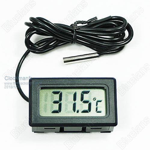

One thing I missed was the digital temp thermometer for the control board,
What have others been using?
Cheers Caveman Mark
Off grid eastern Melb
Clockmanfr
Joined: 23/10/2015
Posts: 437
Posted: 07:21am 24 Jan 2018

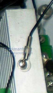

This is what I use, and recommend.
The OzInverter normally has 5 temp probes.
I just use the probe and its cable, junk the rest, and direct wire the probe cable to the OzCooling board and one to the Overtemp connector on the OzControl Board.
https://www.ebay.co.uk/itm/NEW-BLACK-AQUARIUM-TEMPERATURE-GAUGE-LCD-DIGITAL-THERMOMETER-FOR-FISH-TANK-WATER/400545190663 ?hash=item5d425a9307:m:mLMcVjMgtXPoAtFnONmH2oA
Probably find these even cheaper. I like them as the probe is ready made and sealed and the connection's done, and its easy to clamp/hold that probe down.
Or you could make your own probe with a 10k 5% Thermistor Temp sensor NTC MF52-103 3435. these are very cheap, but need cabling and connections.
I trust this helps.

renewableMark
Joined: 09/12/2017
Posts: 1679
Posted: 08:13am 24 Jan 2018
Ahhh thanks mate, I already have plenty of these as I strap them to fermenting barrells when making grog (hic)

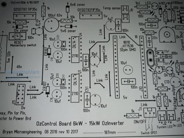

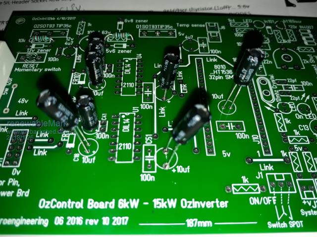

Just started dry fitting some components to the control board.
The parts list has 4x 10 uf electrolitic caps, however on the board there are 4 spots which are marked 10uf that are the correct size on the left. Two more are toward the centre but have a bigger outline and there is another that sits under the 8010 board, that one looks the correct outline size, however there is no polarity marked.
Confused, parts list states 4 are req'd, outlines for two are different size.
Pic is of loosely fitted parts for clarity.

renewableMark
Joined: 09/12/2017
Posts: 1679
Posted: 10:14am 26 Jan 2018
OK parts list also shows monolithic chip caps x 5 that is probably the one with no polarity marked then, dunno where the other 4 are though.
Cheers Caveman Mark

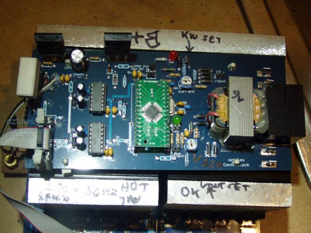

oztules
Joined: 26/07/2007
Posts: 1686
Posted: 10:17am 26 Jan 2018
crappy pic I know
The four on the left in a straight line are electro.
All the other caps ( but for the 100uf) I use ceramics.

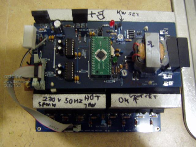

tip... do the lowest components first ( resistors, diodes etc ).. then caps, then 8010 etc. Makes it much easier to do....oh, and make sure there is clearance for the crystal above the board ( say 1mm air gap )
This is my normal unit complete with 16 hy4008. It easily does 14kw and more for start up of 5hp motors..... don't know how many I have made, but they all work out of the box... plug and play.
One neighbor who has one as a back up for the grid system here ( flaky) told me the other day he was running the house with it ie hot water on, fridges and freezers and air conditioner, etc etc, and was welding some stuff up for a sizable project... thinking all long the welder was on the grid circuit, only to find the whole lot was running off one of these things... he is a true believer now.... before he thought they were beaut, now he thinks they are legendary.
....oztules
edit this is clearer.... just

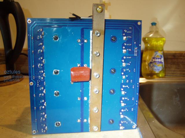

And this is how I do the neg installation... I use a 1/8" copper bar ( 20mm wide ), and sweat it onto the board, and then screw it as well.
Makes the board easy to install.... 4 bolt points for the cables, and a few plugs to the top board.
