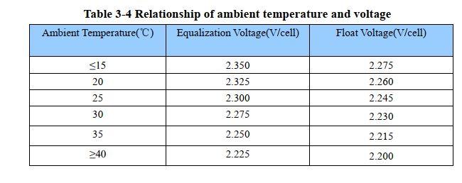

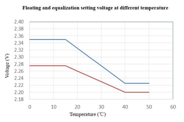

I use the BV absorb tempco for 18 months or more.
My battery needs the absorb voltage to be modified by about -0.12V per degree
over a range of 15 degC to 40 degC
this is from the manual for my battery (blue is absorb/equalisation)
which is this data

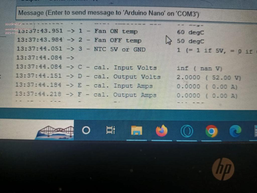

Posted: 08:42am 28 Nov 2023

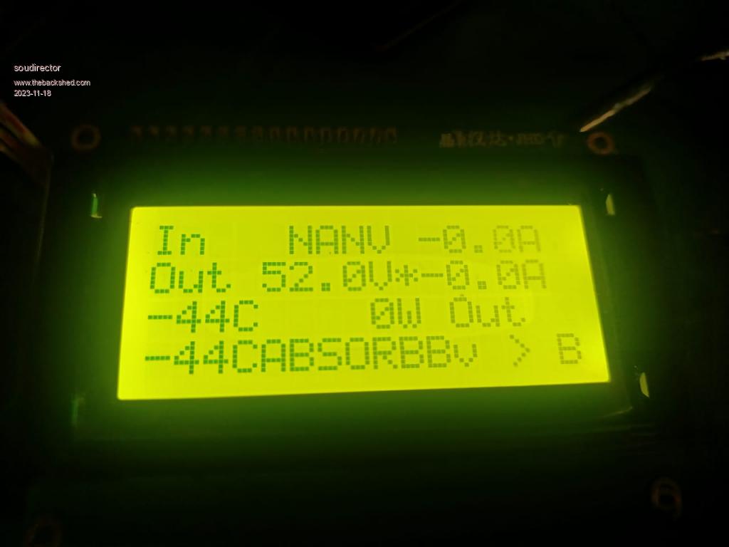

  nickskethisniks said
  soudirector said  I am have not gotten this to work. When cal. i type in the VIN but i still have NANU display.
in the serial monitor window
it will change to this
13:37:44.084 -> C - cal. Input Volts     inf ( nan V)
But VOUT display whatever i put there.
What am i not getting right ?
[/QUOTE
I think you need to " zero " it first
I did all that before cali but still having that issue. i need solution to overcome it any further help house?
how times flies
poida
Joined: 02/02/2017
Posts: 1507
Posted: 10:01pm 28 Nov 2023
maybe it's a communication problem between serial console and nano.
I recall sometimes sending 'C' or a few other letters to the nano
would result in nothing at all happening.
I tried different line ending choices as well as
tried sending the text (a single letter from the keyboard)
simply by pressing 'enter' but also clicking on the 'Send' button.
There are 4 ways to complete the line of text that is then sent
to the nano (or other controller) when using the Arduino serial console.
Newline
Carriage Return
NL & CR
No line ending
where newline is the character 10 (in decimal) and carriage return is 13
The serial console will send data just by you pressing the 'enter' key
after putting the mouse cursor on the top text area and typing something.
It will append the chosen line ending to the text before sending it.
I think the line ending that will work is
Newline
so try that and see how it goes.

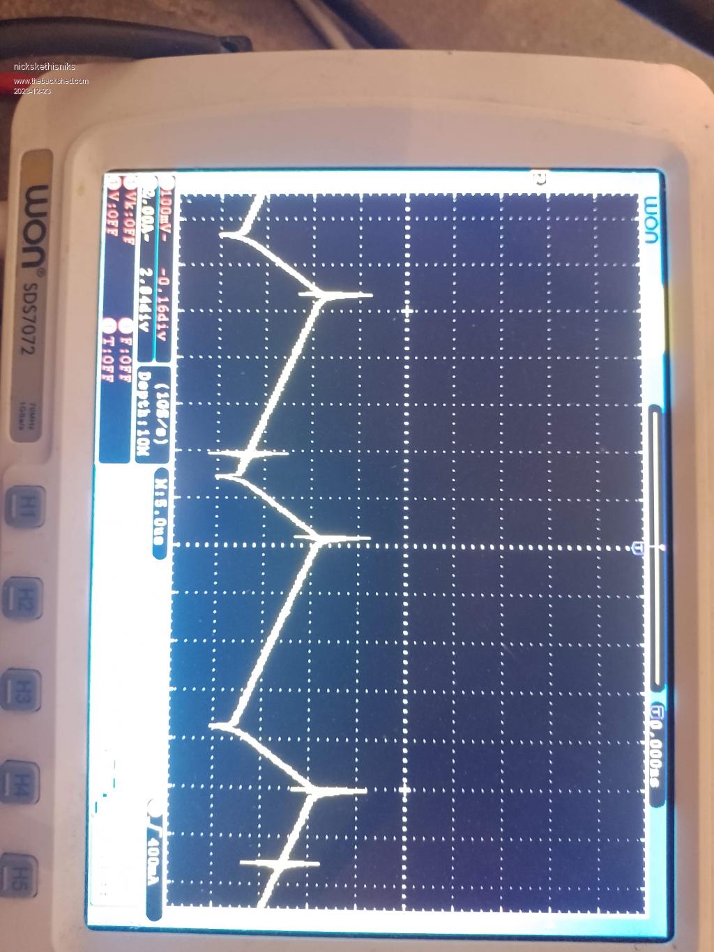

Just some things I want to share about the tracking algoritm.
Since I'm replacing my older with newer higher voltage panels I've noticed some troubles finding the tracking Point. When output current is around 10A I see a robust mpp. But with lower current it's switching between 60 and 80V input voltage...
My mppt controllers have a relative small inductance +-50uH. Wich was enough to convert +- 60V to +-52V. And I've never seen tracking issues.
I now have around 74V so this makes more than double the voltage difference and this requires more inductance to let the current ramp up more slowly.

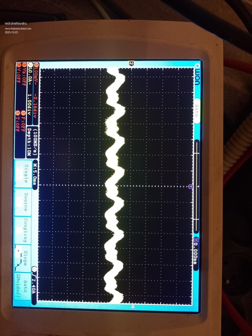

I've noticed a second issue in my system, and that's the ripple current/voltage (100Hz) produced by my inverter.
I have connected a current clamp to my scope and the buck inductor and there I could clearly see a 100Hz current waveform combined with the 20/40khz of the mppt controller. So when the inverter was drawing decent current it probably has a bigger influence on the the tracking algoritm then a to small inductance of the buck inductor. I should probe the output current sensor but I think I would see a simular result without the 20/40khz component. When the solar current is high compared to the ripple the inverter is pulling this would have no influence. But apperently my inverter is using the capacitors of my mppt controller
I will post some scope pictures if I have the opportunity.

Here there is a waveform of the input current,
(readings are actually 1/10 so around 3-5A at that time, I don't know)
The current probe I'm using is a micsig CP2100B and it's picking up switching noise quite easily, not all noise is actually real.
I think this is a quite usual waveform, although you can already see some 100Hz influence.

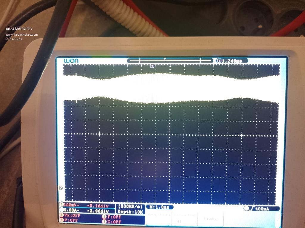

Next image is on the outputcurrent (again actual current is 1/10 of the current measured)
What we expect is a rather clean DC waveform but there is a substantial AC ripple current, coming from reactive components and/or current ripple because of long wires between my battery and inverter. Power was only 2-300W (at 48V) at the time.

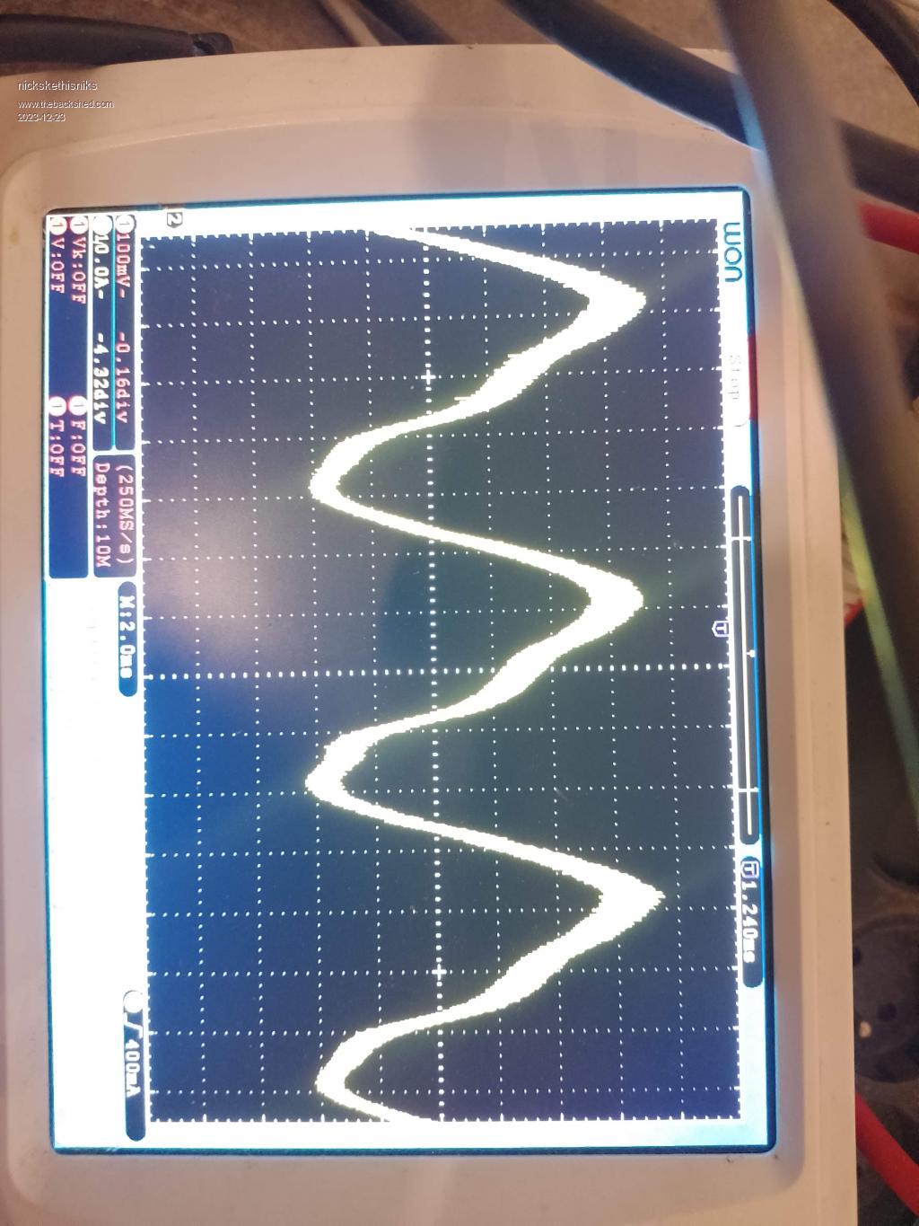

Next a waveform of the current thru the buck inductor (I had polarity wrong)
Then with longer timebase ( again polarity wrong) you clearly see the 100hz again
Sorry for the turned pictures.....
Edited 2023-12-23 07:32 by nickskethisniks

Thinking about it,  the ripple your  seeing is a direct result of voltage ripple on the battery voltage: as the pwm ratio is constant between tracking adjustments or scans, then the current through the controller inductor will go up or down as the battery voltage goes down or up; so the analogue and digital filtering on the inputs to the nano will have no bearing.
In my case i had come to the conclusion that my low current tracking issues were due to my high 5:1 vin:vout ratio, and the fact that i packed the board with 560uF caps from a GTI. When the output current is <1a the input current is <0.2a and you can see the input capacitance voltage rising slowly post-mppt scan. I partially solved it by slowing the scan right down at low power levels, but still found it was often missing the MPP - your 100hz ripple might well be the issue as it could easily swamp the small current variations with pwm.
I was planning at some point to replace the input caps on mine with smaller ones, but have to bear in mind that when running at 45a output the input caps still have to supply 40a when the mosfets are on.
Still not sure how we can stop the 100hz ripple current though, or stop it showing up in the mpp scan currents
