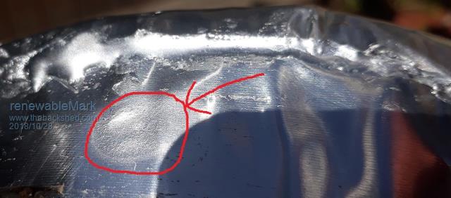

Well I remembered there were some al brazing rods in the shed.
It's hard stuff to work with as the melting temp of the material and the rods are very close.
I took the sleeve and top hat off to braze them together.
You can see a circled area where it got too hot in one section.
Tricky stuff to work with.
Of course this can't be done on the toroid.
Thinking if there are two sleeves with hats brased together off the toroid, they could each have a small bolt brazed to the top hat section, then each side slid on the toroid and a connection could be made through the centre to each top hat section, thus completing one turn.

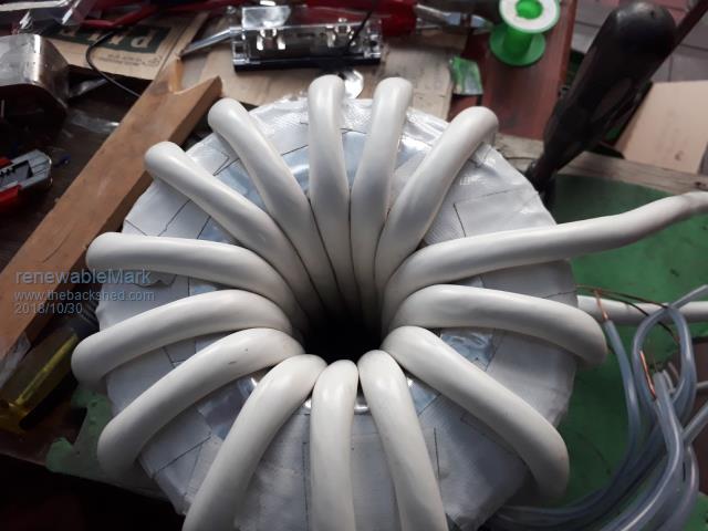

This time I used welding wire 70mm, but removed the outer orange insulation.
Frigg, soooooo much easier than using the recovered wire twisted together.
I know Mad will be rolling his eyes, as it's not as good at cooling, but this will be a backup unit.
Start to finish winding primary was 20 min!!!! AND it slotted in just perfectly.
So if you have moderate loads and don't plan to give the unit real curry this is a bloody easy option.
Cheers Caveman Mark
Off grid eastern Melb

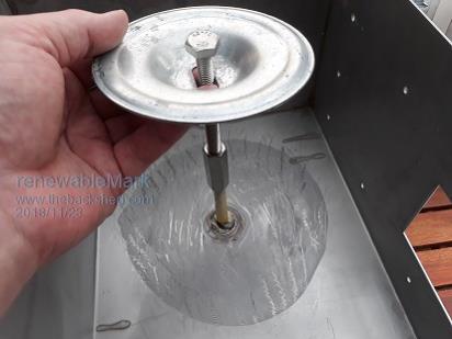

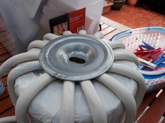

Keeping the top washer bolt as low as possible is still a bugger, but remembered the plate that holds in a spare tyre is often concave.
So went down to the wreckers and found this one that came from a late model mazda 6 wagon, don't know what other cars have this same one. Anyway it will keep the profile low and away from the lid once assembled.
Needs a rubber sheet under the washer still.

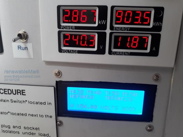

Finished the heatsinks for no 2 inverter, so basically just needs to be assembled now. All the hard bits are done, only pain in the ass thing left is winding the double 3kw aerosharp choke.
35c here today, so I left the AC going in the house. Came back to find the torroid had got to it's highest temp so far @50c, fans were winding up and down, depending on it's temp, actually that was the first time I saw them run.
3 months on,
and all ticking along nicely.

renewableMark
Joined: 09/12/2017
Posts: 1679
Posted: 10:45am 09 Dec 2018
Thanks Ralph and John,
the system has been awesome, it survived the mini heatwave we had here in Melb recently. Battery coped running the AC at night for a couple of hour stints.
I suspected the gen may be needed to top up batteries a tad with the 1000w charger, but wasn't actually needed, it would be great to have 3000-4000w charger to make running the gen worth while.
I haven't bothered doing that yet as 1000w seems like a waste of time to run a gen, and honestly the panels have coped really well even in cloudy days.
I'm still amazed how much they produce in cloudy conditions.
Currently 8750w on the roof, just put up railings today to fit another 1000w N facing. My roof is a total pain, lots of angles and triangle sections, which means way more tile hooks and inefficient use of rails etc.
Oh well sucks to be me hey?
Looking forward to see Poida's arduino based control board running with gen sync, that will eliminate the need for a bigger charger.
John, that sign is just a std solar procedure sign. I am planning to number all components with big letterbox numbers and write up a procedure list, in case I am away then the wife has some hope of handling it herself.
The second inverter is planned to be running at idle with an auto transfer switch connecting the two. Probably no need while I am around, but would like to have a backup if I'm not there, if that is implemented then the wife will not have to worry about a thing ever hopefully, even if I'm gone for a few days.Edited by renewableMark 2018-12-11

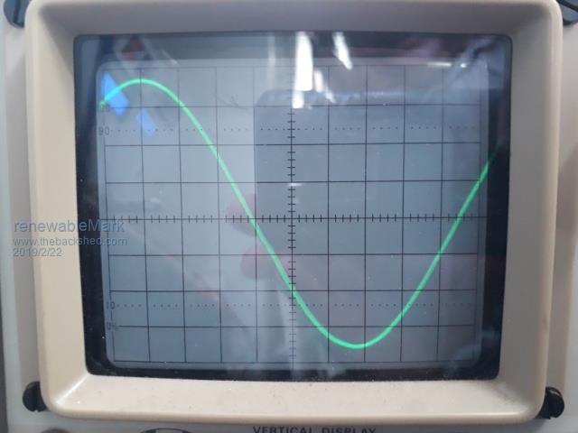

I tried the new torroid to compare, sine is about as clean as you could probably get with the metal screen between secondaries and primary winding.
Previous sine from other toroid is on p65
BTW thanks for the idea Tony, I know Tinker had some idea about using straps to do the screen, but my implementation ended up pretty easy, but it did need that sh*tty al welding material/method which is pretty fiddly.
Using copper that can be soldered easily would be the way I would do it if needed again.Edited by renewableMark 2019-02-23
