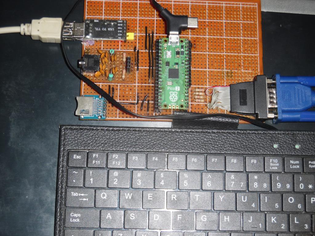

looking at vga pico and it's set higher. thinking of using it again. vga lets you input sound via 3.5 coax. hdmi don't
 Connected to COM9 at 115200
option list
PicoMiteVGA MMBasic USB RP2350A Edition V6.00.02b8
OPTION FLASH SIZE 4194304
OPTION COLOURCODE ON
OPTION KEYBOARD UK, 0, 0, 600, 150
OPTION CPUSPEED (KHz) 378000
OPTION SDCARD GP13, GP10, GP11, GP12
OPTION AUDIO GP0,GP1', ON PWM CHANNEL 0
>what's better hdmi or vga?
