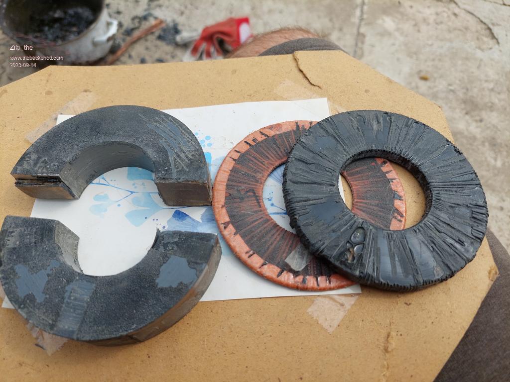

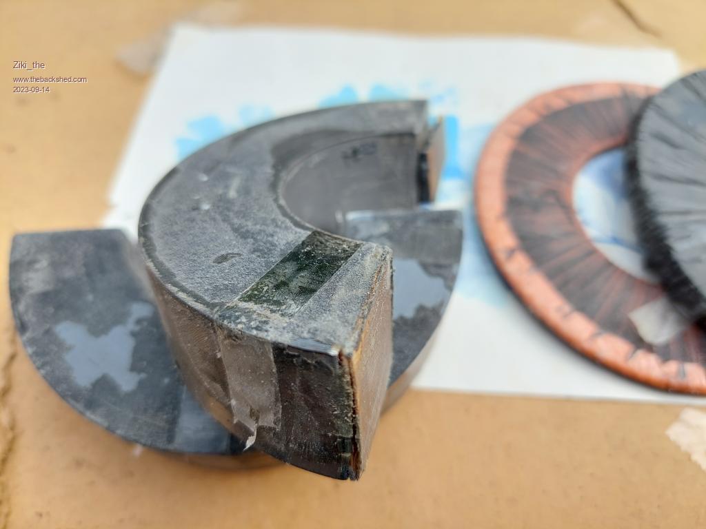

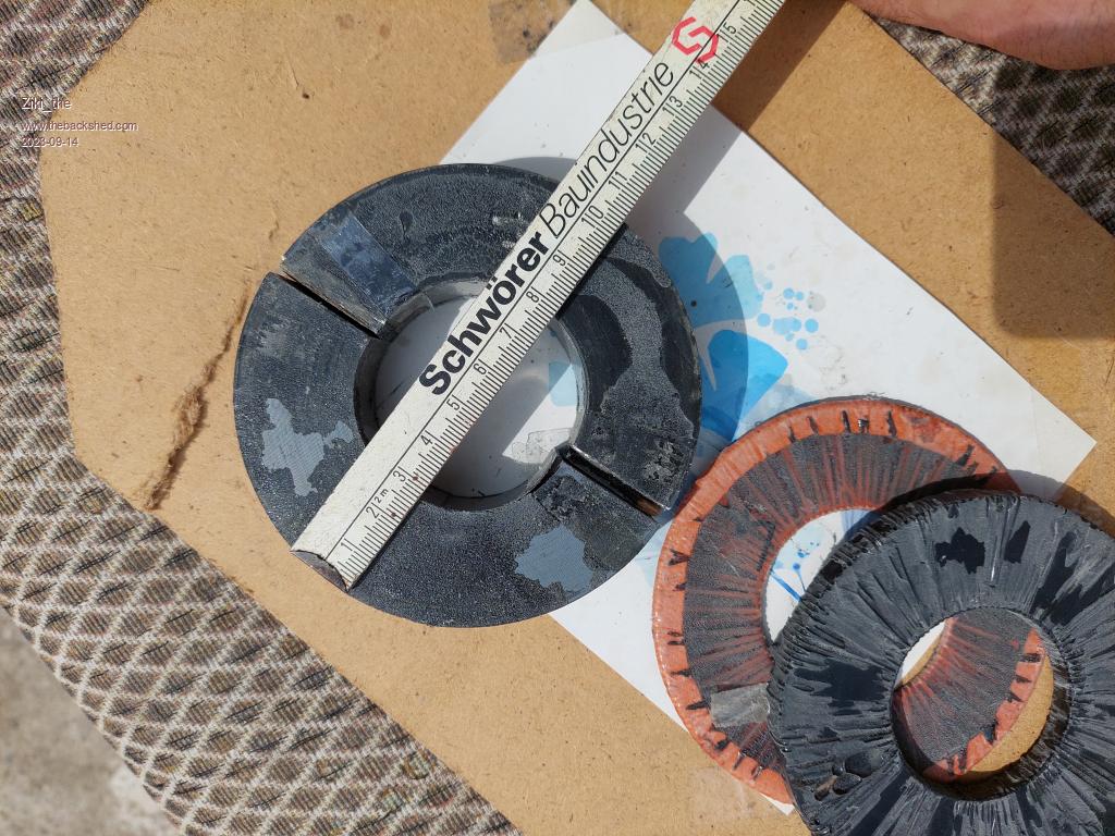

Today I played with fire, the result is extremely unusual. The original choke(epcos) was 1.4mH from the motor inverter 11KW.
An iron torus cut in half.
I will try to wound some wire and give a litle test.
Did someone stumped on something lile this?

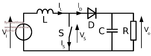

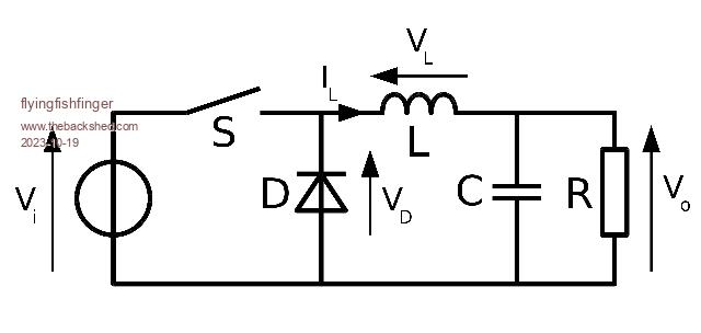

flyingfishfinger
Joined: 12/09/2020
Posts: 120
Posted: 06:52pm 18 Oct 2023
  poida said  NO idea at all if it will work in a boost situation.
It will not, with the existing hardware - a boost converter has a different circuit from a buck converter.
Buck:
Boost:
So the arrangement of the inductor vs the MOSFETS is different as is the control algorithm as already indicated..
