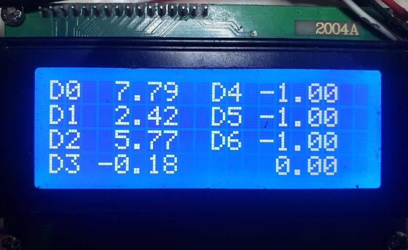

I have worked on the mppt code, to add a new function.
This new thing will record daily energy totals for 7 days, rolling over the totals
each day.
You switch LCD view from mppt to daily kW.hr totals by pulling D2 to ground.
I found little interest in the D2 override function so I removed that.
This frees up a control pin!
There is a new function in the menu that must be used to zero
the daily totals, this leaves them all = -1.00
As each day comes and goes, D1 becomes = to D0, D2 = D1 etc..
when the rollover happens.
I programmed the detection of nighttime as 1 hour of "NITE" mode
Once this is detected, the rollover is done.
There is also now a need to detect when it's daytime.
I look for 1 hour of ABSORB or MPPT or FLOAT mode (i.e. anything not NITE)
It seems to work well in testing. It is simple to change the 1 hour time limits
if needed.
I modified mpptv5_BV_tempco since that is the once I use and expect we all will use
it anyway.
When you ground D2, you see this:
The bottom right number, presently zero will probably will
show something like the total energy the mppt has sent to the battery
but it's not showing that now.

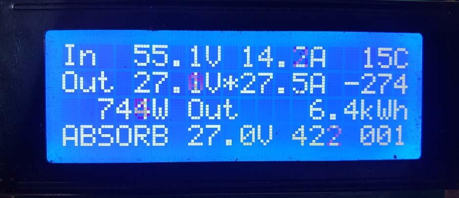

when you let D2 float to 5V, you see the usual display:
This version of course will retain all your calibration values.
