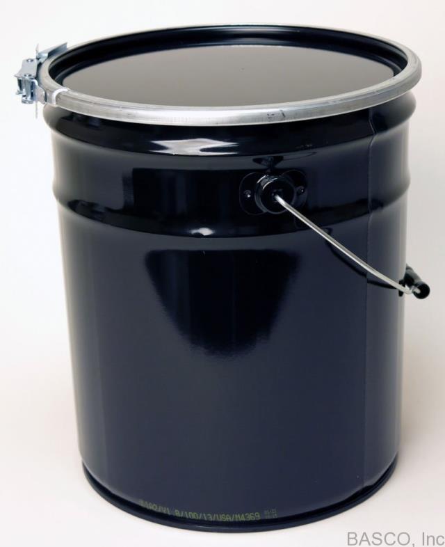

That is all for a heavy duty commercial transformer that may weigh a ton to hundreds of tons, and may need to be picked up by fork lift or a crane, and transported by truck, then sit out fully exposed to the weather for decades.
All we might really need is a fairly common five gallon steel pail.
Sit the toroid up off the bottom with some kind of spacer to allow the oil to convect freely, and just feed the wires in through the open top.
A lid would be nice, but not essential, at least to begin with.
If the whole thing turns out to be a crappy messy impractical idea, just let all the automatic transmission fluid drain off the toroid and run it dry as it was originally.
