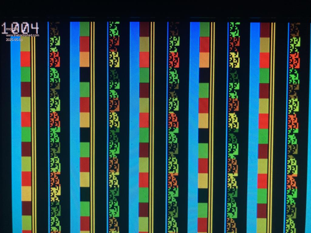

G'day,
Volhout, hopefully this will help to diagnose your Wii controller / I2C issue.
I do not have a Wii controller but a PICOmite thats pretending it is one.
Peter, not sure if you are already working on this, you did mention a possible problem with the SDK...
I think there may be a problem with the background or transfer software for the Wii I2C system. It seems the I2C return data from the Wii is working its way up through memory until it over-writes something terminal.
Please see the photo below, the "WII" is incrementing byte 2 in the return variable and it is there in the pixel data, return data is &h0A,&h40,&hXX,&h00,&hFF,&hFF
Possibly the array address is not being reset and is continuing to increment? this where it goes over my head...
This is the code running on a HDMIUSB V6.00.02rc23

This is what is on the screen, the number in the corner is seconds from Program start:
The "data" appears first, then coloured tiles, then coloured bars before it locks up (Mode 1), this was different runs. Starts at top left and works across and down.
This is fom the "Wii" PICO, it shows the lock up at approx 20mins every time.

Hopefully this provides some diagnostic information, rc20 and rc21 are same.
Thanks again for all the work you put in to this, it is much appreciated.
Lyle.

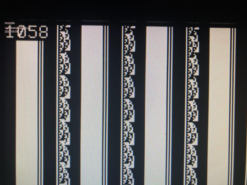

Some further experimentation has shown the minimum to get the fault to occur:
> option list
PicoMiteHDMI MMBasic RP2350A Edition V6.00.02RC23
OPTION SYSTEM I2C GP0,GP1
OPTION FLASH SIZE 4194304
OPTION RESOLUTION 720x400 @ 283200KHz
OPTION DISPLAY 33, 90
OPTION HDMI PINS  1, 3, 5, 7
OPTION RTC AUTO ENABLE
RTC must be auto enabled and must exist, screen artifacts start around 940 seconds in.
Lyle.

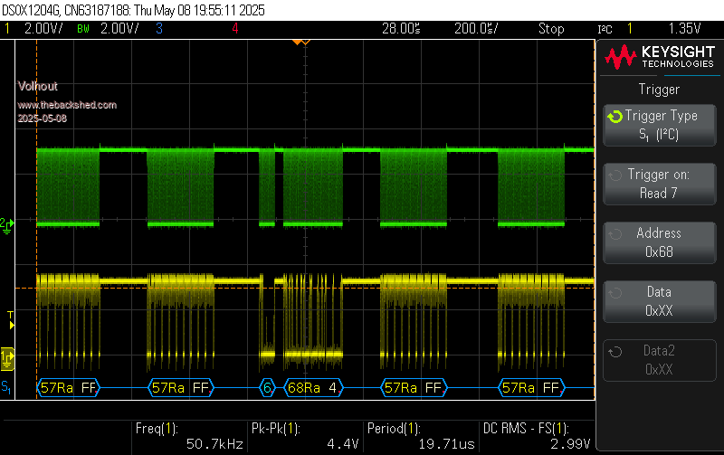

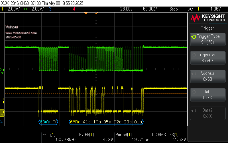

Hi Lyle,
Thanks for confirming. I have analyzed the I2C communication, and have to re-confirm that all I2C communication is sound. There is no corrupted packets, and the WII Classic response is consistent until the breakdown of the pico. I am testing on a 2040, and the problem shows after 9.2 minutes (between 9.3 and 9.1). Also with corrupted VGA screen.
I tend to agree with you that it looks like the I2C buffer is exceeding it's boundaries, and is writing into VGA screen memory, or some in between screen buffer (because in my case, 30 seconds before crash, there is a clear of the VGA screen, then the program runs fine for another 10 seconds, then corrupted data is shown on screen.)
Tonight I plan to run the program with display of mm.info(system heap) and mm.info(stack). I already know it is not heap, but I did not check system heap.
The RTC on auto mode, also accesses the same I2C bus. And I was afraid for a bus conflict. But in my testing it shows that the RTC is read after power up immediately, and then after 1 hour. But the system crashes at 9 minutes already, so I think that is not the issue here. But it could be something to verify anyway.
Edited 2025-05-08 22:12 by Volhout

Posts: 6253
Posted: 12:27pm 08 May 2025
Hi Lyle,
This is on a unit that does not have WII Classic connected.
I used a small program to read the EEPROM on the RTC board, fast enough so there is not enough time to squeeze a AUTO RTC update in between the gap. Just to verify if RTC read would corrupt the constant data transfer to the EEPROM. I had to wait for 1 hour, but then the (AUTO) RTC read happened.
The RCT command is simply embedded in the constant stream of I2C reads, and the details show that no corruption of the transfer takes place. That is good. MMBasic I2C transfer and RTC updates do not corrupt each other.
That does not give any guarantee for the timed interupt driven WII Classic polling, but this shows the AUTO RTC implementation is sound.
Edited 2025-05-08 23:32 by Volhout
mozzie
Joined: 15/06/2020
Posts: 505
Posted: 01:40pm 08 May 2025
G'day,
Volhout, a good scope is worth its weight in gold, and with auto-decode double its weight in gold. Everything there looking good
Peter, happy to report the update to HDMI060002rc23 has now been running for 1.2hrs and no signs of trouble, it would reliably fail around 940 secs so I think that squashed it
Thanks again.
Lyle.

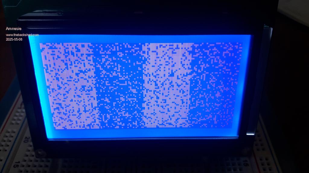

Found another bug / problem:
ST7920 does not work (tried two displays, double checked wiring) If I list the options the display isn't listed at all, which is strange. Yes I tried it multiple times with OPTION RESET.
I used the exact same config as Peter in this thread:
https://www.thebackshed.com/forum/ViewTopic.php?FID=16&TID=17096
This version is tested and working. I think the garbage was because I was clocking the SPI bus too fast.
Connections as tested
GND - 1,15,20
5V - 2,19
GP0 - 4 (RS)
GP1 - 17 (RST)
GP6 - 6 (E)
GP7 - 5 (R/W)
Greetings

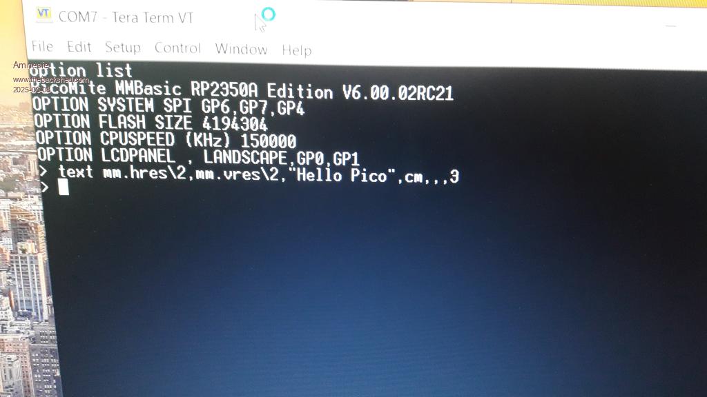

Posted: 02:09pm 08 May 2025
On the ST7920 problem I can confirm it is a bug / error in the firmware, because I tested the firmware Peter posted on the above linked thread, which is for the Pico 1. And everything works on this (old!) version. So I think he broke something on the newer iterations...
Greetings
Daniel
Posts: 12176
Posted: 02:23pm 08 May 2025
clear flash and then install rc23 - then report
Amnesie
Joined: 30/06/2020
Posts: 763
Posted: 02:40pm 08 May 2025
Yes that works now! Only problem: with the old RP2040 version it was possible to EDIT with font 8 (OPTION LCDPANEL CONSOLE).. now with the RP2350 RC23 it isn't possible anymore:
PicoMite MMBasic RP2350A Edition V6.00.02RC23
OPTION SYSTEM SPI GP6,GP7,GP4
OPTION CPUSPEED (KHz) 150000
OPTION LCDPANEL CONSOLE 8,,,,NOSCROLL
OPTION DISPLAY 10, 32
OPTION LCDPANEL ST7920, LANDSCAPE,GP0,GP1
OPTION DEFAULT FONT 8, 1
> edit
Error : Font is too large
Greetings
Daniel

Posts: 12176
Posted: 07:01pm 08 May 2025
  Quote  I assume it was a memory leak after all, right ..?
No, it was the RTC leaving a parameter set which should have been nulled
Amnesie
Joined: 30/06/2020
Posts: 763
Posted: 07:27pm 08 May 2025
Hmm, no matter what I am trying, I can't get the ST7920 work with the smallest font in the EDITOR, the interpreter always says:
> edit
With the RP2040 and the old version 5.09.00 it worked fine. Is there something I am missing? Of course this is really small, since the display is only 128x64 but for my application it is enough to edit things on the go... And it worked in the old version. Maybe I am to stupid or there is new syntax?
The problem is also that it now is impossible to EDIT the program when
is active.
Greetings
Daniel
