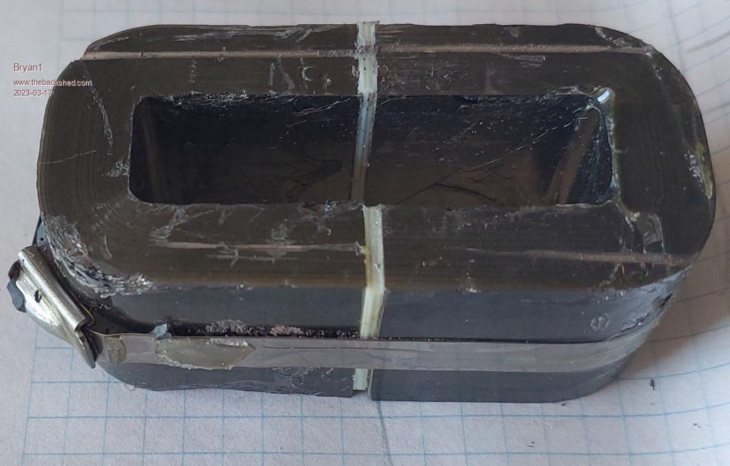

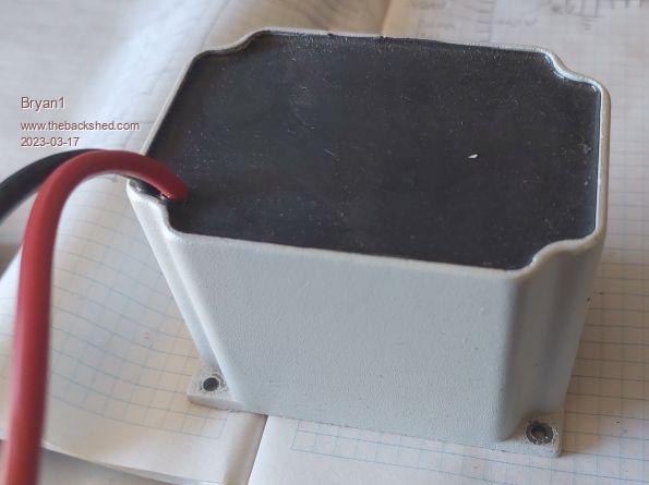

Found 3 of these in that old grid tie inverter and there was a bit of weight in them so I just had to take what ever was in there out for a look
75x35x30mm with a 14x53mm slot and that important gap builtin for the core, I do think by stripping another one I can put it side by side to make a e-core or would just placing it inline to get more thickness would be best?

  wiseguy said  Hi Bryan, how easy was that potting compound to remove ? Hpprox how many turns and what gauge wire was used for their winding. I have a few of these and was going to strip one down to see what was inside too.
In order to get out I just used my leather knife and cut down every side then just used a couple of screwdrivers to raise it up. The first one took a bit of time but the next 2 were done in half the time so now I have 3 of those cores.
I just used my angle grinder to cut on the side of the core which was 1mm wire and I didn't bother counting the turns. Then I used my pliers to get the wire out where I netted close to 1.4 kg's of copper wire.
I do have some 7x5mm enameled copper which is the same wire they use in 3 phase mig welders and off reading 11 turns was the go so no problems fitting that in the slot.

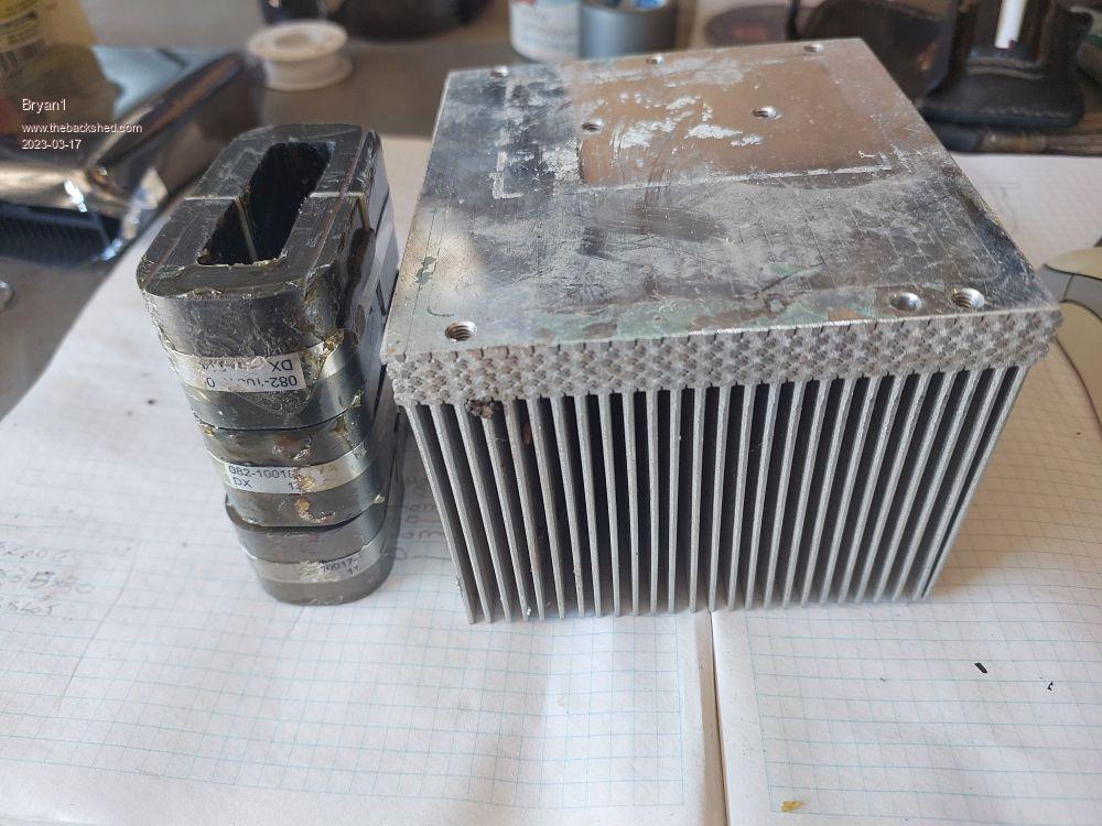

Now as I'm going to need a heatsink for the fets I found this
To use and I reckon it should do a good job of keeping those fets cool

Bryan, I did a post way back how to make a decent choke with two sets of the cores you show.
Its better to fit two of them side by side (rather than on top) as that gives a much larger radius for the coil which is then easier to wind with thick wire.
7 x 5 mm copper (35mm sq) would be good for a conservative 140 Amps, good find.

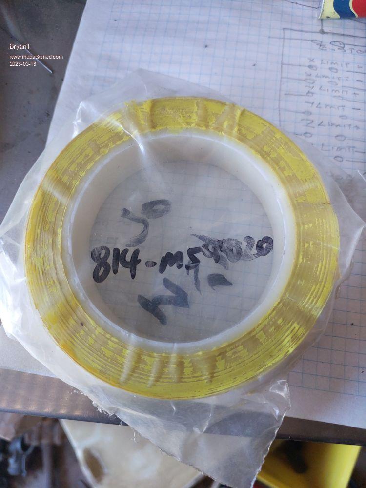

           Well as it does look like these cores can be used for a choke I do have to say I do have a box from long ago with that yellow winding tape that isn't sticky so in the morning I will do a count of the rolls so I can offer some members with a roll or 2 of it.
When we rewind these found parts isolation is the key and this tape will do it so if it can help out I'm happy to go ahead with this.

            Finally got some time arvo and did a count on that tape and the 20mm wide I have 20 rolls of so i am happy to give away 10 rolls to members. I got this tape about 15 years ago when i was repairing industrial gearbox's and a sister company moved in and this tape was thrown in the bin saying it was past the use by date. The start of the roll I opened did separate and a turn of 2 later it became good so i reckon this tape is still good to use.

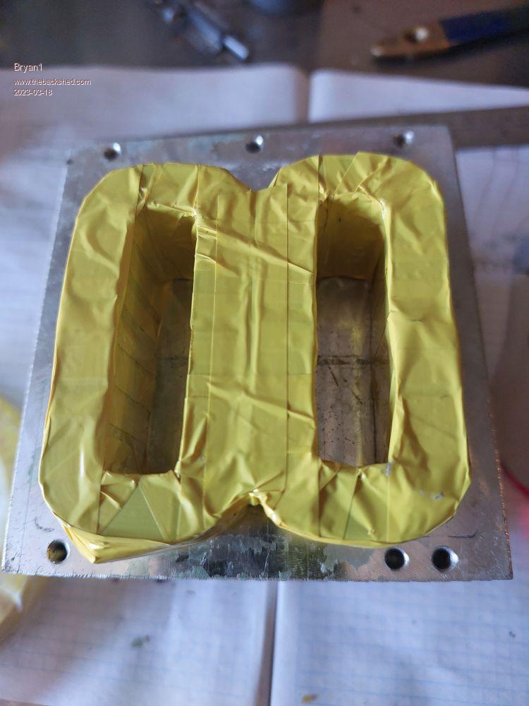

Using some of the 14mm tape I have here I wrapped up 2 of those cores and taped them back to back as Murphy's friend suggested.
That copper wire I have is in fact 6x4mm so 24sq.mm and with the height of 14mm I should be able to squeeze the wire thru for 11 turns.

            Well the choke is wound
got 10.5 turns using new 6x3mm enameled wire and I do have another length so I can do a join and solder it so I can get those few more turns if needed.

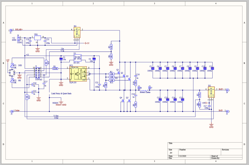

Hey Pete, can I please have a updated schematic if you have one??
Thank you in advance...

  noneyabussiness said  Hey Pete, can I please have a updated schematic if you have one??
which one? I am guessing the mppt.

here is the mppt schem
