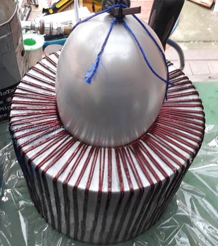

Epoxied the inner this morning, this is where you really need to save as much space as possible and not waste it. So decided to try a pumped up baloon to keep the wires pressed up against the inner wall while the epoxy dries.
There are two baloons there, one got slid into another so there is a double wall there, might help, dunno, worth a try.

Very professional job,Mark.
I like following your building .. Q, what is this one for ,just a spare or are you building them for sale?

Thanks Bruce, at least it does show the average mug off the street can do it.
This one is a backup, the toroids are getting a bit scarce these days, if you ever see the 3kw one snap them up while you can.

Good idea Mark, I used a piece of PVC pipe with cloth wrapped around it and inserted in the hole to do the same, but I like your idea better.
I have a Toroid sitting on the bench at home at the same stage, been over 2 months since I touched it. I might have to get my finger out and see who finishes first.

...The opposite of vacuum bagging. Very creative.

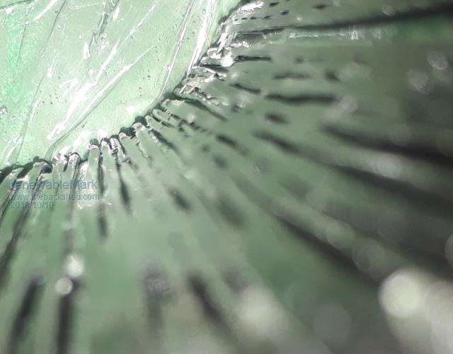

Thanks guys, well it did work, very hard to see from pics but you can see with the eye and feel that there is a defined flat surface and there are no loose wires flopping about.
Certainly will be doing that again with the next 3 layers.
Edit, Forgot to say the epoxy kind of eats away at the balloon, so definitely use two or even three balloons slid inside one another. When they got removed the outer one had got messed up and stuck to the core a bit, but the inner was as new and slid out fine.Edited by renewableMark 2018-10-11

Mark, that is very creative and original.
My experience is that epoxy doesn't stick to oven bags Maybe line the inside of the toroid winding wall with it.

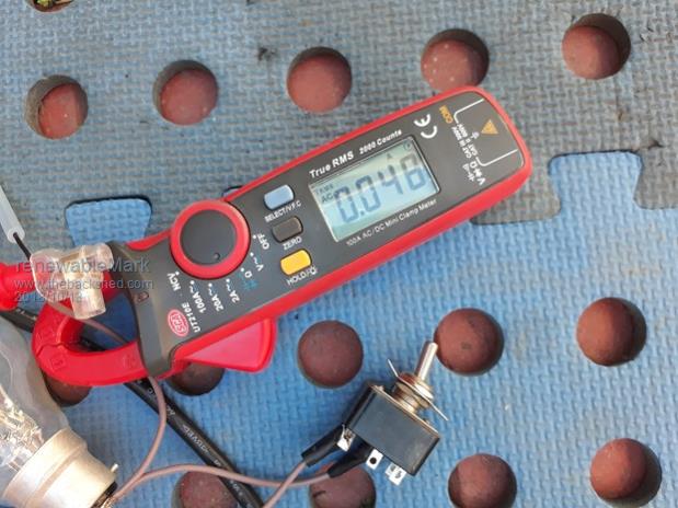

Finished the second layer of secondary winding.
The two loose ends were 0.025v between them, last torroid was 0.1v between them.
Did the phase and volt test, that was all fine same volts, BUT, when I clamp tested the active line (with bulb shorted)
This torroid had 0.048A compared to the last one 0.067A, that's quite a difference, would that be down to the fluctuations in the torroid material?
It did look like these ones were from a different supplier.
So this one is 11W and the previous one 16W, that's quite different.

Thanks Warp, so it's due to the cores itself yeah?
Don't get why the loose ends differ?Edited by renewableMark 2018-10-14

The steel does vary from batch to batch and from different suppliers, that is to be expected, and the differences can be quite significant. It only really effects the zero load idling current, flat out at full power it won't make as much difference.
The voltages induced in each turn "should" be identical but there will always be some sneaky magnetic lines of flux that take short cuts through the air instead of going only through the steel core. The difference in voltage will be very small, much less than the voltage of one complete full turn, and is quite normal and nothing to worry about.
