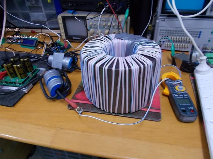

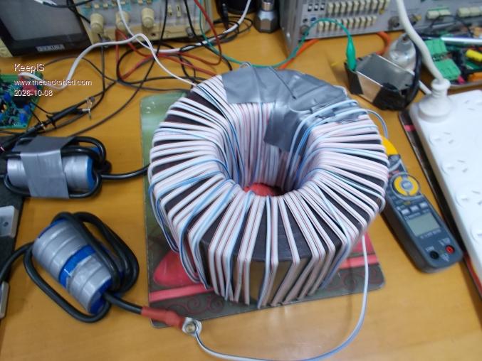

At Last I had a chance to wind the China toroid core with a 130 turn secondary and a 15 turn primary, some quick ac testing for mag current, same as we have all done in the past, so the comparison is valid with the 3 stack toroid of similar cross sectional value.
The power values were within meter error of each other from 225Vac out to 280Vac, that's as high as I tested the 3 stack toroids too.
In these new cores, I tested out to 320Vac, the power was still increasing in linear steps from 220v to 320Vac with no sudden jumps in current. This core is wound very close to one Tesla.
I fitted the toroid to the Test Power board (38,000uF caps) and controller, it ran fine, the small single toroid had an idle current of 19.3 watts, this huge core idled at 24.2 watts.
I found a 15 turn primary had an idle SPWM of 72%, so I added a turn, with 16 turns the idle SPWM went up to 79%, a much better figure, and 16 turns bought the turns ratio from 8.6:1 back close to 8:1, that extra turn also reduced primary reactive current by 200mA.
As I'm using a single thick copper wire for the 130 turn secondary, I plan on winding it as two 65 turn winding's connected in series.
Although the test winding's are only rated for a few amperes, I dumped a 600 watt load onto it and the controller regulated it and ran fine, all wave forms were correct and stable.
It will be interesting to see if there is Idle hum with the correct heavy winding's, as it was absolutely dead silent in all testing with the small test wiring.

The new toroid was test wound for 1T and has absolutely zero hum, even when suddenly stepping the DC input up/down in 1, 5, or 10 volt increments, which caused the other 2.5kW test toroid to hum noticeably, the new toroid is completely and utterly silent.
A caveat though, the test secondary is wound with 2 ampere cable, a 16 turn primary is 3A cable, I have no idea if that has an effect on the hum in the Core running at idle, phil99 or wiseguy might be able to answer that one accurately, as it will be a few weeks before I can confirm this after the toroid is wound correctly for full power load testing.
Could this be another reason why some inverter builds have less or no hum at idle, and others have a noticeable hum, I'm obviously not talking about higher power unbalanced load growl from the Toroid Core.

  Quote  Could this be another reason why some inverter builds have less or no hum at idle
Quite possibly. The reactance of an inductor at 0Hz (DC) is 0Ω so the primary circuit impedance to a DC offset voltage is just the resistance of the whole primary circuit. A very small DC voltage across a very small resistance could produce a significant current.
Adding even 1/10 Ω might reduce it significantly.
