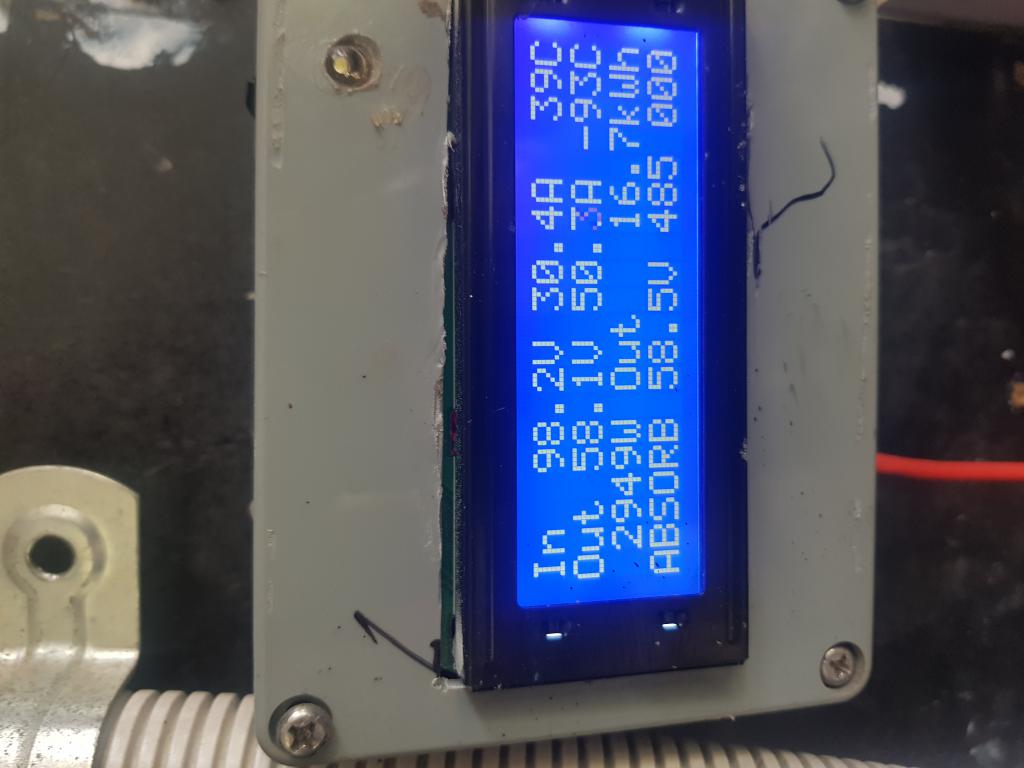

thank you, I did calibrate it originally hooked up to bench supply... but going of the values I was getting this morning, ether the current sensors I have installed are inaccurate or ( most likely) I've stuffed up the calibration, output current was higher than input via wattage on screen... Ill let it run for a bit and bench it again to calibrate it..
but on a positive note,  by the lcd it was delivering about 2.6kw for about half an hour at its peak ( around 2.2 - 2.4 constantly), done 11kwh today so far...and inductor was warm, I could hold it, and mosfets were barely warm (41°c - 42c max by the sensor) ... attached is a pic from earlier ( around 11am) .. by the amout of panels connected thats about right too..
I think it works !!

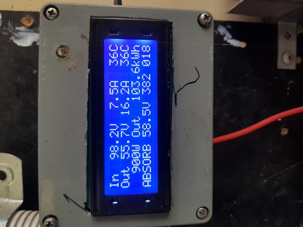

this is a soak test of components,  I'm going to box it up and calibrate it better .. but so far really happy, it is replacing a cheap mppt controller that went to silicone heaven... but this one is HEAPS better so far, runs much cooler and no noise...
I think it works !!

I calibrate it when running using a DMM.
connect using the serial port, get the menu..
check Vin, cal Vin using DMM reading.
check Vout, cal Vout using DMM reading.
Now, to get a good calibration for the current sensors I use a cheapie
UNI-T device such as UT-203 which has a DC current feature, 0-40 Amps
using it's clamp thingie.
I always zero it when I hold it in the nearly identical position where I will
measure the current. Then I put the clamp over the positive lead and see what I see.
Tell the firmware the reading.
I think if we get +/- 5% accuracy then we are going well for current readings.

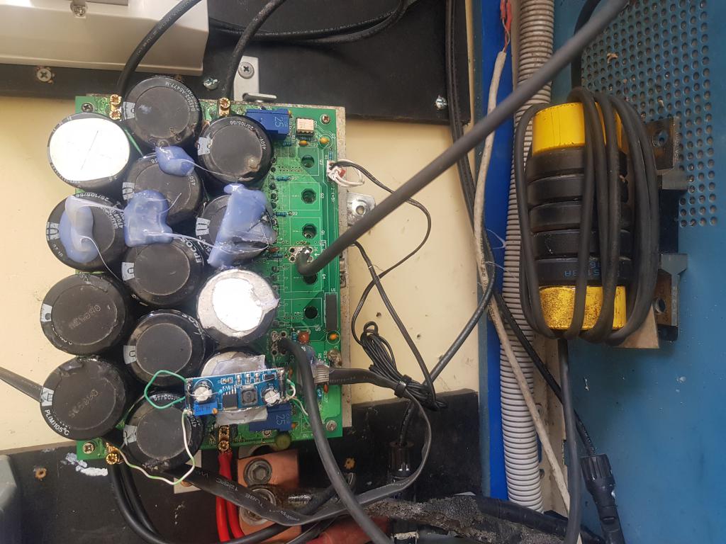

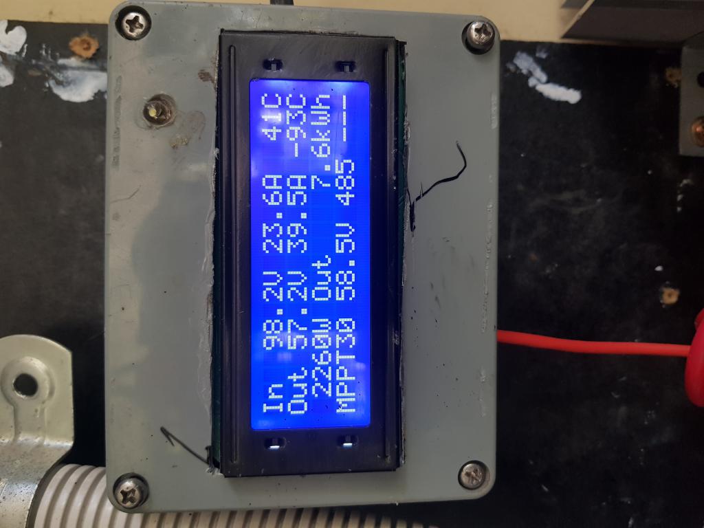

Here's a pic of the actual unit, the inductor is wound with 11 turns of 4mm solar wire( had some spare) the cores were salvage .. reads 120uh on my cheapy meter...
decided to max it out , pushed 3.1kw for quite some time but hovered around this most of the time as batteries were getting full.. again, inductor was the " hottest " , warm but could hold it.. mosfets were barely warm,  temp sensor on unit read between 40-42 ...no fans on it, but i do have 2 cheapy pedestal fans oscillating on general area,  used mainly for the OGI's ..

Hmmmm, 50.3A through 4mm sq solar cable and it does not get hot? Are you kidding me, surely that does not sound right.

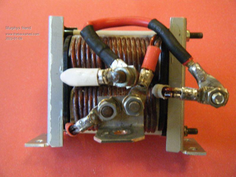

I think it's time I'll introduce you to a decent choke. Salvaged from an Aerosharp inverter you get at least that many turns but with 2.5 times (10mm sq) wire area. The existing coils are wired in parallel:

oh yeah, THIS is what we are talking about.
The entire project was to my mind seeing what junk we have lying around that we could use to replace $1,300 units.
The inductance is not the only thing that is important, you need to also know if it is saturating at the working conditions you are employing.
I am lucky to have a good DSO and current sensors so I can prove the choke is not saturating in use.
3kW and 120uH seems "about right" but if it's getting hot and the efficiency is not that great (maybe lees than 90%) then maybe the choke is saturating.
For a small cost of switching losses, you can halve the work load of the inductor.
Just move to 40KHz PWM from the menu.
Maybe you will see less heat in the choke and a tiny more on the heatsink..
From the numbers above I see
98.2 x 30.4 = 2985 Watts input
and
58.1 x 50.3 = 2922 Watts output.
efficiency of the DC-DC conversion is 98% and that is fantastic.

it is !! this was a soak test , I'm winding up a more " appropriate " inductor at the moment  but you did a great job poida !!  aiming for about 200uh with little to no heat / saturation using proper magnet wire. the mosfets are out of the DC side of those eltek PS ( 150v rated), Ill get some numbers tomorrow   .. I don't have the tools you do, but I figure if everything runs reasonably cool ( not " cold " but warm) I figure it must be right ... now comes the fun !!
considering the power going through it( I know the current measurements are probably out, but not by a huge amount, its still in the ballpark) and the fact that it doesn't even have forced cooling.. just " residual " from pedestal fans is a real show on its capabilities..like you said, using MUCH cheaper components ( a lot of mine are salvaged), replacing 1300 buck devices... AWESOME!!

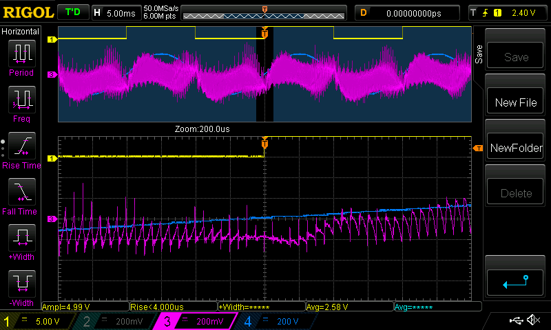

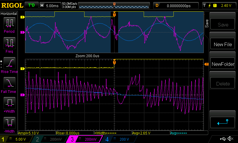

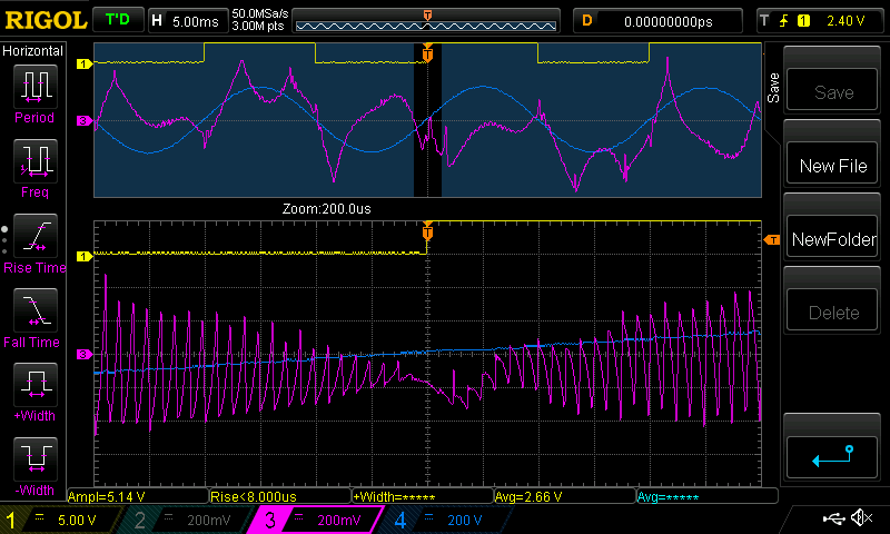

Wiseguy, I have tested the perfect symmetrical output today.
First I had to alter the test inverter to make it give a bit of noise.
Changed the 100uH choke to a 22 uH with no change to the cap.
Now the 1.5kW toroid makes a nice amount of noise at idle.
The original firmware, that has the few pulses in the wrong places
uses 0.34 A at idle with a 51.4V supply
Running the new firmware, there is no noise and the same idle current.
AS usual, the DSO is educational.
Yellow is 50 Hz sync pulse
Dark Blue is AC output voltage
Purple is primary winding current. (about 1 Amp/div)
Old firmware:
The new code with nice symmetrical pulse train:
First, I average 4 triggered captures to reduce noise so the top current traces
look weird. Second, I triggered on different zero crossing for the 2 versions
of code. One when rising, one when falling. It does not matter.
The key thing to see here is to compare the two bottom traces of the current.
In the center is the zero voltage crossing and we can see with the old code
a bump of current is produced right after zero volts.
With the symmetrical code, there is no bump.
I think this means it's as good as it can get.
IF you look closely, using your good eye, I think we can see
evidence of oscillation excited by the bump of current that is
injected at zero crossing. I see the first, large bump, then I see it
faintly echoed afterwards. The period is about 2 divisions so that's
400uS. This is a frequency of 2,500 Hz and we all should be able to hear that.
This is quickly damped though, so we hear it started up for a few cycles
each time the voltage crosses zero.

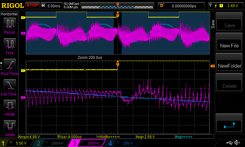

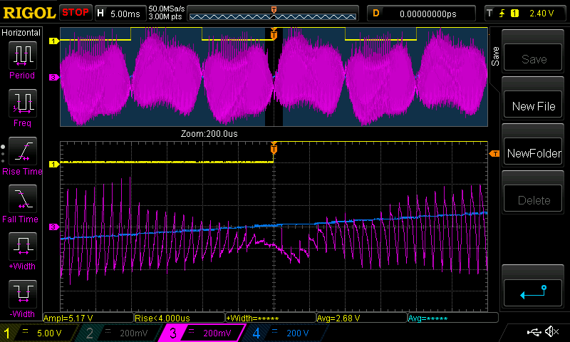

Here is the symmetrical code, without trace averaging, to show what the
primary current is really doing during the 50Hz waveform.
I do not like potentially misleading people.
I replaced the 100uH choke, to see if it's the same.
It's the same, but with 1/4 of the current so the Purple trace is 1/4
the height.
old code:
new code:
When running with the new code and the 100uH choke, the torid
is silent. This is very dangerous for me since there is no audible warning
the inverter is running. It's so quiet now...

  Murphy's friend said  Hmmmm, 50.3A through 4mm sq solar cable and it does not get hot? Are you kidding me, surely that does not sound right.
Hello
I just wondering if you have an image of the other side of the choke. Trying to work out how they are wired and then connected.
I am about to make my second MPPT and I might see if I can use this style. I have rewired the core from the same choke and the choke is a pain to unwind.

  andymc70 said
Hello
Andy
Other side?? Just wires there, no connections.
Your eagle eyes might note that I have unwound the original wire, straightened it (quite a job) and then re wound two in hand to double the current @ half the number of turns per coil.
Both windings are identical and were connected in parallel as the picture shows.

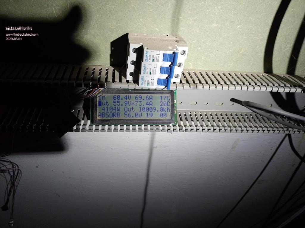

I missed the magical moment today, but my unit hit the 10MWh mark!
( btw. I don't recommend running the unit that high in power, mine is maximum active cooled)
