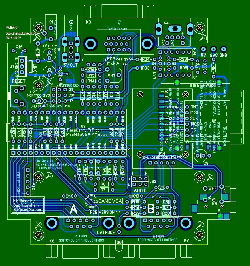

Both my systems (VGA design 2 with WII connected to GP14/GP15, and PicoGameMite with WII connected to GP26/GP27) show exactly same behaviour. After some 10 minutes the screen corrupts as in earlier sent photo.
This is the whole program
WII CLASSIC OPEN
DO
PRINT ".";
PAUSE 100
LOOP
According your photo you have a RCT connected. Is the RTC configured AUTO ON ?
Maybe a collision of WII and RCT commands ?
Edited 2025-05-07 04:00 by Volhout

Posts: 6253
Posted: 06:56pm 06 May 2025
Hi Kevin,
When no WII Classic found MMBasic gives an error. So no error means it sees the WII controller.
I did not test with a LCD display. I would be surprized if it would show the same. It feels to me like a memory leak, since the behaviour is different depending the size of the program, and the resources used (sound/no sound etc..). Since standard pico (non VGA) has significantly more free memory, if it is a memory leak, you may have to wait 1 hour before it happens. And how it shows on the LCD is not clear to me..
Thanks for your effort.

Posts: 6253
Posted: 08:29pm 06 May 2025
Hi Kevin,Picogame
This is a VGA game platform similar to Peters VGA referenda design, but with connectors for controllers.
With your result It feels like I am wrong. But I cant ignore what I see on 2 different units showing the same phenonem, and rc20, and rc22, and the intermediate release Peter did. So It is not a bad download. And I did clean the flash each time.

Posts: 6253
Posted: 08:48pm 06 May 2025
@Kevin,
This is the PicoGameVGA
Bleep
