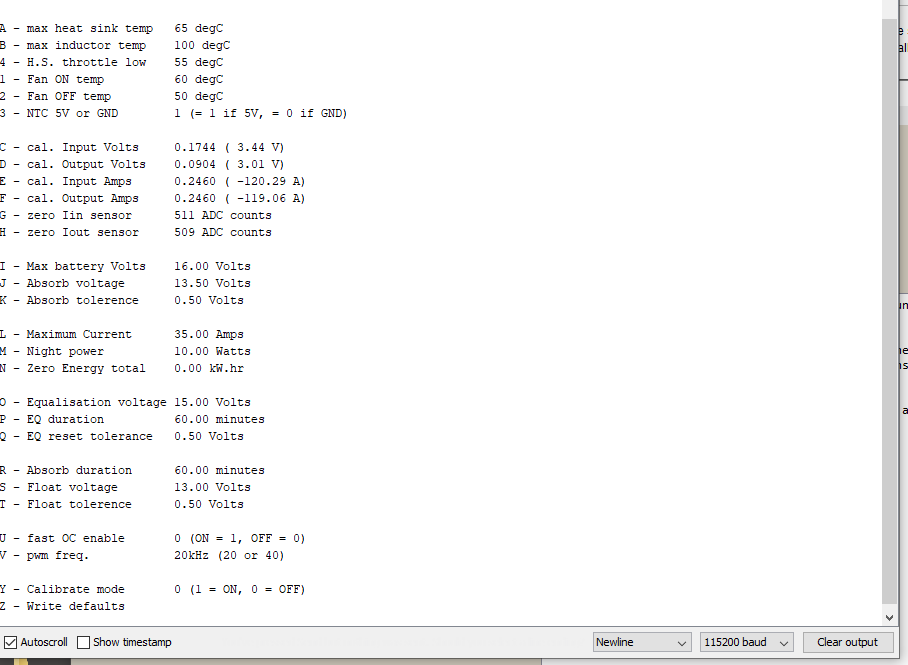

this version of mppt code uses 115200 baud to communicate via nano serial port
I use 9600 and 115200 interchangeably or on a whim
So to see what speed the mpptv5_highside_NTC code needs
I first try to connect using 9600. no response means
maybe it's 115200
As always, you need to send a newline to terminate all commands sent to the nano.

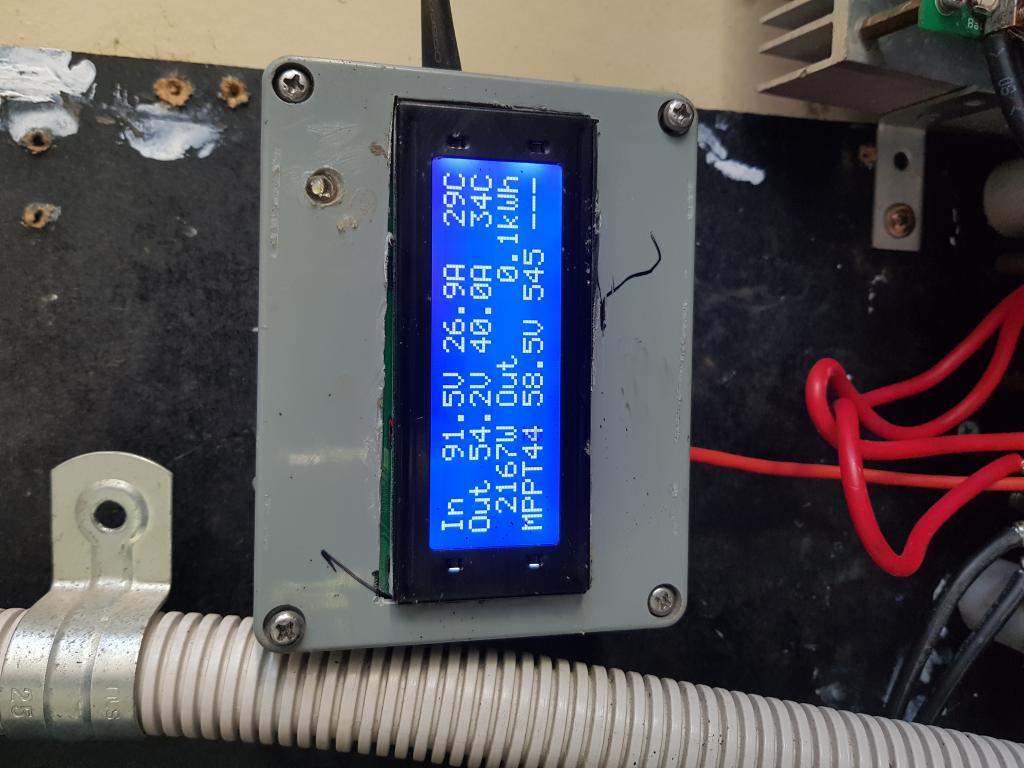

and we have liftoff !!
was at the end of the day, and choke was to small .. but its a start..
I think it works !!
poida
Joined: 02/02/2017
Posts: 1507
Posted: 10:44am 07 Jan 2023
let's see the conversion efficiency:
assuming the volts and amps are calibrated to something close enough
for jazz..
IN: 91.5V x 26.9 Amps = 2460 Watts
OUT: 54.2V x 40.0 Amps = 2168 Watts
conversion efficiency = 2168 / 2460 = 88%
which is pretty good given the voltage difference.
When going from 91.5V to 54.1 V that is nearly a 1/2 drop and there
are some losses in this design that get big when the Vin:Vout ratio is large.
This is looking good.
I find with my two arrays, I run them at lower voltage ratios
when under large power loads. More like 75V to 50V and so the efficiency
is a bit better, more like 92%.
I designed the arrays to have max power voltages of about 75-80V.
Open circuit voltages are of the order of 95V.
Since there is a lot of conversion loss, I would be watching the heatsink temperature
and also the choke's temp. That is where all the losses go.
But anyway, it's greatly satisfying to see another mppt running.

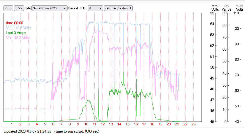

here is today's data for the North facing array.
There is also an array that faces East and it contributes a good lot of energy
in the morning too.
There are two Volts scales. One is the battery. The other is the solar panel array's
voltage. That is why the scales are different.
Vout is battery voltage
Vin is array voltage or mppt input voltage
Iout is mppt controller's output current
9am to 11am it's in MPPT mode, getting as much as it can from the array.
The conversion voltage ratio is ranging from 54V (in) to 72V (in) into the battery that was from 51V to 54V.
Then the max battery voltage was achieved and so there is now no need
for lots of power. This means the panel voltage WILL RISE due to the conversion
needing only a fraction of maximum power. So the panel voltages rise to near open circuit from 11am to 12pm (when my other array kicks in and does the heavy lifting)
and after 12:30pm the North facing array takes over and keeps the battery
at it's bulk charge set point all day.
For the period from 12:30pm to stumps, this array provided all that was needed
and could do it using only a fraction of what was available.
So that is why the array voltage was mid point, around 85V, making about 20-25 Amps.
I know that this array is good for about 3000W but that is not needed in this case
with the battery's state of charge and the system's power load (the pool pump was on all day, pulling about 1kW)
I like these mppt controllers. They get most efficient when the battery needs the most energy (i.e. early in the day there will be low Vin:Vout ratio)
and then they look after the battery once it gets to absorb mode.

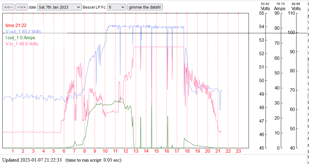

here is the data for the East facing array:
with these 2 arrays you can see I have more than enough power available
when the sun is out. I live in Melbourne and so that means the sun is not often
out and not much there when he is "out" during 1/2 of the year. Today was a good day.
The East facing array was simply not used at all from 1pm to 5:30pm
since the other array + controller already had the battery at absorb voltage by its self.
Once it got a bit closer to sunset, then both arrays started to work to keep the battery voltage up, as best they could. But soon there was not enough sun and they both signed off for the day.

most of that loss was in the inductor, as it was getting stinking hot, mosfets were cold. I've already wound a much better one with way less turns and much thicker wire ( my cheapy tester says 120uh)... will be able to test it better tomorrow if sun out( weather man says yes, but who can trust em).. but so far so good...
Re voltage, there is a significant distance to panels, and using 6mm cable I kept the voltage a little higher to keep the losses in it lower.. ( i can deal with heat where it is, easier)
If I can sort this properly( don't see why not but I never count my proverbial chickens) , I might be hitting you up for another couple of boards if you have any spare??
Thank you again for your help with this Pete ...

oh and was going to ask, what is the " 545 " and the dashes in the corner mean ?? probably been answered before but can't find it in the last 40 odd pages ...
I think it works !!
poida
Joined: 02/02/2017
Posts: 1507
Posted: 10:48pm 07 Jan 2023
the "545" in bottom right of the LCD is the PWM width used at that time.
The units are clock cycles, and the max PWM width is 795
With a 20kHz PWM frequency and 16 MHz clock, there is 800 cycles available
for each PWM pulse. We control the width by having the pulse ON for some number
of cycles.
The voltage ratio (Volts Input to Volts Output) is tied very closely to
the PWM width.
In the photo, you have 545 which is 545/800 pulse with or
0.681
The LCD shows Vin = 91.5 and Vout = 54.2
54.2 / 91.5 = 0.592
This is close enough and it suggests there are losses large enough to look at reducing them or maybe the Volts calibration is a bit off.

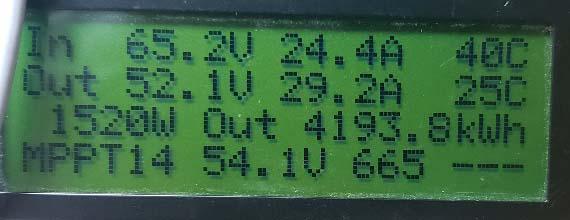

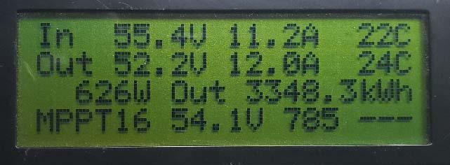

here are my 2 from today at 9:45am :
East facing array
North array
Finally, the "---" is where it shows how long it has been in either float,absorb or equalisation mode. If it's in mppt mode (i.e. battery voltage not up high enough)
then it shows "---"
The number is minutes.
