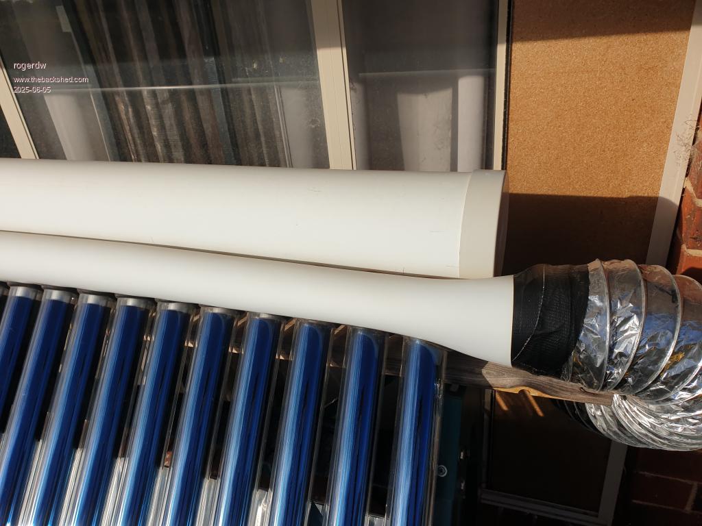

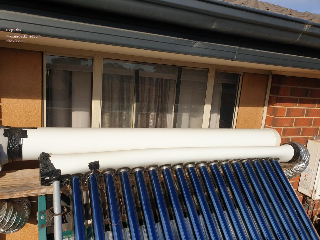

My plan with the original was to transfer it to the workshop. Just hang it vertically on the wall and cut a 6" hole either end for 90 degree elbows. I had started to think that with all this solar I'd just use a reverse cycle aircon  ...  but with just 43 watts for the original airheater fan  ...  and the fact it runs as soon as the sun shows up  ...  often at 7.30 am  ...  I have to try it there as well.
Of course I have to rebuild it because it is fairly badly distorted. I can't remember who it was (haha) but someone suggested I run it on a hot day to see what sort of heat it would put out  ...  and of course being pretty gullible I decided to give it a try.
One hot day I ran it for a minute or so and was surprised that it wasn't any hotter than I'd seen before  ...  so a bit of an anticlimax. Anyway a few weeks later I walked past and noticed the endcap off the hot mainfold was lying on the ground. Once I looked at it, the tube had collapsed by a couple inches from just that minute or so of heat and with the cap popped off was just pumping outside air into the room.
I thought it was stuffed, but when the cool season turned up, I just taped it up and kept it going. Not too much later, from the pressure of everything being out of alighnment, one of the tubes broke  ...  but with my excellent taping skills, I had it bypassed in no time.
The lower pipe used to be the same shape as the top one.

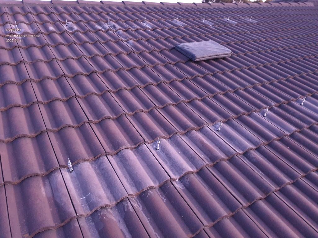

The whole assembly is 4 mtr x 2.4 mtr  ...  and so it will straddle 8 rafters.

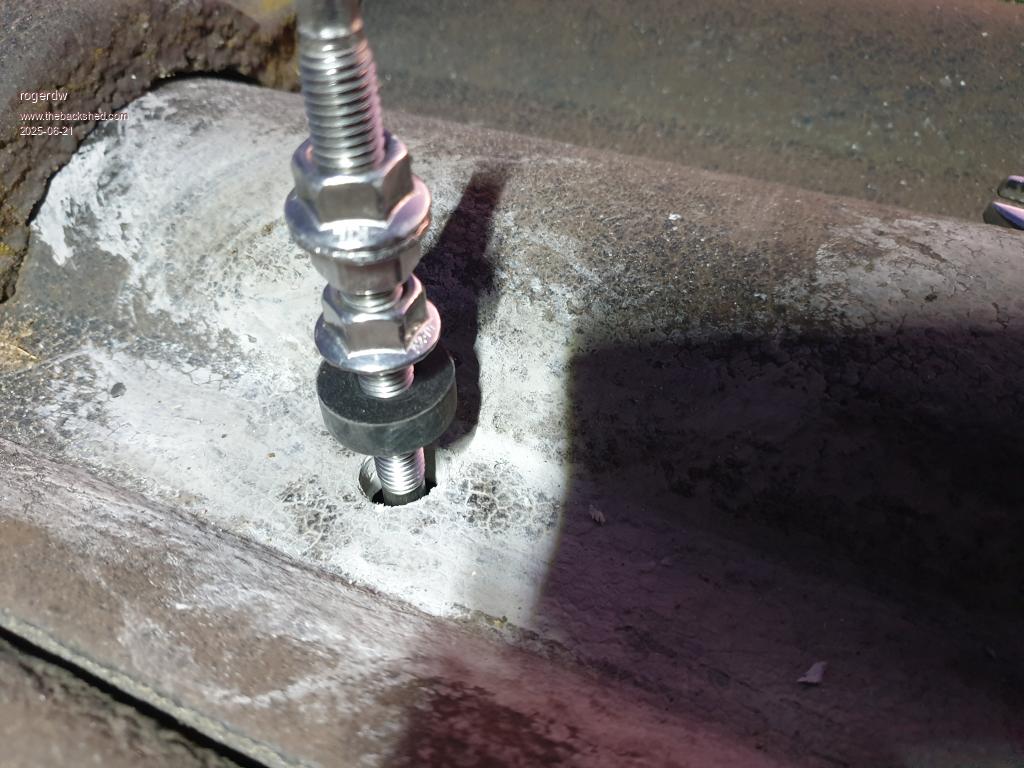

I bought some 200mm x 10mm stainless steel anchor bolts which have a coach screw thread at one end and metal thread at the other  ...  with a rubber grommet in the middle to seal where they come through the tiles.
I bought a batch of 5 diamond encrusted 16mm bits to drill through the tiles  ...  ~$20 from aliexpress  ...  as against ~$60 for one from Bunnings. I practised on a spare tile and was amazed at how efficient it all was. Certainly worked better by consistently spraying with water to lube and cool.
I was on my third bit by the time I finished the 16 holes, so very relieved I bought the five.
The corner bolts are not meant to be aligned with the side ones.
The next items on my shopping list are a couple of 250mm Dektites for where the inlet and outlet ducts go through the tiles. Special order from Bunno's.
And I also plan on adding some extra support struts below the mounting points to help with the load. The bottom row is just above a wall, so will only need a couple feet of timber for each of those. The higher end will need some triangulation, but shouldn't be too difficult.
All up will be around 300kg  ...  so approx 20kg per mounting point.

Hi Bryan, and no I had never even heard of galling with SS threaded parts. I've probably experienced it at some stage but never knew it was a thing  ...  thanks for the heads up. What lube would you recommend using or isn't it really important what type as long as there's something.
And thanks for the offer of help with installation. I do plan on hiring a crane for the lifting  ...  but could certainly do with an extra man on the roof making sure it locates properly as it's lowered. I'll let you know as it gets closer and see if we can make a time that suits. Thanks again.
I am feeling a lot more confident now I have all the anchor bolts in place and just need to cut up and weld together the angle brackets that will sit on the bolts, so the frame can be lowered onto them. Then I can drill through the sides of the frame and stick some bolts through.

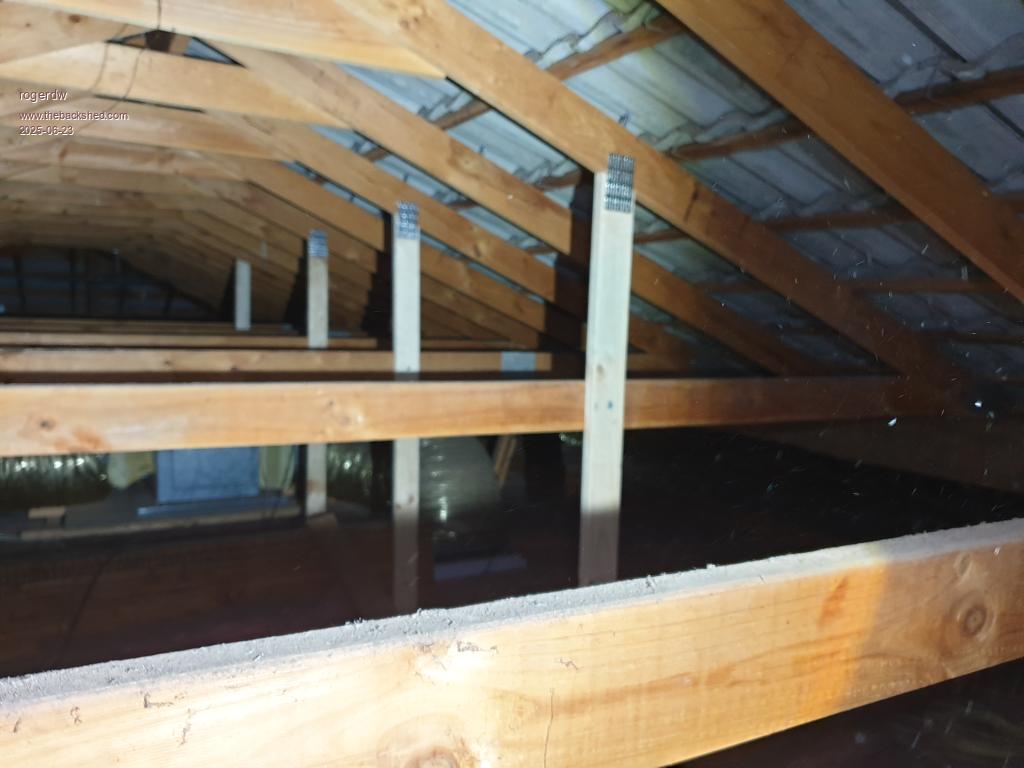

I managed to get four support timbers in for the higher side  ...  and was surprised and really pleased that there is a wall directly below, that the struts rest on. I'm hoping I actually planned that but can't really remember, it was so long ago when I was crawling around in the ceiling trying to work out just where to locate everything.
I haven't tackled the lower end yet but they need timber about 900mm long on a bit of an angle to another wall frame. Should be easy enough to do that next weekend.
It's not a good photo, but the anchor bolts are located directly above the studs  ...  and the bottom ends are resting on the wall frame. The closest one looks like it's on a bit of a lean  ...  but they were all dead vertical according to the spirit level. Must be the optics.

Well I spent some time in the ceiling again today and added 5 supports under the lower side of the mountings  ...  so it looks well and truly overengineered to me.
I harrassed the young fellow yesterday who's supposed to fold up the SS shrouds  ...  and he promised he will do them on Monday. We will see.
Now that the anchor bolts are sticking out through the tiles, I have to drill the heater frame in the correct positions for each corner. The remaining mounts on the sides will have seperate clamps which can be adjusted up on the roof  ...  but these corner ones need to be accurate. I don't fancy having the thing suspended under the crane and having to drill or file out the holes to make it fit over them all.
In hindsight I should have made the corner mounts the same as the rest  ...  would have been so much easier. Either way it will still work.
