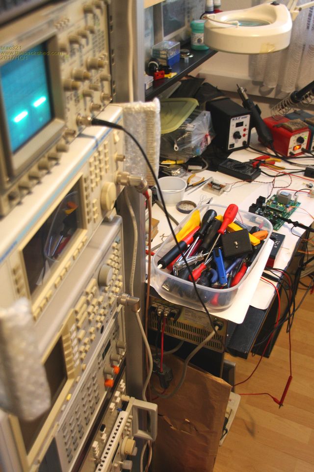

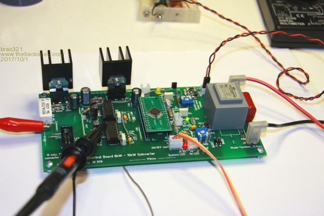

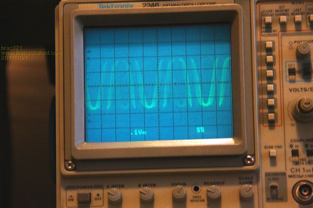

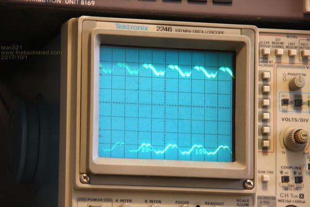

Have tested today ctrl board alone. For voltage sense I connected it to 230v home grid (Off-grid). It takes less than 30mA @ 50v. Both pulses are there, temp. protection works, current shut down and on/off switch too.
Is it normal that System LED flashes in case of voltage too low/high or current shut down, regardless to position of on/off switch? Also current shut down (after triggering) is not reset until I switch supply to board Off and back On.

Those scope pics are not what I remember, but it relies on where you actually measure as to the shape of the waves on the output side of the drivers, and you may need a fet attached to see it, or the high side voltage pump will not work properly.
Wow you have some gear there
.........oztules
Posted: 11:34am 01 Oct 2017
I am not sure what the first CRO photo is but the next one off the bottom IR2110 looks very good, the other IR2110 should short hi/lo similar to a square wave. Is that in the photo taken at a angle to the CRO? The other output pins on the IR2110's will not show a signal till it is connected to the power board as it requires the charge pump to drive the high side.

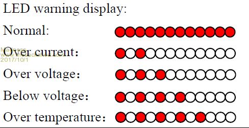

LED will flash as per below, this is from the EG8010 manual attached.
2017-10-01_213231_EG8010.pdf

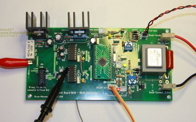

Hi Brac321,
I see you have updated the old 10aOzControl board to the 12 version, nicely done.
And your testing and photos are good to see.
I look forward to seeing your finished and running OzInverter.

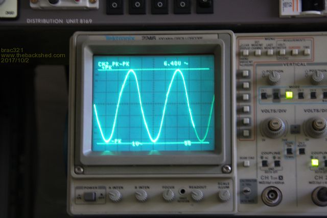

Oztools, thanks for all the infos. I think I will play a bit around this problem (current shut down reset), have some ideas.
My scope pictures, yes Madness 2nd one is valid and should be ok, 1st one was taken with not properly set scope (AC/DC ...). Blurry pictures taken at low light with my shaking hands, sorry.
"Wow you have some gear there" - hm, nothing special, older high freq. lab equipment up to 14 GHz. Some RF generators, few spectrum analyzers, modulation analyzers, video generators, etc. More than 30 years was occupied designing UHF & SHF - Microwave projects ...

Clockman, yes I've updated your board. It operates well, except problem with reset of current protection. After triggering it (with trimmer & DC source on sensors input), it stays permanently ON - until both boards were disconnected from DC source. Don't know if I missed something to rewire around SCR for rev.12? It is a bit strange to me, that diode bridge is not grounded in that part of board. I have only older Gerber files from Oztools where this protection circuit does not exists.
Any link to the latest, valid Gerber files?

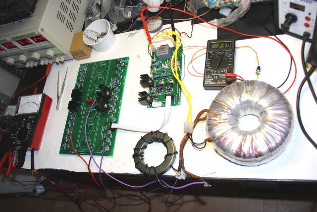

Have tested today ctrl and spare power board without caps, with only 4 fets on. For now all ok on a 2.5kW trany, with not proper voltage ratio (230/32v). Output voltage (AC) drops while/if lowering DC input voltage below 51v. I guess I need to unwind low voltage part of trany a bit, to get rid of that behavior. Above 51v DC in, output remains rock solid. Standby current with my choke is 140mA @ 51v DC (cca 7,14w).

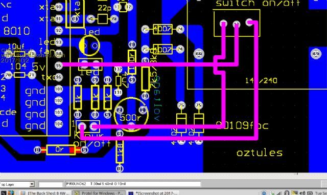

Posted: 09:12am 02 Oct 2017

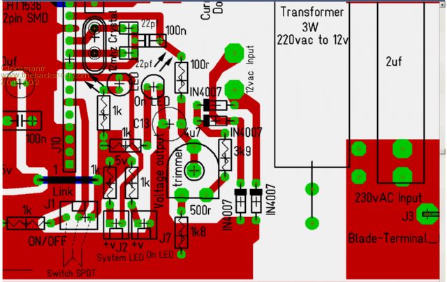

I am still updating my No12 board and have created Gerbers, but as usual I have modifications so now on 12b.
I did mention that I would send you a No12 when i was happy with it. But looks like your doing great with modifiying the No10 board.
I am sure you have amended the OzCntrl board No10 to the No 12 arrangement.
Just to check a couple of things brac123......
Firstly, ... I trust that you did not fit that 1k5 resistor that is shown on No10 board at Pin 6 of the 8010 chip.
Board 12 has Pin 6 going straight to the centre contact on a SPDT On/Off OzInverter switch.
Looking at your board a little closer, It is not clear.? I can not see that extra 1k resistor or is it under the board.
Regards shutting down the DC on the power board, ..... Personally I do not see a problem with this. I think its a good safety feature especially if the overcurrent has tripped, either alter the trimmer to allow more as Oztules says 10kW is fair, or check to see where the problem is.
Also if its a reset, then within 15 to 20 seconds then my BIG 250amp DC Midnite Breaker can cope. However like Oztules I add a 100r resistor when first connecting the DC to the Power board, as those Capacitors can draw horrendous amounts of amps, splat time, on DC connection even before starting the Inverter.
As he says, ..... "The one drawback with the 8010, is that if the voltage rises slowly, the chip will hang... and be totally unresponsive, so it needs a reset switch.
I do this by a momentary switch that shorts the power to ground after the 120r input resistor.... crude but works perfectly well.
This allows you to slowly charge the cap bank when installing it with say a 100r resistor.... the 8010 will hang, we reset ( short to ground after the 120r ) and we install with no brutal sparking.
It also is the only way to reset the current shut down. I did this on purpose, as I want a person to reset from a current overload, in case there is a real problem on the line. Mine are always set well north of 10 kw, if you blow that there is something wrong I suspect."
This is the no 12 board. .....
or Oztules. .......
Edited by Clockmanfr 2017-10-03

Your waveform looks good brac, next step on the power board is to fully populate it except for the caps. With no load the FETs will run all day like that without a heatsink. If you get the same result add the caps and heatsink then your done with that part.
Current protect would normally only be triggered well beyond 10 KW, it is intended to protect against a dead short type situation. A while ago I had a 5KW motor stall and it tripped the 20A breaker, the inverter handled that with no problem. This was without overcurrent protection but probably getting close to where it should be tripping.
I only mentioned putting the 12 VDC on the VFB for initial testing of the control board. This is the only time I would do this. You can test it by turning off the switch and have your probe on the pin you want to check and turn it on. This works but you only have 3 seconds before it shuts down due to no VFB.
Voltage is normally rock solid and never varies, as I see somewhere Oz wrote "the numbers are painted on the meter"
Sorry for any confusion caused.Edited by Madness 2017-10-03

Clockman, yes the 1k5 was removed, 1k (SMD is on bottom side) on the Off position of the switch. And that switch operates without any problems.
I would like to see part of the latest board around current protection (upper right corner of ctrl PCB).
