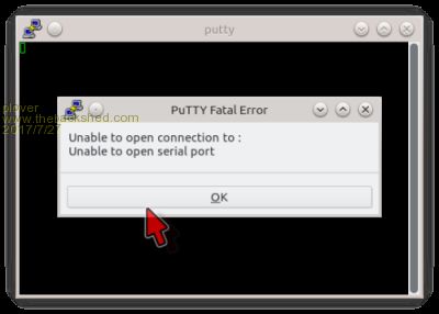

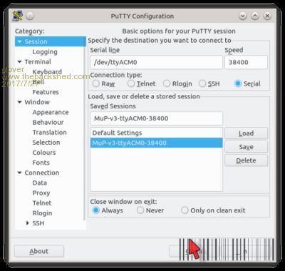

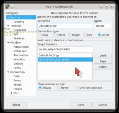

Following pic has capital ACM
Following pic shows succes
Now the device has acm lower case in the name
The picture shows linux putty differentiates between upper/lower case
So using Putty Linux I now know I must not use lower case, so I should stick to upper case only from here on.

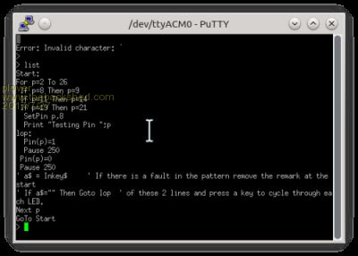

From Putty I reset MuP-v3 (plugged in at the moment)
[code]
Micromite MKII MMBasic Ver 5.04.05
Copyright 2011-2017 Geoff Graham[/code]

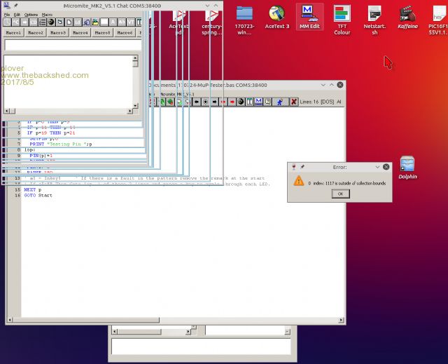

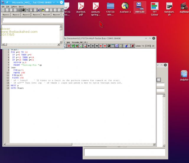

I have tried to write down student proof method to get my two Micromite systems running with MME every time starting up. I am very close to have it working every time but still not quite.
I can almost certainly connect with MME each time on my KDE5-os2 (my second system running MME) this system have however developed an unexpected problem (no doubt my tinkering but I have little memory of what it might have been.)
Assuming I have the linking in order and keep a close eye on any links getting kicked out when I open MME then.
1.. Clicking on the MME icon on the desktop will open MME nicely, you will see on the picture following.
2.. At the moment I almost invariably start MM Files, which comes to the front of MME window. I use this step to ensure the comport is connected, if not I will get an error.
3.. Then I start MM Chat, which pushes MM Files to the background (not closing it) and a rather small MMM Chat window pops open, which I can open in full screen and continue working.
4.. The logical thing is to resize the window to a bigger size (used to open to a comfortable big size). Attempting to resize puts a spanner in the wheels and the MME is locked up. Killing the process the quickes way out. The two following pictures shows what goes on.
Small error message:
[quote]0 index: 1117 is outside collection boundary[/quote]
These are original screen cuts, I reduced them to about 1/3 but for some reason those would not upload. Sorry about the size.
The first picture is what shows before I try to resize. The second picture is when I have locked up MME and then Kill the MME process to get going again.
I wanted to resize because the small windows a too much to put up with. I have a workaround for the moment, perhaps. An application window can be configured in a number of ways, one it the open size. I did that in Linux and seems to work, or is a better workable situation. I have only done limited resizing, lock up not hit me yet.
Edited by plover 2017-08-06

Posted: 12:25pm 05 Aug 2017
I can repeat the "index: 1117 is outside collection boundary" error on my Linux setup so I will have a look at it.
The error doesn't occur on Windows.
You can get around it by closing the file manager before opening the chat window.
Because the error only occurs with Linux and there is a workaround, I will not put too high a priority on it.

Looks simple enough? Well the snag is the MicroMite happily prints a "0" and ignores ctl-C, when using MME.
OK I must have done something wrong, I close MME and start up Linux "Putty" and type RUN, no problem left column a "0" but this time the program can be stopped with clt-C
My understanding is that "Hello" printed for 4 seconds and then program stops as it comes to the end
Errrhh, suggestions welcomeEdited by plover 2017-08-15
Posted: 01:26am 14 Aug 2017
Your quotes round the word Hello aren't normal double quotes - this is causing the problem
The Ctrl-C problem is caused by the output filling the output buffer before MME has chance to display it or something like that - i.e. it is too fast for MMEEdited by matherp 2017-08-15

Thank you, your post broke my train of thinking and got me on the right track again. I made the mistake of copying from Geof's manual, he wrote it in .doc and it has really funny "". I copied the snippet into MME and I did not notice that the syntax colour was wrong for string "Hello", neither did I notice that when MME transferred the program to the micro that the wrong "" must have been stripped off.
When I looked at the program in Putty I noticed the quote marks were missing, my brain "knew" they should be there so I did not see they were missing. Never good to proof read your own material.
While in Putty I edited the program and added the proper "" and tried running again. Now I got the Hello printed a lot of times because of the speed. I added a PAUSE statement.
