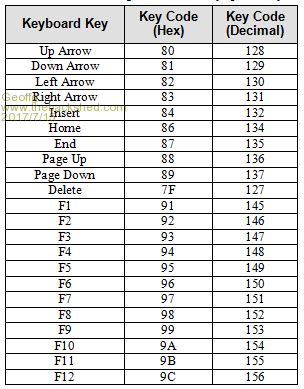

I found key-presses using INKEY$ in QuickBasic very handy when doing text-mode dialogs.
In MM when keys are pressed which generate compound codes [e.g. up-arrow CHR$(0) + CHR$(72) ] then the second code is delayed until the subsequent key-press...and so forth..until a key which doesn't generate a compound code is pressed...everything 'catches up'.
I seem to recall this may have been an artefact of the environment you're coding the DOS version in.
e.g...using following code:
DO:a$=INKEY$:IF LEN(a$) THEN ? ASC(a$) ELSE a$=a$:LOOP WHILE a$<>"q"
Pressing Generated Char Code
<UP> 0 (should have 72 as well but that appears on next key-press)
<UP> 72 and 0 (previous 72 + this 0, missing next 72)
<q> 72 and 113 (which is the remainder of the up arrow + q)

  flip said  In MM when keys are pressed which generate compound codes [e.g. up-arrow CHR$(0) + CHR$(72) ] then the second code is delayed until the subsequent key-press...and so forth..until a key which doesn't generate a compound code is pressed...everything 'catches up'.
That issue and the other bugs are fixed in the attached version 5.04.05 Beta 4:
2017-07-15_143318_DOS_MMBasic_5.04.05_Beta_4.zip
This version generates the following codes for special keys:
The manual has been updated to reflect this and the other errors listed above.

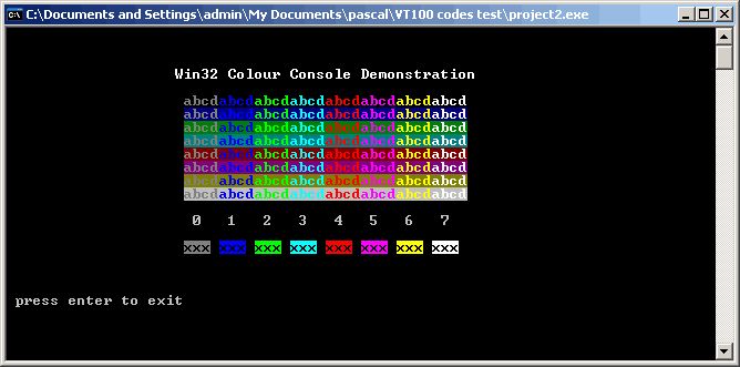

have done a bit of digging - getting VT-100 compatibility is indeed complicated. however, positioning the cursor and changing colour attributes is relatively simple using the win32 API calls SetConsoleCursorPosition(h, xy) and SetConsoleTextAttribute(h, at).
the attached demo (source included in delphi/pascal) provides three functions:
gotoXY(x, y)
colour(attribute)
clrscr
i reckon these three functions would be a neat addition to the DOS version of mmbasic. there are also console functions in the win32 API to handle keyboard (and possibly mouse) input, but these look a little more involved. see:

Interesting. The DOS MMBasic uses the Watcom C compiler so I need to get at the API from that. I will look into it.

Posted: 08:15pm 18 Jul 2017
but if the goal is to simply replicate the PIC32 version, would one then not want to also think about putting in stubs to in some way handle all the I/O? i rather like the alternative idea of DOS mmbasic being something that has it's own unique set of festures - running on a PC there are a whole swathe of applications that are out of reach of the PIC32 versions.
the below .zip file contains an external program (cursor.exe) that can be called from within mmbasic to provide colour and cursor positioning. there is a demo program (colour demo hack.bas) included to show how to use it. painfully slow, but it does demonstrate the idea.
2017-07-19_060844_cursor.zip
note: you can't just drop the 'colour demo hack.bas' file onto the mmbasic icon to run it, as mmbasic will start up in the wrong directory and not be able to find cursor.exe. instead you need to start mmbasic.exe, then type:
load "colour demo hack"
run
rob :-)
