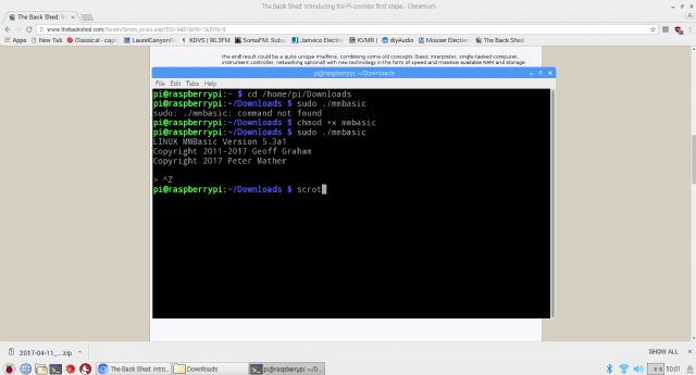

Posted: 07:15pm 11 Apr 2017
More playing, this time with a USB-TTL converter.
  Quote   ' serial test program
OPEN "/dev/ttyUSB0" FOR RANDOM AS #5 ' open the serial port
PRINT #5, "HELLO!!! Is anyone out there?"
DO ' one way to receive serial data which might not be there!
k$ = INPUT$(1,#5)
IF k$="" THEN
nodata=nodata+
1
ELSE
result$=result$+k$
PRINT result$
nodata=
0
ENDIF
PAUSE 20
LOOP UNTIL k$=CHR$(10)OR nodata=50 ' 50*20ms = 1 second timeout
CLOSE #5
There doesn't seem to be a way to change the baud rate yet. My FTDI converter defaulted to 9600 baud.
It seems to need the "FOR RANDOM" bit in there so we think its a file.
A Linux observation - The text is sent with a <LF> only so if you are waiting for the <CR>, you will be disappointed.
So far I have tested with a loopback plug on the serial adapter but there is no reason a micromite couldn't be sitting there.
This version on MMBasic doesn't save your code between sessions so remember to do a SAVE before exiting!

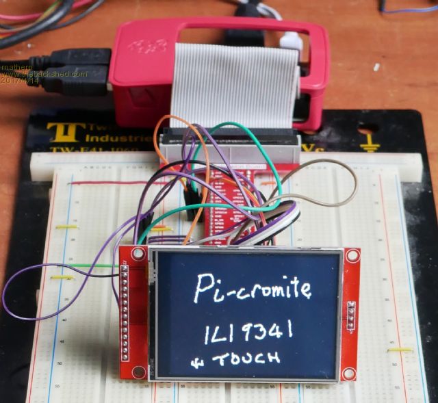

Posted: 03:15am 14 Apr 2017
Fairly big upgrade 5.3a2 including more "Micromite" functionality
2017-04-14_184056_mmbasic.zip
This now supports hardware SPI using Pi pins 19,21,and 23 with the standard Micromite syntax (SPI OPEN, ? SPI(x), SPI WRITE, SPI READ)
In addition it supports the following SPI displays connected to the same pins (+ user selectable CD, CS, RESET) ILI9341 (320x240), ILI9163 (128x128) , ST7735 (128x160), ILI9481 (480x320). Transparent text and BLIT are available for the ILI9341 display.
Touch is fully implemented and should also be connected to the SPI H/W pins + user selectable IRQ and CS.
The displays and touch are enabled using the standard Micromite syntax (OPTION ...)
Options are saved in the file ".options" in the same directory as the mmbasic executable
GUI TEST LCDPANEL and GUI TEST TOUCH are both implemented (exit using ctrl-C)
All MX470 GUI capability is also implemented and has been tested at a limited level.
as before you need to install pigpio on your Pi if not already installed
[code]sudo apt-get update
sudo apt-get install pigpio python-pigpio python3-pigpio [/code]
and execute mmbasic using
sudo ./mmbasic
Always exit mmbasic using ctrl-z or "quit" to avoid leaving disconnected processes running on the Pi which will interfere with pigpio initialisationEdited by matherp 2017-04-15
