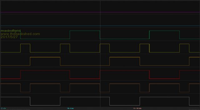

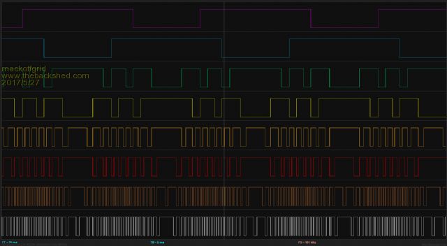

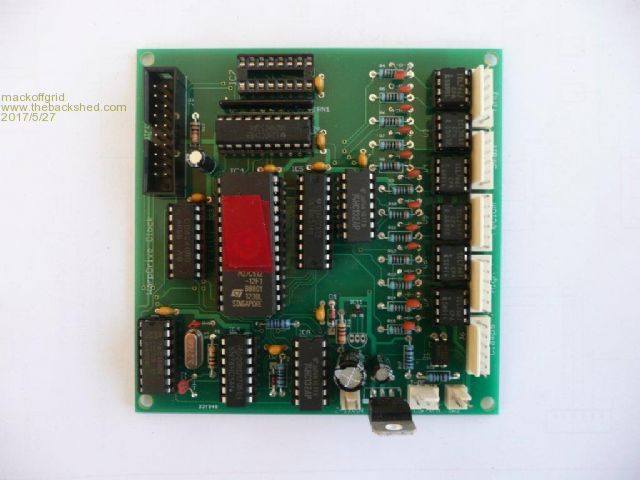

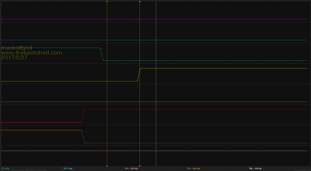

I've received my Clamper PCB so my Clock PCB couldn't be far away since I submitted that first.
I've written my program to make the Binary file for the Eprom. 27C512. Comprising of 32 maps of 2k each. It covers 25V to 28Vdc and by my calcs the RMS value of each map only differ by a few volts.
It generates a csv file to show information pertaining to each Vdc level. I've attached the file for 26.5Vdc. Looking at this information I worked out the frequency of each transformer.
Switching cycles per 50hz cycle: 1, 5, 17, 53

I have been testing the Clock brd this week and all is going well.
The Connector at the Top Left and the missing ic are part of the uProcessor brd control and is not needed to test the clock board and basic inverting.
Next is the Logic capture of D0 to D7 out of the eprom/574
At this point the signal is active Low. D0+D1 drives the smallest transformer and so on.
Next shows the signals for just one transformer (Large Transformer) in more detail. From the Bottom, D6 then NAND (D6,D7) , then D7 , then the same three signals after a delay and after been inverted by an ICL7667. At this point the signals are Active High. The Nand of D6 & D7 is the clamp signal.
The next image shows the delay (looking at the Clamp signal going active high.
Tony, the dead time measures around 1uSec - I'm considering changing the 3k to 10k to expand the dead time.
