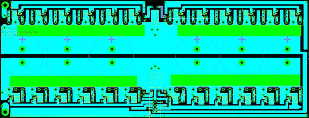

My build I also will be mounting the fets underside. Fets are TO-247 IRFP4332

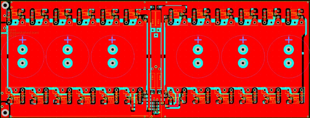

I also want to reduce the mainboard down to 100mm wide so I can fit 2 prototypes on a 200mm x 300mm sheet. Any chance you can post your artwork.
Posted: 10:53pm 14 Aug 2016
Hi Steve,
Yes, no problem, I have yet to verify it is working correctly but I believe it is right. I am using 250 wide PCB so I have made it fit on the size and is 100 mm wide, the image below are from Design Spark, can send you the files if that is any help.

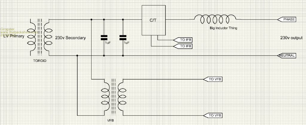

So is this the correct arrangement:

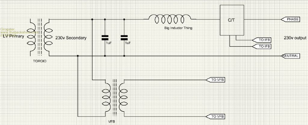

...or this:
Edited by Grogster 2016-10-04
Posted: 11:21pm 02 Oct 2016
Mine is gonna be the second drawing (...or this:) as the VFB transformer, C/T core and shaping caps are all on the same little PCB.
I will connect the "big inductor thing" (mine also has small caps on it) last in the queue, just before the mains connections to my house.
Oztules, I'll keep my fingers crossed for that big inductor filter to attenuate the 20KHz noise too. Thanks for pointing my nose in the right direction for looking at the CRO screen.

No 2 looks good.
......oztules

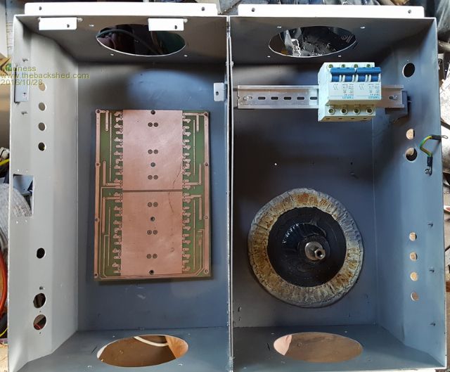

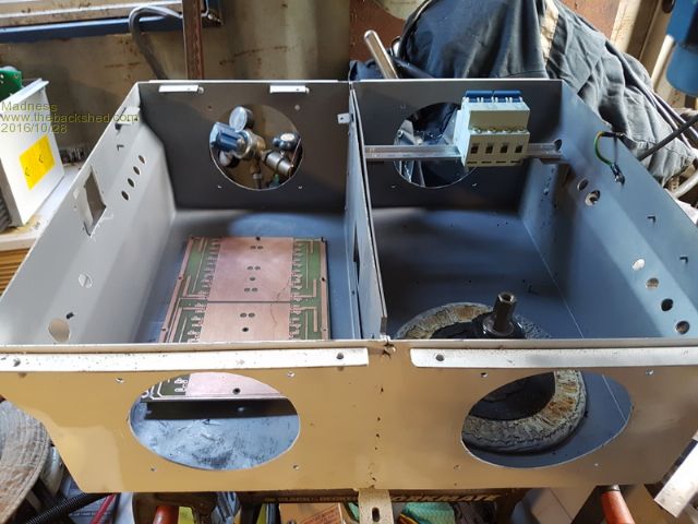

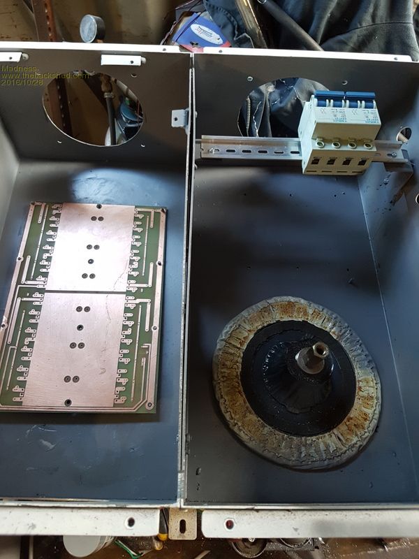

After many trials and tribulations, I am close to getting a working inverter. Somewhere I got the wrong information for the snubbers, they need to be 103 3KV caps and 2W 47-ohm resistors. Also after trying several different circuit board layouts I have now made a design that is very close the original Chinese design. This also uses the heatsinks as conductors for the positive input and AC output. I am yet to test this layout but received an order of MOSFETs I was waiting on today.

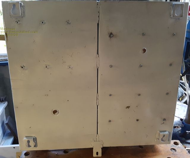

Here is how I have made the case, very similar to Oztules with 2 Aero-Sharp cases bolted together, except I have included a twist. That is I have rotated it 90 degrees so the air can flow better with natural convection as well as with the assistance of 4 140mm fans.
Posted: 12:14am 28 Oct 2016
Cutting those big fan holes in 2mm ss would not be my idea of fun , good on yer for giving it a go.
Your comment about 3KV snubber capacitors has me wondering, that rating is more often found in high voltage inverters.
I'm using mains rated mylar capacitors which I hope is ample in a 60V primary circuit.
