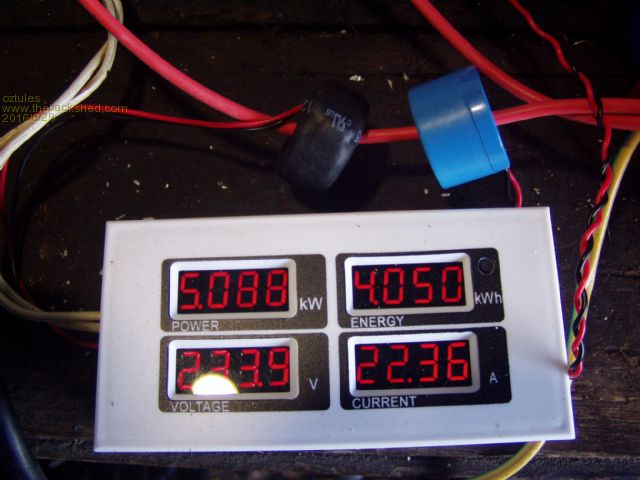

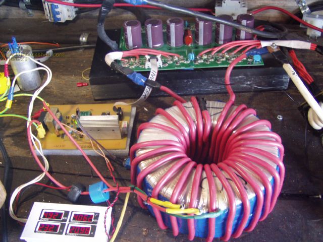

For encouragement, here I am testing the response of the heat sink to no fans and the flat style power board both me and Mad are using.
I am running the whole house, and the HW is on, the washing machine is on, as is the water pump, tv, and countless other gadgets at the moment.... and then the kettel.
So this shows the usage while the jug is on.
The tranny is a quick test thing well under rated, but still holding the 5kw fine...
and this shows the mess making it:
The transformer stabilised at 70C after 2 hours of average 2.5kw, with excursions up to 5.3kw. This is a test transformer only!
Heat sink temp which is what we are really interested in here slowly climbed from 20c to 37c... and stabilised there.
No attempt to cool, or even give it convective cooling opportunity.
It is using an inspire heat sink... and thats it. The fets are sandwiched to the heat sink under the power board ( from clockman thank you).
It looks like you may need no extra cooling if you use an average load of 2.5kw

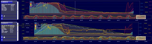

After I get my inverter finished I will be working on a Arduino based monitoring system with data logging and network access so I can read what is going on via a computer. My charge contollers do this and I like it a lot as I can see at a glance what has been happening at any time.
White in bottom graph is state of charge
Brown battery current
yellow battery volts
green battery temp
Edited by Madness 2016-06-30
