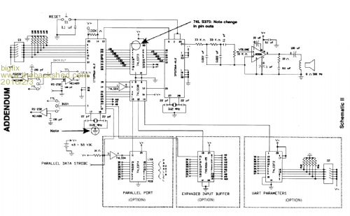

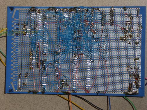

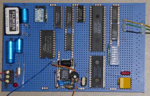

I have a version which does not require holy water or any C-Code !!!
It is THE original maximum version from Radio Shack parts built with WireWrap
I have no detailed memories about it at all, I believe I built it in the mid 80s
while I worked at DEC.
Soon after I got a scrapped DECtalk - which was the Rolls Royce of Voice HW...
So I shelved it and completely forgot it until just now...
cheers
Guenter

bigfix, does your SP0256 circuit still work? I got one of those chips too and have used it with a Basic Stamp and a Parallax Propeller but I had to use a colorburst crystal.
Last year I was lucky enough to come across the crystal and the CTS256 chip used in the circuit you made. I just need to get the latch ICs to build it.

Right now I have a complete mess here, as I try to sort the unfinished piles in my electronics room into meaningful heaps...
But I will try to reverse engineer what I did 30 years ago and post the outcome here
