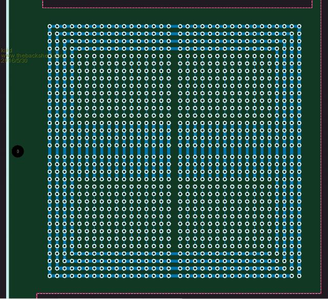

kiiid
Joined: 11/05/2013
Posts: 671
Posted: 10:34pm 29 May 2016
This is how the prototype area is internally routed
http://rittle.org

vegipete
Joined: 29/01/2013
Posts: 1193
Posted: 09:21am 03 Jun 2016
  kiiid said   This is how the prototype area is internally routed
A very nice creation, and elegant use of circuit boards.
Not to be picky, plus it's probably too late to change, but that proto area routing looks strange. For example, I can't see any way to position a 28 pin MX170 Micromite. A layout more along the lines of standard breadboard would seem more flexible, even if broken into 4 mini-boards.
None the less, nice work!
kiiid
Joined: 11/05/2013
Posts: 671
Posted: 10:59am 03 Jun 2016
That is correct. I have noticed that too and planning to edit the connections these days. Will post the updated layout soon.
http://rittle.org

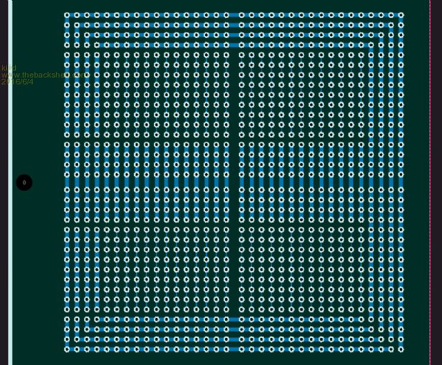

kiiid
Joined: 11/05/2013
Posts: 671
Posted: 11:11pm 03 Jun 2016
A possible alternative which I think is much better and still has the orbital bus traces.
Anyone with opinion?
http://rittle.org
vegipete
Joined: 29/01/2013
Posts: 1193
Posted: 07:42am 04 Jun 2016
What connections to the Ello's processor are provided on or around the proto area?
kiiid
Joined: 11/05/2013
Posts: 671
Posted: 09:05am 04 Jun 2016
  vegipete said   What connections to the Ello's processor are provided on or around the proto area?
None. The connections are made through jumper wires from the proto space to the expansion port next to it. This is intentional. I want to minimise the risk of someone frying the whole board with a wrong prototype circuit.
http://rittle.org
