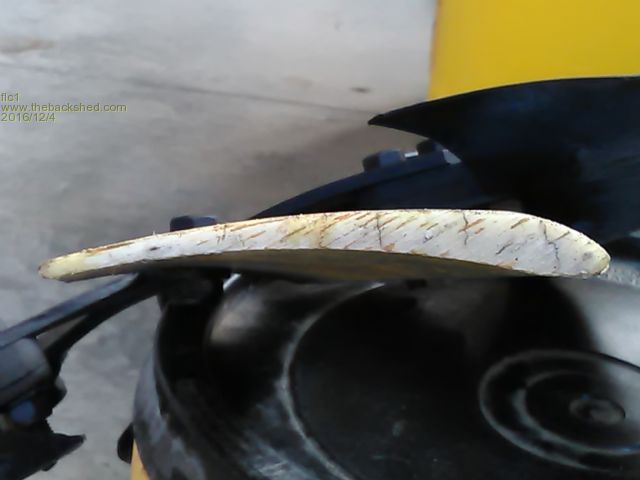

aerofoil shape of blades on my turbine

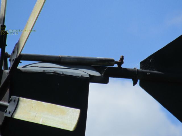

photo showing one way dampner fitted along top of the tail ,to stop tail hitting back too hard on seat during storms, my first turbine did not have dampner and nearly snapped off top of pole during a storm.
