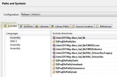

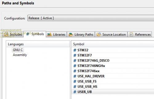

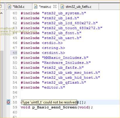

Uwe and/or Fabrice
I've downloaded the source and (after installing stm37f746g-disco_hal_lib) it seems to build OK except that when I open any of the source files they show the little bug symbol against all the stdint datatypes. I tried explicitly including stdint.h but this doesn't seem to change the problem. Any advice gratefully received.
Peter
UPDATE
I've also got the same thing with other definitions e.g.TIM_HandleTypeDef
This is some sort of difference between the editor and the compiler. The compiles work fine but the editor shows errors so it is not seeing the includes properly.
Edited by matherp 2016-02-08
derexponent
Joined: 20/09/2015
Posts: 24
Posted: 04:12am 07 Feb 2016
which IDE ?
do you have the same problem with a new generated project ?
please check your path and symbol setting :
"USER_UB" not necessary
i have installed the "HAL libs" in a folder named "stm32f746g-disco_hal_lib"
if you have another folder ... edit the settings
Uwe
Posted: 08:37am 07 Feb 2016
Hi Uwe
I'm using System Workbench. Seems like you need to run the C/C++ index command after many changes as the IDE doesn't seem to always keep up.
Anyway, I'm up and running now.
