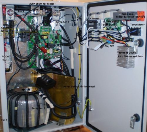

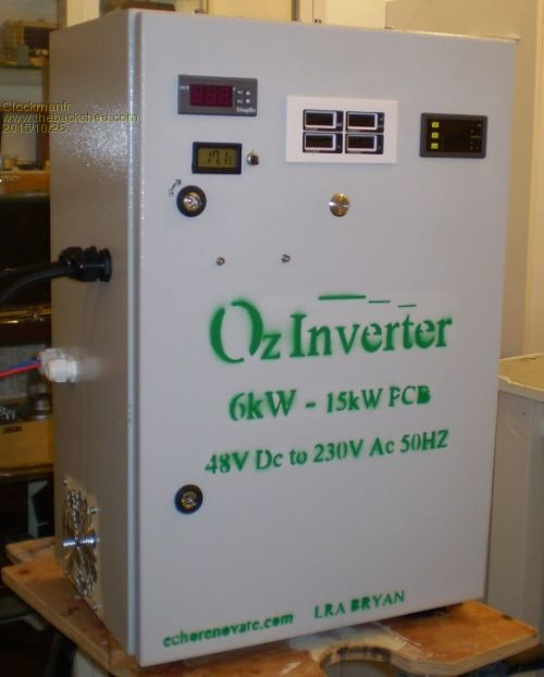

What I discovered with Oz's Inverter toroid construction was the true simplicity of oztules design.
By stacking two or even 3 cores together the centre hole becomes to narrow for a standard toroid machine winder to get in.
I purchased 2 cores with each at 190mm OD x 90mm ID X 60mm thick, 6kgs 1.8mm diameter copper winding wire, and some 6 meters of 50mm/2 single covered wire.
Total cost for my Oz toroid was about £260 GBP.
I put 4 separate 1.8mm diameter 118 turns secondary on my cores and 14 turns of the 50mm/2 for the primary.
Total cost for my 'OzInverter' was about £500 GBP.
Next time I will go for the bigger cores with a larger OD and a bigger hole in the middle as I struggled to get 14 turns through in a tidy manner. And I will take the primary to 75mm/2 thick......
These are ideal,... 2 off these.....
http://www.airlinktransformers.com/toroidal_cores/ros217/
The Metal enclosure is 600mm high, 400mm wide and 300mm deep. I need a support bracket as the whole weighs 52Kgs.....
Edited by Clockmanfr 2015-10-27

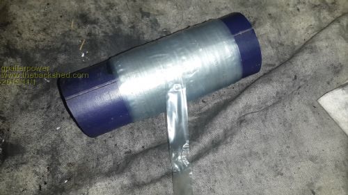

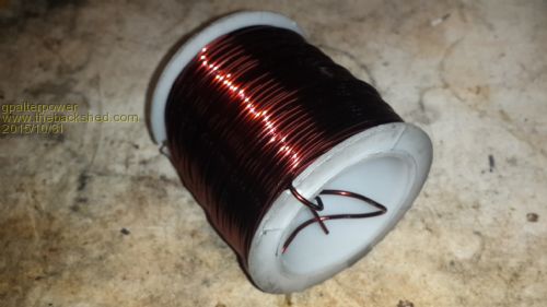

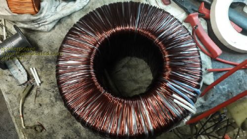

Well, got straight in to it on Friday . I cut down a bobbin from an old wire reel into something that was just small enough to fit thru the centre hole, and, after a little maths, I wound what I thought was enough wire to complete the 96 turns of 1.6 wire in the lathe. Plus a little extra just in case! Better too long than 5 turns too short!
This definitely made things easier as I could pass the bobbin thru the hole and keep the wire taught at the same time. A glove helped as it was cutting in to my hand. First layer done and on to the second. Same again. Slow process but just keep at it

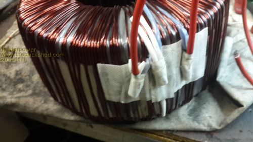

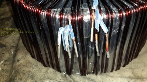

I thought before doing the final connections, I had better test to make sure the new winding were the correct amount of turns. I did this by powering up any one of the 3 original windings thru a 60w lamp. In theory, the voltage that was induced in the new winding should be exactly the same as any of the other 3 original. When winding the 2 new 1.6mm wire I placed a few additional turns on each. Checking the voltage on the new winding was a couple of volts too high, so I just removed turn by turn until I had the EXACT voltage on each new wind as compared to the original.
I paired off 2 of the three original windings as my start and the finish was connected in series, with the remaining third, in parallel with the 2 new I had just wound. I now had a single wind of approx. 190 odd turns of 8mm squared wire.
I placed 12v across the new winding and waited till it warmed up. It didn't take long as it was drawing 60A. I then poured varnish (isonel 31) over the windings and watched it melt like hot butter on toast. Then let it air dry overnight. sticky stuff!!

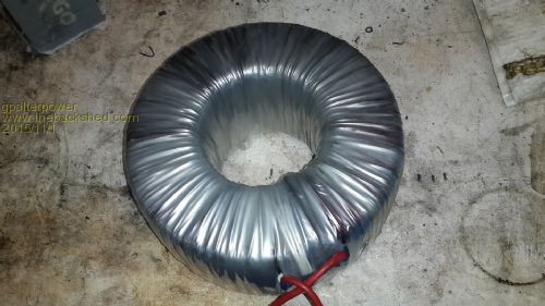

I saved all the mylar insulation( had what seemed like klms of it) and wound it on to another bobbin in the lathe.
Same story again winding, winding and more winding, passing the bobbin thru the hole till I achieved my goal of insulating the core. Back in the oven again to set the varnish. Solid as! Winding are tight and the mylar seems to be a heat shrink material looking even tighter! Finished product....for now anyway. primary next
MarcusEdited by Gizmo 2015-12-19

Marcus, using a trimmed down bobbin to wind wire through a toroid core is not the way I would do that. I'd use a shuttle (as in weaving loom), this can simply be cut from a plywood strip and made as long as is comfortable to use. Of course, the longer it is the more wire it will hold for the same full shuttle diameter.
oztules
Joined: 26/07/2007
Posts: 1686
Posted: 09:40am 01 Nov 2015
Klaus,
That only works well with thin wire... it is next to useless for heavy gauges... you end up with a sloppy kinked mess in no time.
Using the method Marcus used, provided you unwind in the right direction, the heavy wire will lay tightly against the torroid walls, without kinks or bends.
The shuttle method relies on you being able to straighten the wire out each pass through by just pulling it tight... you need about 100kg to pull straighten 2mm wire, particularly if it is work hardened. 1.6mm is too strong to do that way either.... particularly a rewind.. the wire gets very springy .. quickly.
I have wound quite a few now, both 1.6mm and 2mm.... shuttle method sounds good until you try it with heavy wire.
Dual and tripple torroids is even more problematic, as the internal straights are 5 or 6 inches long or more, you need the wire to naturally hug the wall, or it becomes a springy mess.
Been there and tried it.
