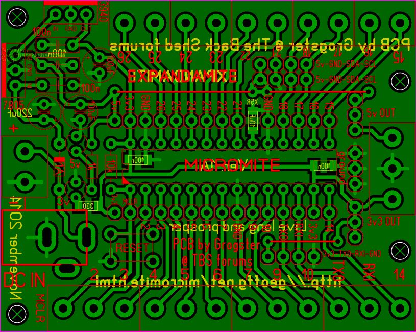

OK, here is the final:
I've aligned the right-side t-block and headers for power, to a standard grid(0.3175), moved the 10k for MCLR slightly to the right to allow for IC socket, added 3v3 LED and resistor(SMD), and changed the terminal header to four-way, which is pin-compatible with the VT100 terminal board.
Here is the ZIP file:
2014-11-13_011240_Expandamite_1A.zip
This file contains all the gerbers, the Excellon drill data, the original LAY6 Sprint Layout file, the GIF image, and isolation milling CNC files.(mirror, drill from copper side, mill from bottom side, single pen(drill) size for holes as a pilot)
Do with it what you will!!!!

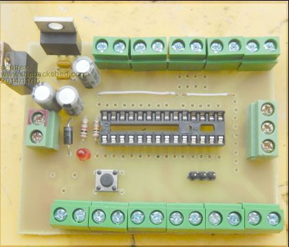

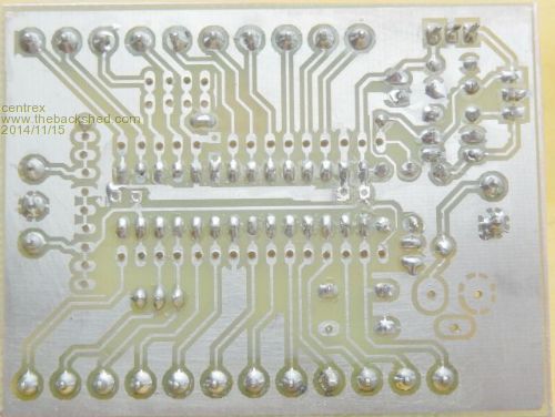

Hi Grogster
I hope you take the attached pictures as a compliment to the excellant job you did with the expandamite.
Below is my version using your layout.
I use a very old program for board layouts, it is called Traxmaker, it was developed for windows from a dos based version.
The board is close to your dimensions, all done to a 0.1 grid with a 25mil snap to.
Unfortunately I do not have the special cap req for the 170 micro.
Anyway here they are.
The board is made with Riston coated pcb, which is hard to get in Sydney as both sources are no longer...
regards
CliffEdited by centrex 2014-11-16
