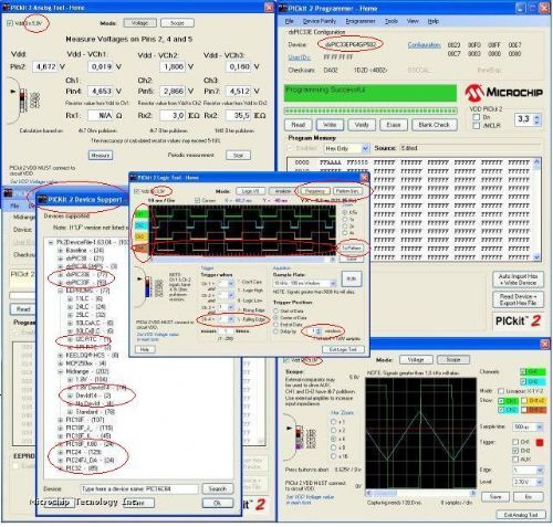

  vasi said   Here is a great open source programmer, actively developed. Can do PIC and AVR, 24x memories, 1wire devices, and soon a lot of great features:
[quote="Alberto Maccioni"]increase support for PIC and ATMEL micros (as soon as I can get free samples); add ST72, JTAG, parallel memories; expand ICD support; compile firmware also with SDCC [/quote]
Definitely, something to keep an eye on.
Reminds me of a stripped-down (reduced feature) BusBlaster - which can also program chips, including via OpenOCD.
Neither is especially cheap and partly because they offer lots of features not needed if all that's wanted is PIC32 programming.
vasi
Joined: 23/03/2007
Location: Romania
Posts: 1697
Posted: 05:17am 29 Apr 2014
That project is great for Lab. Especially for those programming both PICs and AVRs (considering that any Pickit2 clone has the Microchip interdiction to program anything different than PICs). It has a hidden gem - MPLAB C18 programmers may be able to discover it. But yes, it is too much for PIC32, considering that it does not support it yet and JTAG feature is yet to come. Those interested will keep an eye on the project.
Anyway, along with usbpicprog, is an excellent alternative to the discontinued Pickit2 programmer. Easy to build.

Though the software is not being updated by Microchip, its not discontinued.
PICkit 2 is still being sold by Microchip and is supported in MPLAB X.
And the open source nature of it allows anyone to update the device file for the command line and GUI software.
I'm trying to keep it up to date for the 8-bit crowd with my own PK2 open source project at my website http://www.elproducts.com/build-your-own-pickit-2.html
It integrates so well with the GCB@SYN IDE for Great Cow Basic, I can't imagine using any other programmer.
And the integrated UART tool and Logic Analyzer are an awesome option for the beginner just getting started.
So don't call it discontinued, its still around.

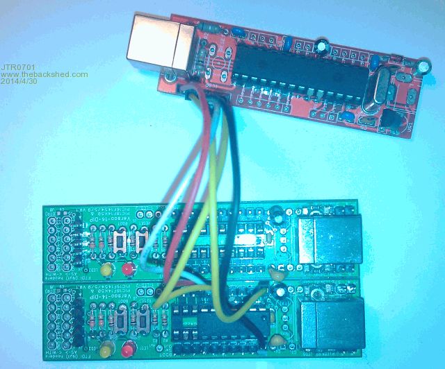

Well, I have, did it a few months ago when I first saw the micromite and realized this could be a neat companion chip and bit of a fun challenge to mock-up and get working.
In front of me is a 14-pin 16F1455 that is both a PIC32MX programmer and a USB - RS232 bridge. The beauty of this chip is that it is available in a DIP package and that is what I am using.
The micromite is on a dangerous prototypes breakout board and yes, those two pins are meant to be out of the socket. (Troubleshooting the programmer.)
The other board(s) are my own 8/14/20-pin [USB] PIC dev boards. There are two still v-grooved joined. What you cannot see is the 3.3V voltage regulator and 3.3V/5V switch under the board.
While I have a basic programmer and a rather trick USB-RS232 bridge working, as always getting the guts of it done is only half the battle. The software for the programmer needs to be rewritten for cross platform support (Currently it is written in VB6) and then there is the documentation and support etc.
Really not sure if the idea is worth going any further with at this time. I am looking to sell of the small stock of these boards but I probably will kit them up with a 18F14K50 and bootloader.

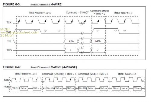

It is probably better to download 60001145M.pdf from MicroChip - much clearer.
Programming PIC32 flash memory is achieved using four signals:
TCK clock input - supplied by the programmer
TDI data input
TMS mode select
TDO data output
The "T" stands for "Test"
The device being programmed is often referred to as "TAP" (Test Access Port).
The Pic32 supports two programming methods - 4 wire and 2 wire. In the four wire mode, each of the above signals from the programmer connect to the PIC32. However, in the two wire mode (ICSP), we only have a "data" and a "clock" line so the PIC32 has to be able to decode serial data and send it to the appropriate register.
In ICSP mode, four clock pulses (TCK) are used to clock in the three control values in the sequence:
TDI + TCK, TMS + TCK, TCK, TDO + TCK.
TDO is an output and is clocked on the positive edge of TCK. The other two signals are inputs and are clocked on the negative transition of TCK. All programming commands are achieved using the TDI and TMS signals, and always in the sequence shown above.
If data needs to be read from the PIC32, each bit is read at the TDO period by setting the PGD (data) pin on the programmer to input and reading its digital value. To read in an 8 bit byte will take 32 TCK pulses.
It all looks rather complicated.
Next section will endeavour to produce a simple MMbasic code to achieve a programmer command.

I think the 2-wire is the best to use.
Those TDI,TDO,TMS,TCK are often wired into a circuit forcing the user to remove the chip for programming. Most boards will provide an ICSP with the correct circuit to allow in place programming.

  TZA said  I think the 2-wire is the best to use.
Zackly!
That's the only reason I am sticking with ICSP. 4 wire Jtag would be much easier and faster.
I am writing the MMBasic routines to perform the various commands at the moment. But they'll need refining.
