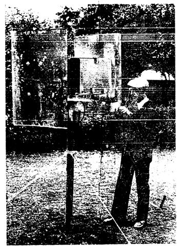

Here is Miller's wing
And one of Miller
No revelations in the book

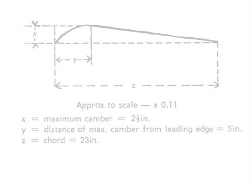

ok miller enthusiasts, what do you reckon about the camber? is that going to help starting and efficiency? it looks like it should.

I can't help thinking a curved camber would be better than a straight one

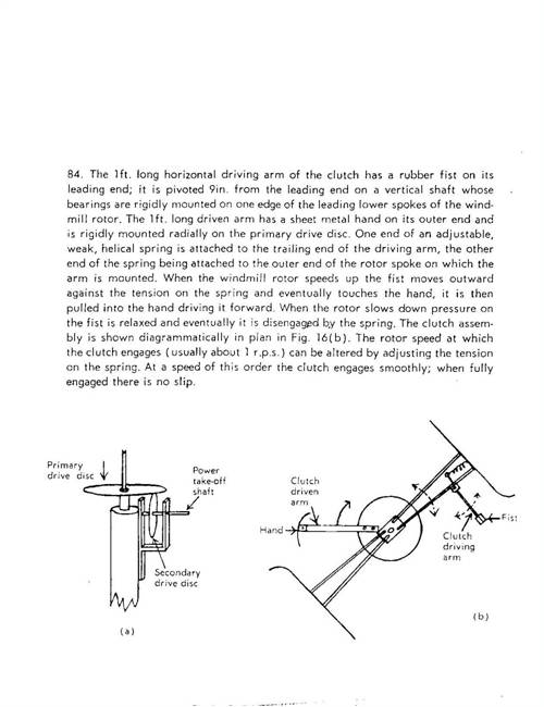

Here is Miller's idea from his book

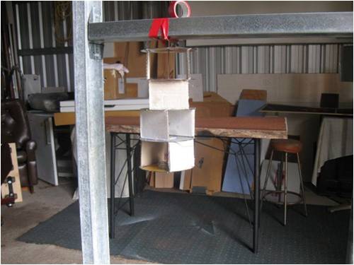

I made a test model miller. 27cmx36cm panels with adjustable camber and panel radius spacing.
using a pedistal fan about a metre away [very unscientific I realise] I got these results.
panel radius. rpm
26cm 72
30cm 66
35cm 60
40cm 51
Adjusting the camber either way made no difference at all
for rpm or starting.Increasing the camber to more than in turnymf's diagram decreases rpm. The panel radius also made little difference to starting.I didn't take any torque/camber measurements.
I think I will make my next miller without camber and make the panel radius about the same as the panel width.

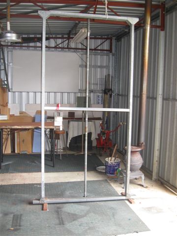

I do have the frame done, and have worked out the vane configuration
Just have to decide on the vane( 300mm x 600mm) material
It's not to Miller's or Ron's spec, more to make the 4 tier easier to build
and not get too tall
cheers
