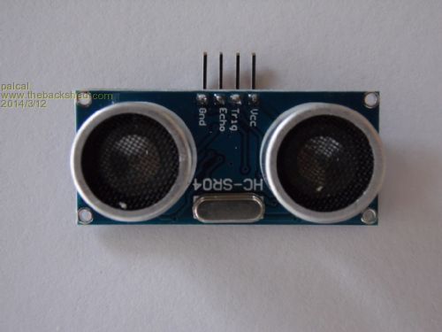

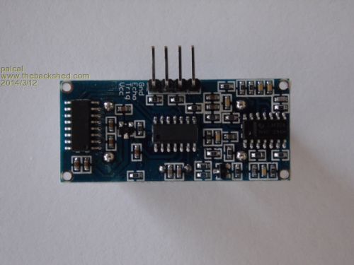

Here is a picture of my module.
Paul.

I have the same looking module as you, but these are what are being copied in their 1000's and sold at pennies simply because of the inclusion of sub-standard components. This is proved by the inconsistent results people are obtaining when using these Modules with a MicroMite. I will order 3 more from different UK suppliers (to minimise delivery times) and see what other peculiarities pop up!

OK now I understand, yes I agree the program should not stop. I don't get the -1 value
but what you can see in a previous post. I am tempted to buy some different ones from DX but they take about 3 weeks to get here. I would expect that all the four pin modules would use the same technology.

My HC-SR04 module (4 pins) looks similar to your photos until you study the component layout. I will try take photos of my module and post them so you can see how much the Modules do actually vary.
Bear with me cos my kids keep waking up tonight for some reason so may be a delay posting . . .

Posts: 2998
Posted: 02:51pm 15 Mar 2014
I will post photo of module (front and back) tomorrow once my camera has charged overnight.
