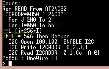

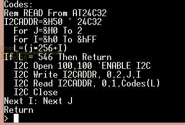

Possible bug
Send attached file to MicroMite
list and note the last couple of lines (normal at this stage)
edit
scroll to bottom of program confirm lines as per list
scroll up a few lines (Random amount)
edit a line or add a line (anything)
F1 to save
list and notice the last few lines
edit
scroll to the bottom and last few lines are missing or garbage
2014-02-16_035647_Odd1.zip
Jman
Posted: 08:29pm 15 Feb 2014
  jman said   Possible bug
Jman
Well, I did get the error you are describing a few times but after I added a CR to the end of the file, I was unable to reproduce the error.

Thanks John, that is a bug.
It was caused by the program being very close to a 1KB boundary (the file was almost exactly 3KB in length).
I have fixed the bug for the next beta. In the meantime the workaround is to append about 50 characters to the end of the file (ie, a comment line of 50 chars). This is only necessary if you strike this issue, which will not be often.
Huge thanks for the precise instructions on reproducing the issue. That made it so easy to find and fix it.
