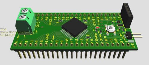

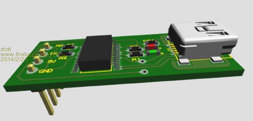

Hello,
There is my idea for micromite.
The microcontrolers I use for hardware design and I was so happy with micromite idea.
Anyway, in my case USB/serial converter I use just for programming and debugging and when job is done I don't need it any more. That is a reason why I maked 2 PCBs: Micromite and USB board. Another thing, for many projects I need 12-15V DC for relay, motors...so this is perfect place for step down converter to provide 3.3V on output and input of 12V to drive some load.
This Micromite version will works with 5-15V on DC jack or 5v from USB/serial converter as well.
I'm happy to share my version with this great community.
https://dl.dropboxusercontent.com/u/42611861/MICROMITE.pdf
https://dl.dropboxusercontent.com/u/42611861/Micromite44PIN% 20-%20CADCAM.ZIP
https://dl.dropboxusercontent.com/u/42611861/MICROMITE_USB%2 0-%20CADCAM.ZIPEdited by ztoti 2014-02-21

Ztoti,
Very good idea to keep Micromite and usb adapter boards separate.
Once Micromite is programmed and deployed, there is no need for usb adapter.
Couple of suggestions:
- try to make USB adapter pinouts same/compatible with the cheap ebay etc. adapters.
3.3v,5v,Txd,Rxd,Gnd.
http://www.ebay.com.au/itm/USB-To-RS232-TTL-Auto-Converter-M odule-Converter-Adapter-For-Arduino-S9-E0Xc-/310807648933?pt =AU_CablesConnectors&hash=item485d945aa5&_uhb=1
- Provide an option for 2 pin PCB screw terminal connector for power connection.
Basically provide pads/mounting holes next to power jack, so that either can be used.
http://www.ebay.com/itm/50x2way-2Pin-Screw-Terminal-Block-Co nnector-5mm-Pitch-Panel-PCB-Mount-K2301-oo-/390733924938?pt= LH_DefaultDomain_0&hash=item5af98e8a4a
- Also consider a Li-Ion battery connector with on board charger for portable applications, Micromite has provision to sleep/wake to conserve power.
To help you take this further I would be interested in purchasing a large number of Micromite PCB's, subject to reasonable pricing.

Hi Ztoti,
Just to clarify, I have several versions of the 44pin MicroMite as I believe the end-user should be able to select the best-fit for their own requirements. I am working on the following options (regarding the 44pin version):
1> Just the PIC32 TQFP with cap & ICSP in a 44 pin DIP format as a plug in module to another PCB or BreadBoard (no PSU included)
2> As above but with 5v & 3v3 LDOs (similar to what you have designed)
3> Eval board designed to (beta) test the MicroMite's features all on one breadboard friendly module including USB-to-uart, ICSP, dedicated 3v3 500mA LDO and reset button. No need to include switches, LEDs etc as this is what you use the breadboard for - i.e. total flexibility to the user.
If you keep the MicroMite & USB separate I will assure you some people will ask for them to be combined; and vice versa. For that reason I am offering these multiple combinations.
It would be easy to add this that and the other, but then that is why it is breadboard friendly!
I also have a LiPo board option with higher voltage/power outputs - design in final stage.
I like your graphics very much - which app did you use?
Phil

Ztoti, WhiteWizzard, guys,
Your boards all look good, different functionality for different folks... I would try to keep the PICkit program header on all the boards though.
I was talking to Zonker a couple days ago. Maybe we can come up with one or more good 44-pin board designs and ask CircuitGizmos or SparkFun or someone else with distribution capabilities if they want to produce and stock them, pre-built and/or or bare boards. Then we could all get them in any quantities.
Any thoughts... Anyone with experience on how that would work out ??
I think the uMite has possibilities beyond all the Picaxe type products.
Lou

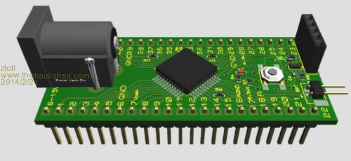

ztoti
Joined: 27/10/2011
Posts: 65
Posted: 03:09pm 20 Feb 2014
Hi all,
I said this is my vision of Micromite, what I need to do my pcb for my project.
If somebody like it, this is free to download.
JohnL thanks for suggestion, I already start to make a new version with Li-ion connector and charger .
About USB/serial adapter, I made it to be compatible with Parallax/Propeller and with Micromite but I'll make a new version.
Zoran

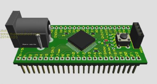

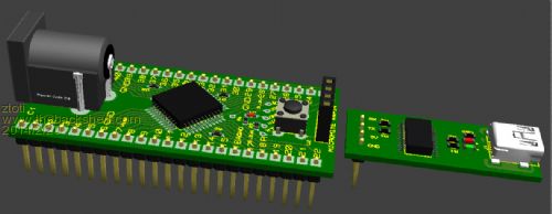

Hello,
I added to the PCB some improvements:
Li-Ion charger, 5 pin connector for USB/serial, Li-Ion connector and I made 2 versions, with DC Jack and with terminal block.
Tomorrow I will update a new version of USB/serial with 5 pins and the gerber files.
Sorry JohnL, no room for ULN2803, this version has to be small DIP package.
Zoran
https://dl.dropboxusercontent.com/u/42611861/MICROMITE3D_1.p df
https://dl.dropboxusercontent.com/u/42611861/MICROMITE3D_2.p df
ps. If any problem with DropBox, please check file extension ".pdf" not ".p df"
Edited by ztoti 2014-02-22
