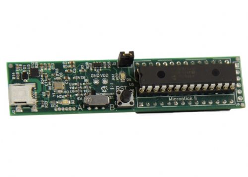

Rather than use a PICkit 3 I decided to use the Microstick II module.
It has a PICkit 3 programmer built in (called the PKOB or PICKIT On Board).
It also comes with a PIC32MX250 and USB cable for $34.95.
The board even brings out the USART pins to the end of the board but unfortunately they are the COM2 pins not the COM1 Geoff picked for the programming communication.
Microstick II at MicrochipDirect.com

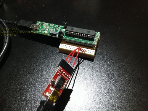

I loaded the .hex file, that Geoff supplied, into MPLAB X and programmed it into the board without issue. I just had to select the PKOB programmer.
Next I found my Sparkfun USB converter module and hooked it up to the board through a breadboard. The Microstick gets its power from the USB programming cable so I left it hooked up to my laptop. I connected the USB adapter to a second USB port and launched Tera Term.
The > prompt showed up. The Microstick II has an LED connected to pin 2 so I wrote a short program to flash the LED. The Editor worked great within Tera Term. The program ran perfectly. So I had success 1st try.
Great job Geoff.

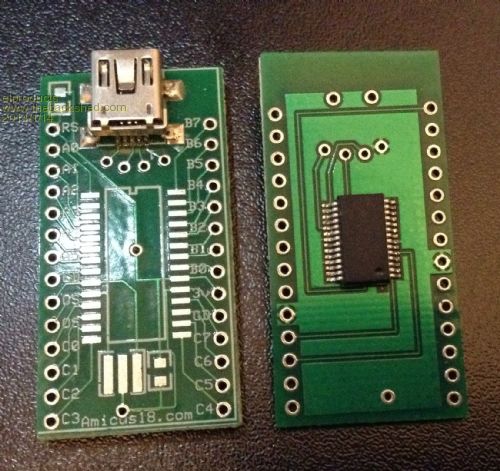

In searching for my Sparkfun USB convertor I found a couple of old boards I designed and never finished. I was planning to make some breadboard versions of the Amicus 18 module but ran into issues with the way they did the FTDI programming. I could never get it to communicate with the Amicus software successfully. But this design would work great for MicroMite.
The FTDI chip is on the bottom and the 28 pin PIC32 can go on top. Then I can just program from the USB connector. The layout will have to change to match the PIC32 but some of the work is already done.

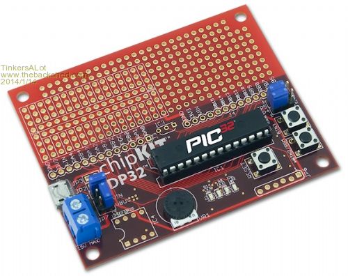

This board should work for a beta-bed shouldn't it?
">clickety Edited by TinkersALot 2014-01-15
