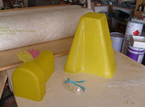

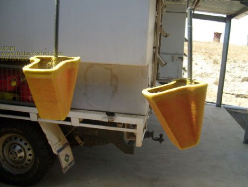

I mentioned that I was doing a bit of fibreglassing - making windmill caps. Here's a couple of snaps - setting on the male mould and off the mould ready for a couple of coats of yellow flocoat resin.
What has that got to do with maximites? In the background is one of my tray top campers and I intend to fit a maximite car and camper monitoring and control system. Loose connection, but a connection anyway.

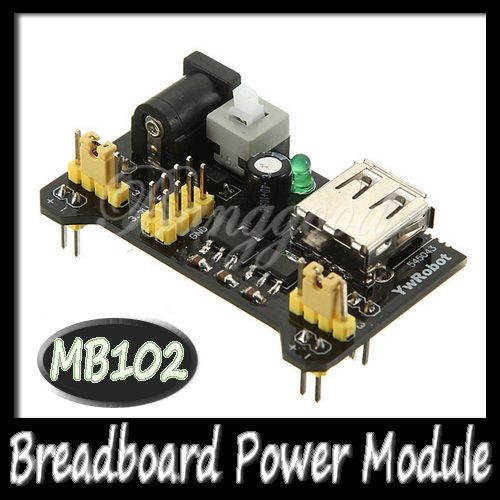

If you don't mind waiting on the post from Hong Kong, you could get one of these for only $2.12 including postage! Link to eBay
Then again, at that price you'd really have to question the quality of the components.

I ordered one of those two weeks ago James - still hasn't arrived but I'm hopeful Mine was $2.69 though! When it gets here I'll load it up and do the same test I did for the other two small supplies a few months ago. It'll be worthwhile to add to that post (now that you've shown me how to do it!
Its specs are:
Input: 6.5 to 12v, or USB
Output: 3.3 or 5.0V
Max output current: 700mA
