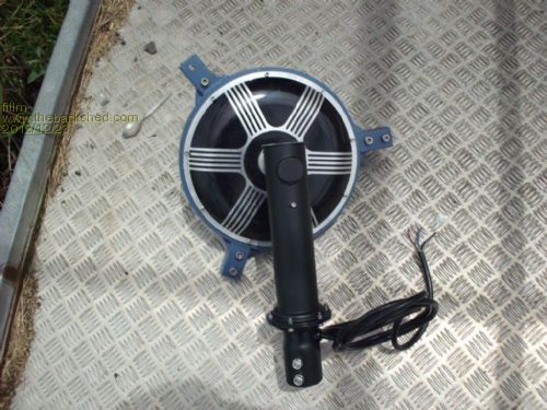

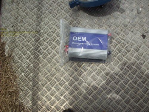

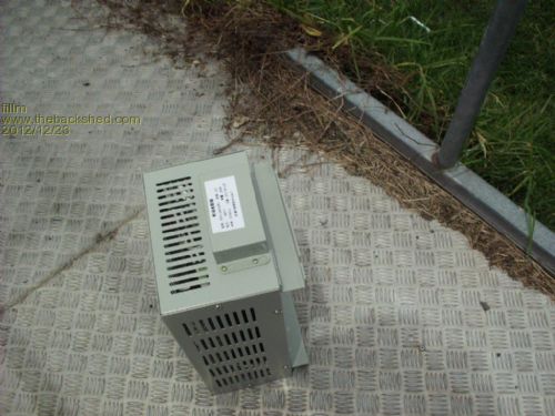

Heres the pics , looks like the old mixed with the new and dumped in Aus .
Posted: 07:19pm 23 Dec 2012
The plot thickens even deeper, with yet another older version of alternators.
That model was before my involvement and i have not seen the bench test results from that model, althought my guess would be it was originally rated as 2Kw with the early test methods used, but later testing methods showed different results and OEM derated most of their mills by about 50%.
So i would class it as a good 1kw mill, which is what you could expect it to produce within a safe working range.
Phill might know more about this model than me, but due to the slip rings used in it and other factors, if it was me i would not be pushing it to 2kw.
We still dont know if it is wired in Star or Delta, and this will effect the rpm to power range of a given voltage range.
On average i would guess Star, but some limited models were produced in Delta.
Pete.
Edit.... On a little closer inspection i think the controller is one of the much earlier designs, also before my involvement, and that model controller dont have logging built into it or even able to change the programmed settings.
The information on the web site referes to the latest designed controller not the old early models.
If its a later new model controller it will have terminals for the anemometer and a computer 9 pin socket on it for the logging, the early controllers did not have these functions.
Also the early controllers dumped power from the batteries to control the mill.Edited by Downwind 2012-12-25
