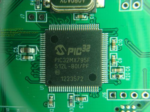

I just received it today. Thanks for including the CAN port electronic components and push button.
If you want to add a CANport to your CGcolourmax1 your PIC32 should look like the one below in the photo.
I guess you need to ask Rob (AKA CircuitGizmos) that the correct microprocessor be installed (not PIC32_MX695F-512L/801PF) if you are planning to add a CANport onto the prototype area of the PCB.
I will start working on it again. Thanks to everybody who helped me get this far.

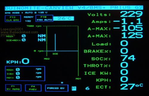

Hi Geoff and Gizmos,
I got my CGcolourmax1 working with my CAN port using your mmbasic V4.2 with CAN commands.
I am using colour Mode 2 and I can only get three colours(one palette) at any one time. When I change palette the existing colours on the screen change to the new palette. Is there a way so I can get all six colours on the screen using mode 2 at the same time.
John Lopez

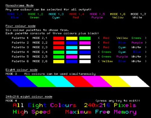

That's what I thought too but the manual tends to read differently. See this image and quotes from P10 of the manual.
This is an example of what can be selected in all four colour modes:
You can change the mode and the palette at any time and as often as you need, even within a running program.
CircuitGizmos
Joined: 08/09/2011
Posts: 1427
Posted: 05:58am 09 Jan 2013
In Mode 2 you get to choose 3 colors (plus black) from the palettes.
Mode 2,1 (palette 1) you get red, yellow, green.
Mode 2,4 (palette 4) you get green, cyan, blue.
Only 3 colors, plus black, on the screen at any one time.
CircuitGizmos
Joined: 08/09/2011
Posts: 1427
Posted: 06:02am 09 Jan 2013
That picture that illustrates the color modes, by-the-way, was done in mode 3.
Posts: 3372
Posted: 02:15pm 09 Jan 2013
Circuit Gizmos is spot on with his explanation.
I should change the caption to that image in the manual. Something like this would be better:
This is an illustration of what the colour modes look like (Mode 3 was used to generate this image)
There is a tradeoff between memory and the number of colours - less colours means more memory for programs (and vice versa). So, if you have plenty of free memory you might as well use Mode 3 (eight colours) but, if you are short of memory, you could switch to Mode 2 (four colours) or even Mode 1 (two colours).
BTW in the above I count black and white as colours.
