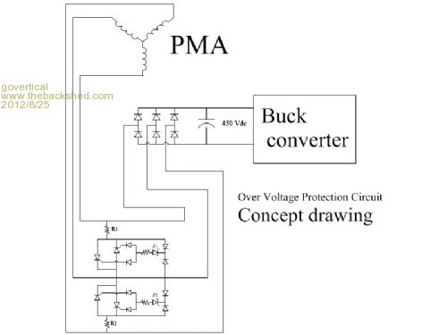

http://www.circuitstoday.com/scr-applications
Greetings, I have found a possible solution for the over voltage protection circuit. The circuit located at number 4 uses the AC to trigger the circuit. I could duplicate the circuit 3 times, one for each phase. When the SCR’s are triggered the added resistive load would brake the turbine to lower the input AC voltage and the buck converter would continue to lower the voltage at the input capacitor of the buck converter on the DC side. I am not sure of the values required. D5 could be two 200 volt zeners in series for a 400 volt trigger. Comments welcome.
govertical
Joined: 11/12/2008
Posts: 383
Posted: 09:30am 25 Aug 2012
Hi, If I can get circuit working for single phase AC, this maybe a possible solution for a 3 phase configuration. Comments welcome.

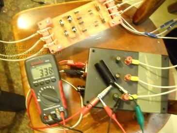

Hi, I tried to test the modified F&P with the OVP circuit. Because I modified the F&P stator I could not charge a capacitor to 400 volts to test to see if the OVP would trigger. I do have my moments. RPM was about 600 and max voltage at the capacitor was about 350 volts with no load.
Even if I add a 1:7 belt drive to the modified F&P I should be safe to road test with the buck converters.
I removed one of zener diodes from the OVP test causing the trigger voltage to be 200 volts. The OVP circuit triggered at about 200 volts and as I increased the RPM’s the voltage at the capacitor remained at 210 volts. The load resistor was only rated at 1 watt and became very hot but the circuit still functions. I have to increase the wattage rating of the load resistor.
It looks like the circuit will work for my application, if used with a wind turbine and the buck converters, the turbine will brake because a resistive load is added when the OVP is triggered and the input voltage at the input of the buck converters will remain at a save value at higher RPM’s.

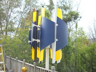

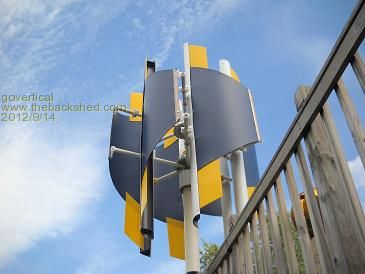

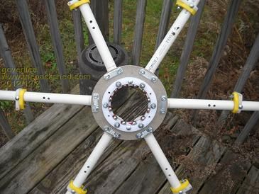

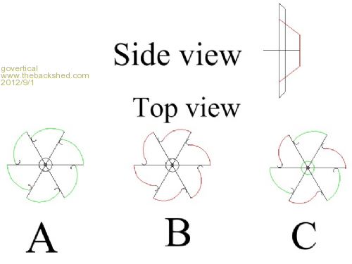

Hi, this is the style blade I can fabricate. The C shape will have end caps.
The big question is what style will have better performance at average wind speeds? Please cast your vote, A, B, or C.
It is a election year.

Posted: 06:27am 13 Sep 2012

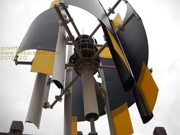

Hi, making progress. Yes you guessed correct, no wind. 3 more blade to go.
http://www.youtube.com/watch?v=cwfujuhw9ZU&feature=youtu.be

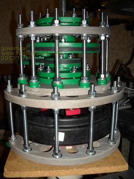

Posted: 12:54pm 14 Sep 2012
http://youtu.be/NJ9XS6IQKzc
http://youtu.be/wfN7aOOSg3g

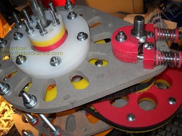

Posted: 03:34pm 03 Nov 2012

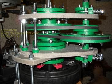

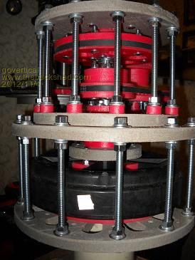

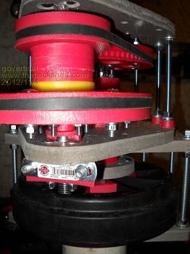

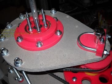

Hi, completely assembled F&P with belt drive. I counted the ratio and it is 1:4, I am going to tighten the belts and run it with the drill press for a few hours.
I ordered a intronics solar MPPT25, it has a battery charging algorithm. The only problem is the max input voltage is 80 VDC. I will have to add a OVP circuit that will trigger just under 80 volts and configure the F&P as four 3phase with 3 coils per phase connected in parallel. I was communicating with one their engineers and he said it should not be a problem as long as the OVP triggers. I plan to continue working on my circuit.

Posted: 06:35am 14 Nov 2012

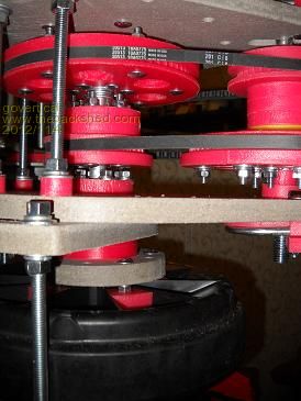

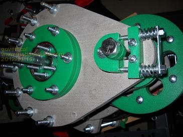

Hi, completed belt drive for F&P PMA. It would be nice to find a supplier for the pulleys. The pulleys are DIY V wall. The belt drive ratio is 1 to 4.25

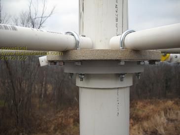

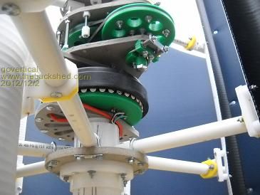

Posted: 02:08pm 01 Dec 2012

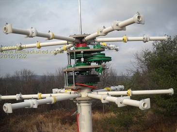

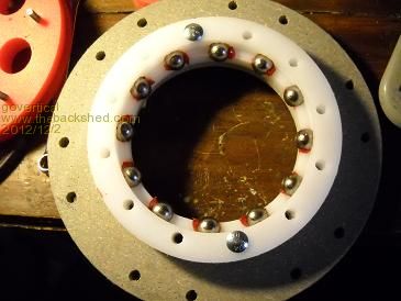

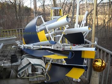

Hi, after observing the VAWT RPM and measuring the VOC in low wind conditions, I decided to mount a stock F&P stator on the 1 to 4 belt drive. I used a DIY 4 inch ID bearing so I could mount the PMA between the two blade rotors. Waiting for wind.

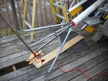

Posted: 12:47am 21 Jan 2013

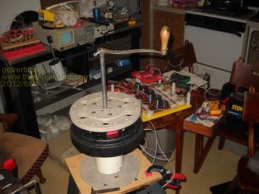

VAWT crash, RIP. 19 MPH wind speed, 3 amps @ 12 volts. Manual operation with hand crank, 5 amps @ 12 volts. Stock F&P with 1 to 2.5 belt drive transmission and MPPT data logger.
Conclusion, even when testing the mast mount needs to be very secure. I need a faster blade design. Without the MPPT circuit output would be very, very low….

Posted: 01:09pm 21 Jan 2013
hi, the MPPT brakes the turbine at 200 volts. The failure was cause by poor foundation construction. The turbine RPM never exceeded 60. Max wind speed recorded was 19 MPH. I should up and running in a few days. Thanks for the suggestions.

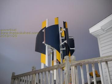

Hi, I had some free time so I fixed the VAWT, strengthen the foundation, removed the springs from the belt drive to prevent the belt from jumping, and it is operational again. To cold to take to take pictures. After reviewing the test results, I am increasing the belt drive ratio a small amount. That should make the output about right for this size VAWT. Waiting for wind…..
