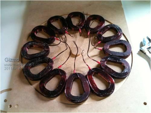

All coils are finished now, big learning exercise, by the time I got to coil 12 I had it sorted. They ended up wider that I planned, there's a bit of a difference in how much wire you can wind onto a former in theory, and in practice. This means the coils are about 1mm bigger is diameter than I expected, so they wont fit side by side in the mold I drew up in CAD. So back to the computer.

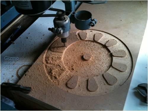

With a slightly bigger diameter stator drawn up, I thought I would fire up the CNC again to made another test mold, but only a couple of mm deep, just to make sure its all going to fit together.
And here we have the coils in place.
All fits, though the wider stator will now interfere with the magnet plate spacing bolts, so I'll have to modify them to clear the stator. Ahh well, it is a prototype after all.

Curious. What's the dark colour in the coils?

I think its just the light Trev, took the pic with my phone. The epoxy is clear, and the copper does have a dark red enamel.
I'm impressed with how strong the coils are when impregnated with the epoxy, these things are rock hard. I'm making a few small changes to the mold to cut back on the amount of epoxy I'll need. I'm using a slow hardener, so hopefully wont have any problems with it overheating while curing. Is it ok to pour in a layer, wait for it to cure, then another layer, sort of thing, to stop any heat problems?
The other thing that concerns me is how easy the finished stator will separate from the mould. I've been using the release agent on the coil formers, but the porous nature of the MDF mold is a worry, I wonder if I should be waxing it. I was also thinking of drilling some holes into the MDF and tapping in wood dowels before I CNC it out. I could then tap the back of the dowels to knock out the cured stator. Any suggestions?

Glenn my mold was done in about 3/4 pours. just be careful of getting resin set hard between the molds this will hold the mold apart and give you a wider stattor.
truth is mine is not that tidy.
LOTS AND LOTS OF WAX MINE WAS MDF TOO.
Posted: 03:10pm 14 Aug 2011
A quicker way is to seal the MDF mold with epoxy resin first, it will soak right in if the MDF is warmed up a little first. Once that has fully cured a light sanding will smooth-en the wood fibers off. Then start with the waxing.
The only molding of coils I did was on perspex instead of MDF. Perspex is much smoother and easier to wax. In this case its better to machine the coil centers separately and screw them in place. With removable centers the lot comes easier of the backing plate and the centers can be knocked out then.
Your fancy XY router should have no problems with that job, right down to locating the coil center mounting holes very accurately.

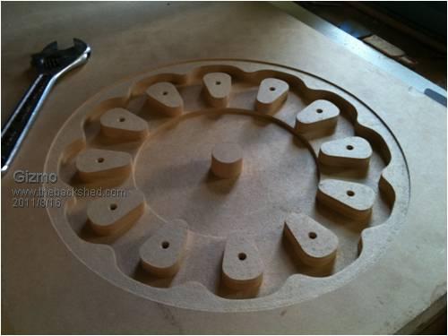

The mould surface does need to be sealed and smooth to make an easy release. If not sealed the MDF will become part of the casting. I used f/glass release wax and PVA release agent to ensure easy release.
I used the laminated chipboard and drew the coil positions on with a compass. I layed one 225gsm woven matt on to the board and being so thin the pencil lines on the board can be seen through it. While still wet I placed all the coils and let it set. Then wrapped insulation tape around the coils to form a dam.
I did lay up in layers to avoid the heat and distortion. It is a good idea. I just used the standard polyester resin which is not suitable for the application.

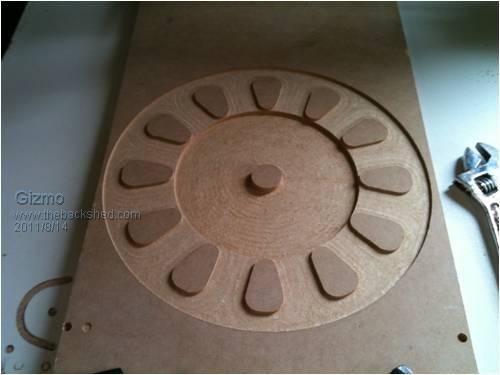

The mold is finished, well, the CNC part anyway. I still need to make the lid from some 12mm form ply. The lid will screw down onto the mold with 12 screws through the centers of the coils, which will make sure they are squashed down to the correct height. Each coil is 11mm thick, and the mould is 12mm deep at the coils, 15mm deep in the middle. That gives me 0.5mm each side of the coil for the fibreglass mat and epoxy.
After taking the photo I waved the blow torch over the mold to remove most MDF hairs, then painted it with some epoxy to seal it. Once that cures I'll sand it and apply the release agent and wax.

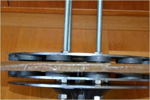

I am amazed by all the stuff you get together, and really envious of the tools you have to make stuff.
This tread btw, is really interesting becouse i am in a middle of a generator build that i have going on, but my cabin rebuild takes a lot more time than i like.
But i have 9 coils of 150 rounds with 1mm wire, not 12 like you who was a really nice idea with the opportunity to change 12/24 volts.
I have'nt gotten any testresults though. I was just putting this together to see if it could get me some power at all.. :)
But I guess you finish before me, so i look forward to the results..
I wish the day had more hours..

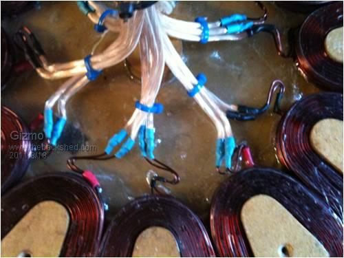

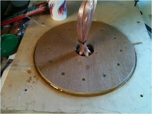

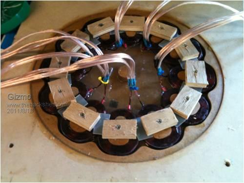

Poured the stator last night and today. This pic is the 2nd pour. All the coils are held in place with timber braces and packing spacers. There is fibreglass mat and epoxy under the coils and around the center of the stator.
When it had cured I arranged the wires so they would be clear of the mounting holes.
Then added more fibreglass mat and expoxy, and screwed down the lid.
I'll find out tomorrow how it turned out. Fingers crossed.

I have never seen anyone connect the cables this way.
How are you going to get them out of the PMA? You have magnet discs on both sides and bolts on the outside of the discs as well.. I am looking forward to see this solution.. :)

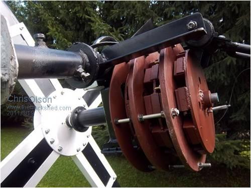

  Gizmo said   I've been drawing up plans for a small axial flux alternator. I was inspired by recent posts about the price rises in rare earth magnets, and Hugh's comments in this thread about the advantages of ceramics compared to the more powerfull rare earth magnets.
Hi Glen,
Interesting thread and glad to see someone else using ferrite mags.
I built this 24 volt dual stator two-phase generator for one of my 3.8 meter geared turbines. It's a bit more powerful than the neo generator, however the ferrite generator assembly weighed 78.8 lbs which is over twice the weight and size of the neo unit. I used 50mm x 50mm x 25mm thick C5 blocks - 40 of them at $1.89 each (this is a 10 pole generator).
It produces 60 amps @ 25 mph wind speed (11 m/s) on the 3.8 meter machine.

Yeah I've been watching your posts on Fieldlines, very interesting. I think there is going to be a future in ceramics, we just need to rethink some of the rules we used for neo magnets. If it means a stacked stator that weighs more, so be it.

That's what I decided. Some of the guys will get a bit bent over the stacked assembly. But with these weak magnets it's an easy way to double the ampacity and power output without getting into something that you can't lift.
I'm enjoying seeing somebody else's experiments with the ferrite mags. There's not a lot of plans out there to built ferrite machines. Keep up the good work!!
