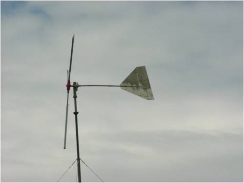

I once built one based on a 12v lucas car generator. It actually worked, I have fond memories or powering a 150w halogen spotlight with it, in about 10m/s, but it only needed about 3 m/s to start making 12 volts. Since the genny in question had a rating of 12 volts, 11 amps stamped on the side, I guess it managed full output.I did some things with it that wouldn't get the tick of approval from the forum, that's for sure.
I wanted low wind startup, so the blades were 1metre by .2m flat plywood, bolted to an armature made of 38x19 tube. The only nod to aerodynamics was to chamfer the edges with a router. The blade angle was achieved by running an angle grinder cut down the side and squeezing it shut and welding it, giving a sloping surface to bolt the blade to. The field windings was wired to the positive terminal of the generator, via a 1 ohm 40 watt resistor, I figured that would bleed enough excitation current in, given that the thing had enough residual magnetism to start at very low revs.
With all that blade area, it certainly had good staring torque, but too slow. So I used an old holden water pump for a bearing housing, an EH holden engine pulleys to gear it up about 4 to one. Worked real good after that, but the tail kept falling off.

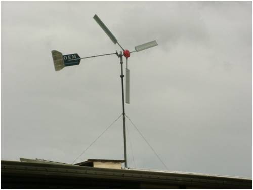

These are an excellent little unit that have a problem in that they are capable of to much power and do not like to be shorted to stop them.
I have had one working for more than a year now in delta on 24 volts with very good results, the original furling is a bit sus but a change to 3 deg lay back and 9 degrees side makes the furl at around 15 MS Tail length needs to be increased to 6 foot for better tracking. 3 more on the way this year, to try different configurations.
Phill recommends star with voltage caps but I use delta with a boost module it starts charging at 2.5 MS and will do 30 amps at 15 MS into 24 volt system charge volts 30. Before I got the furling set up I did see 50 amps on occasion and that is enough to destroy the unit if kept up or shorted to stop it.

The one I have up at the moment has ventilation holes in it, but I do not think they a necessary if the machine is operated at its rated level 500 to 700 watts, the two things that can destroy these alternators and any others for that matter is prolonged overload in excess of 1000 watts and not furling properly as the centrifugal force distorts the rotor causing magnets to rub.
The other killer is the shorting switch brake if used when they are already very hot as to short the windings can cause very high amps at very low volts and nearly instantly cook the windings as the inertia of the blades packs a fair amount of kinetic energy. If you must use a shorting switch make sure there is enough resistance in circuit to dissipate the energy so it not done in the windings.
The units are light and efficient and easy to work on and with, the blades are in my opinion the best I have seen on a small turbine and the price is right, the complete kit only cost a little more than a set of neo's for a AFAX. OK not the high output but id really performed in a low wind environment.
