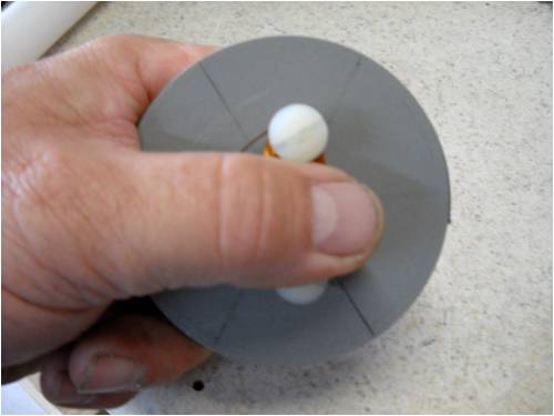

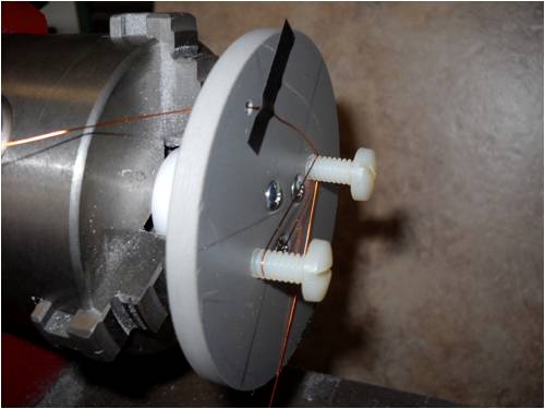

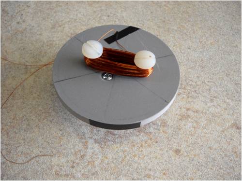

First off, I built a little gadget to wind the coils with using my lathe. As easy as this might sound, it was actually anything but easy.
Here's what I came up with. It's a sheet plastic disk screwed to a plastic
hub. Everything was spun and cut on center. I added two 1/4-20
plastic bolts, which serve as posts on which to wind the wire. That
black stripe is so I can count the turns as it spins chucked in my lathe.

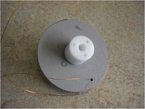

Here it is from the back side showing the three little 6-32 threaded holes
that house the three screws, which hold the plate to the hub. That small
hole in the grey plastic is a "keeper" used to hold the starting end of wire
while the coil is wound about the two plastic screws on the face.

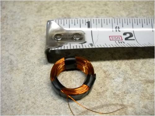

Here's one completed coil. Note the size; it's tiny. Nine of these little
rascals will share the space between the two 12-magnet wheels.

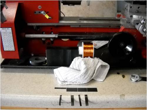

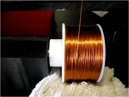

I manufactured a spool holder and stuck it to my lathe bed using a
magnet (temporary mounting). The towel adds "drag" to the spool of
copper wire. I found out the hard way what happens when an unbridled
spool of wire traveling too fast gets away; bird's nest mess! The towel
slows the feed and I put the lathe in "granny gear" and ran it way slow!
Those little black strips are electrical tape that have been scored with
a razor knife. I use them to tape the sides of the coils so they won't
unravel.
This shot shows the spool of copper wire and the rag underneath
helping slow it down so it doesn't get ahead of itself and make a bird's
nest.

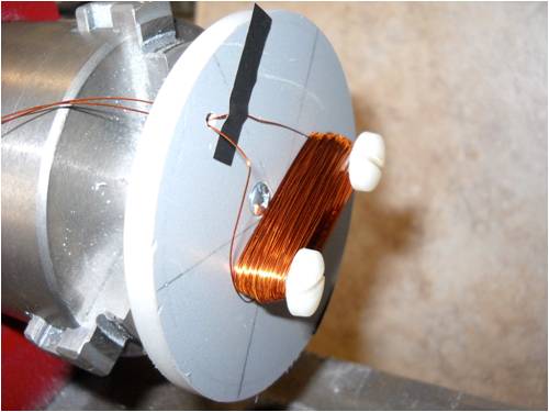

This is the winding plate and those two nylon-plastic bolts. The little
hole keeps the end of the wire out of the fray. I also tape the wire
where it goes through the little hole in the plate. This keeps it tight
against the plate and not interfering with the rest of the windings. A
small piece of tape on the circumference gives me a visual cue as to
how many turns the thing has spun. These coils each have 150 turns.
Here is one 150-turn, 30-gauge enameled copper wire coil ready to
be taken off the winder.
Remember to hold the coil so it doesn't jump off and make a mess
when the turning-peg screw is removed. I just slipped the coil over
the top of the remaining screw and taped each leg with electrical tape.

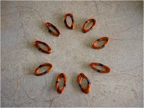

Here are all 9 coils arranged in a circle. The next step is to make a mold
and encase all these coils in epoxy. Something to keep in mind is the
direction of the wire in the coils. When three coils are tied together
forming a single "phase" you'll want to know which wire is which. If
you hook it up backwards it won't do diddly; we don't want that!

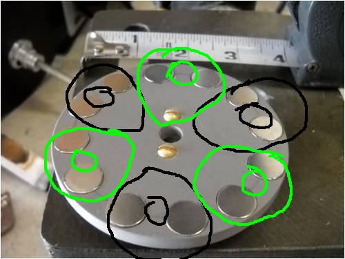

i wonder if with a smaller machine just using a simpler single phase winding would be ok ...
you could fill up the stator pretty good with copper (heavier gauge wire) and let each mag cover one leg completely...not as good as multi phase i know but simpler to get your head around...
sorry ignore the colours each coil is in series with the next
Edited by niall1 2010-07-08
niall
oztules
Joined: 26/07/2007
Posts: 1686
Posted: 12:29am 07 Jul 2010
It will need all the efficiency it can get, and the vibration with single phase may shake it to bits.
.....oztules
niall1
Joined: 20/11/2008
Location: Ireland
Posts: 331
Posted: 12:44am 07 Jul 2010
ouch.....
i kind off promise not to speak about single phase again .. ...erm god does love all his creatures though ...at least ....i think he does....
and yes ...single phase does rumble a bit (lot).... Edited by niall1 2010-07-08

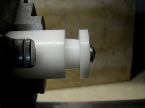

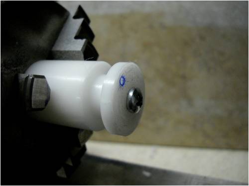

I manufactured a new coil winder this evening after work:
It's one piece of 1" acetal rod with a 10-24 thread running down the
middle. The end is a 'washer' I cut off after threading things. Note
how the center thimble is tapered. This lets me slide the finished
coil off the thing without having to tug.
Look closely and you'll see a little "blue-ringed" hole cut into the end
washer. This lets me thread through the initial piece of wire for each
new coil. The hole holds the wire in place for the first several turns.

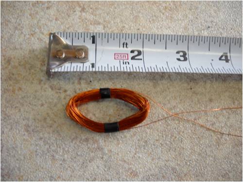

Here's a finished coil. The inside diameter is 1/2" and the outside is
just under 1". It is 1/4" thick and holds 200 turns of 30-gauge wire.
There was enough wire on one of the previous 150-turn coils to make
this one with even some left over.
I have not yet tested the coil. I had to play plumber (my profession) all day long and didn't get home until about 8 p.m. Tomorrow, I'll chuck up the 12-magnet-pair ax-fx wheels in the lathe and spin it at several known speeds to determine how much voltage one coil makes. Once I know how much electricity (a.c.) a single coil produces, it will tell me how to make the other 8 coils. There are to be 9 independent coils in the stator when it's a done deal.
I found that by cutting a 1/4" strip of electrical tape about 2 inches long, it wrapped around the coils of wire while it was still clamped inside the winding spool on the lathe. When I slid it off (it almost "jumped" off the winder peg by the way -- thanks to that taper I cut into it!) the winding peg, I held it gently and wrapped three more little 1/8" x 1" electrical tape pieces at 120-degrees around the circle to hold all the tiny wires in place so I can handle it without things coming unraveled.
I'll post the coil-test results as soon as I can take the time.
. . . . . . Mac

Pete
Thanks for that. You see, all along I've kinda wondered what "in hand" meant. Now I understand. It makes perfectly good sense both from an electrical as well as a plumbing point of view.
I'm going to see what I get with the 200-wind coil I made this evening gust for kicks & giggles anyway. I already took the time to build it; may as well test it, eh?
I still think a basic terminology section would be well worth the time it would take to build and post here on the 4m. This is a perfect example. "In hand" may be somewhat of a colloquialism but for someone not of the same region, it's Greek! Then again, maybe I'm just thick; thick headed -- the rest of me is getting pretty fit of late!
. . . . . . Mac
Copeville, Texas
