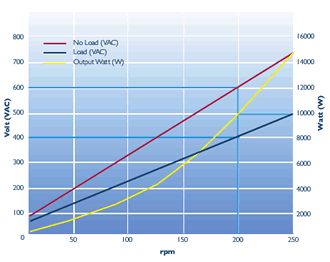

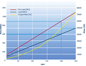

heres an alt i came across a while back
10k
i think they are axial flux (the smaller units certainly are) and suspect the price is astronomical but certainly seem rare and interesting
50k ?
