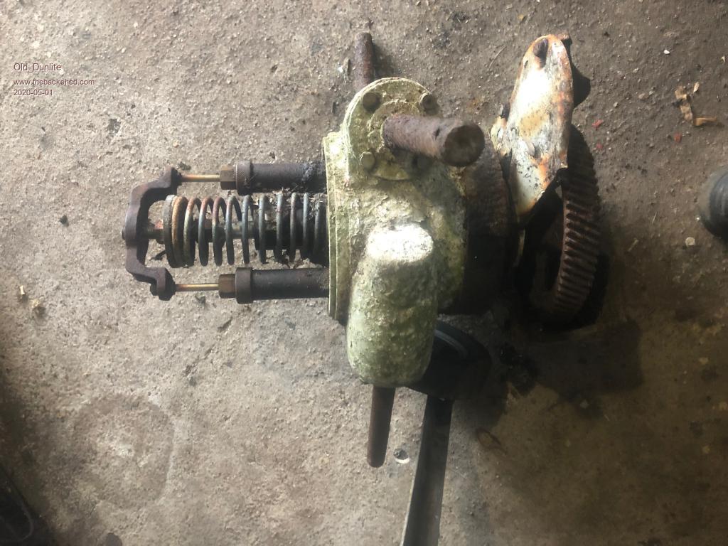

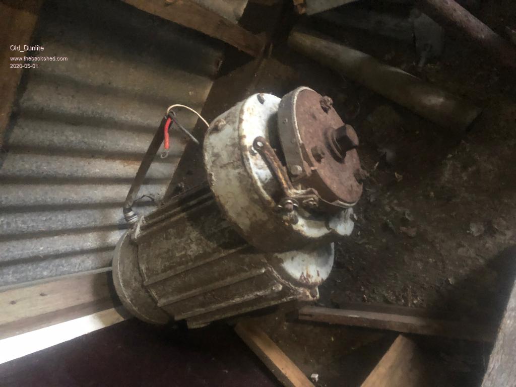

Sorry to bump up an old thread but I have a few questions about some wind generators I've found lately.
These were all dumped in the bush where I live and all ex-telecom. I spent a few days hauling them back home (which was a mission).
There is:
-1 broken one
-1 complete but full of water (likely) with generator
-1 spare generator that has been stored in a shed.
If it's possible I'd actually like to salvage parts and make one working one. Obviously I'm missing a fair few parts.
Is there anyway to identify what I have here? And how the heck do you disassemble these things?

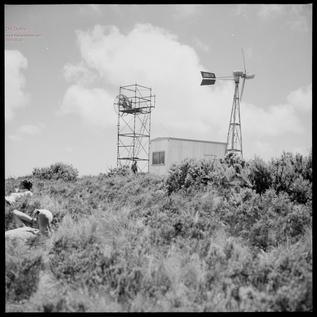

I have found a photo from 1968 of one of these things installed here but that hasn't really helped me narrow down the voltage. It was a big telecom operation so they could be 110v...
I've found this website: http://www.pearen.ca/dunlite/Dunlite.htm
It's very helpful.
Edit may 2nd
-added the photo from 1968

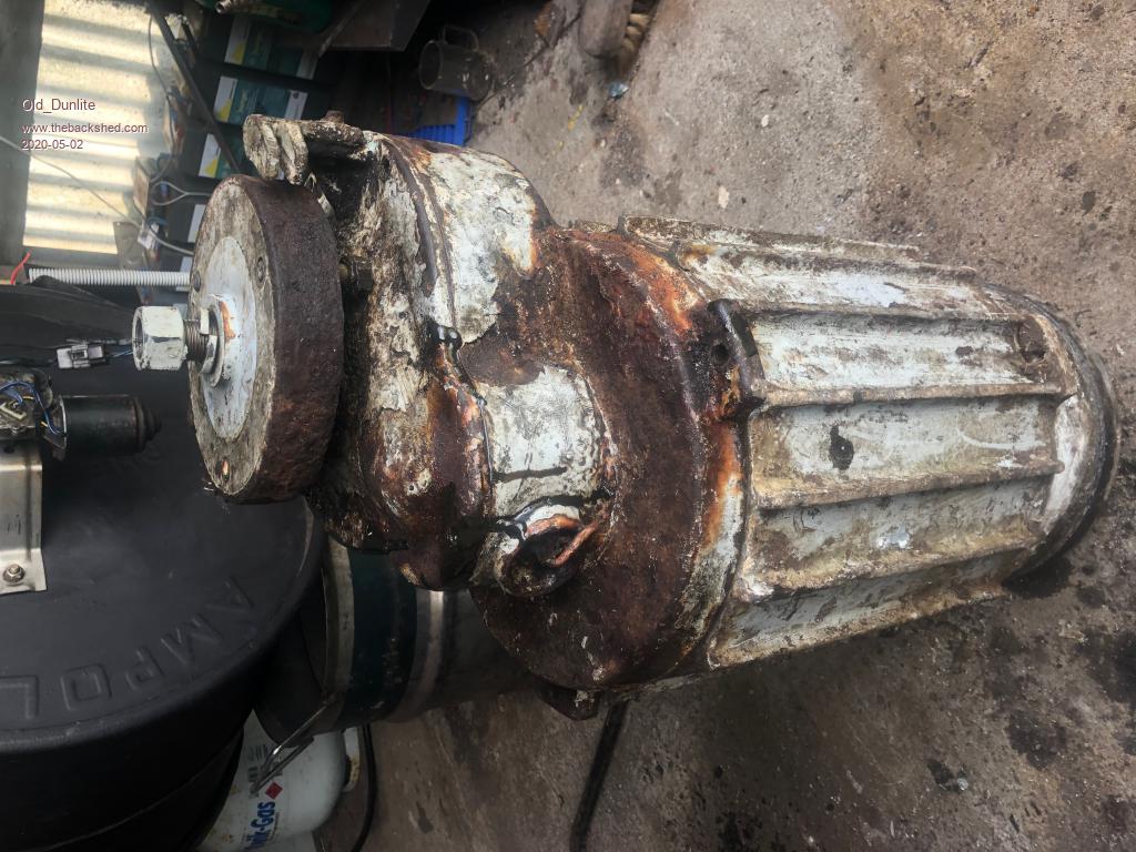

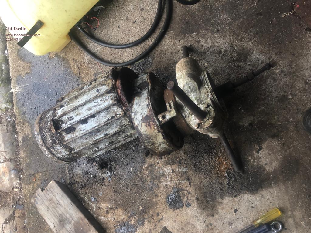

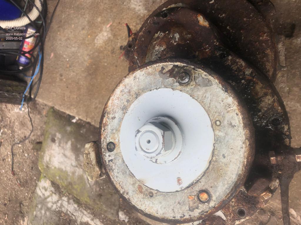

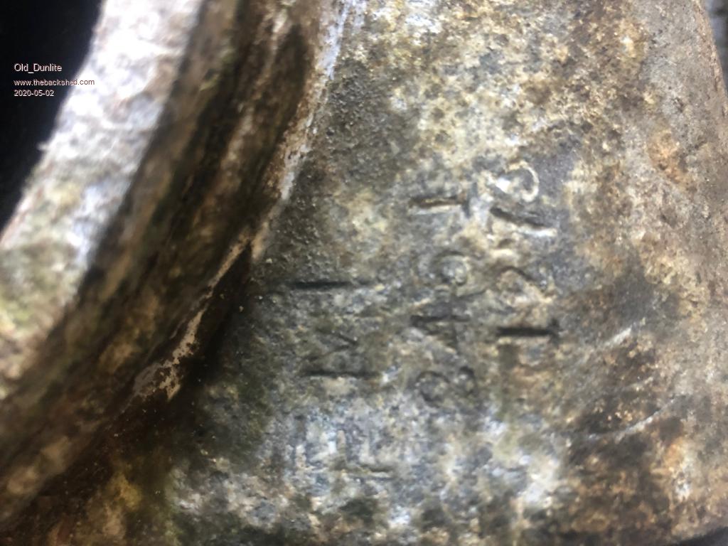

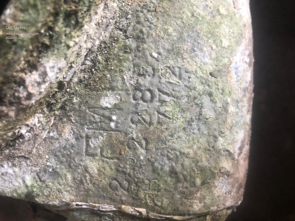

Today I started pulling the complete unit apart. I got the hub off and that was about it. I've got the main long shafts that hold the generator to the turbine off but for the life of me can't figure out how to separate the two. Any advice?
Also got a few numbers from the hubs, aside from them I haven't seen anything legible.
I'd love a manual that shows disassembly of these units but cant find anything.
Edited 2020-05-02 16:25 by Old_Dunlite

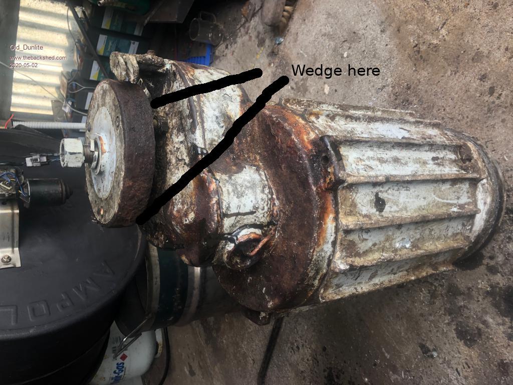

Posted: 10:11am 03 May 2020
I have taken apart plenty of sized up thing's, mostly successful.
Usually I would have a puller that would do the job, but no always, if that isn't an option, run the nut down level with the end of the shaft, stops the thread from being damaged, knock in 2 or 3 wedges here (see arrow)
not too tight or there will be damage. then place a piece of brass, soft metal or lump of wood on top of the nut and shaft and give it a sensible hit with a suitable size hammer, see if that helps.
There are a few other methods of persuasion but that's a start.
A Manual for the parts would help...but wheres the fun in that.
hopefully get to see the gears.etc.
My apologies if I've misunderstood which part is stuck, most things have an particular order take apart.
good to see the pictures.
Cheers Aaron

I installed a survey site for Telecom ,Years ago , and it might have been this one ???
I did a few ,Ocean View, near glass house mountains .  and  a few more here in Old and New Guinea.
Have you any idea where this site would be ?.
All these sites have power now or Solar. I did about 30 sites of solar in PNG ,bet they are all trashed in the jungle now -the locals loved the copper wire ,used to pinch it to make necklace beads and all sorts of market stuff to sell back to us tourists.
That front hub--- get the biggest hammer and whack it sharply on it's edge ,seen guys remove frozen stuff like that before-works every time ,especially if you don't own it !!!,lol. ( or local mechanic might have a big press ).

Bruce it's in Tasmania, ring any bells? Site is no longer an active telecom site but it was in the 70s.
The only thing I don't want to do is break anything! A little scared to wack it with the big hammer yet haha! Do you know if it has to be disassembled from the top down? I'm unsure how the alternator casing separates from the top sections.

Try some heat first, and maybe some WD40 or penetrene. Give it a day or two to soak right into the joint.
With a few pieces of angle iron and some long bolts you may be able to rig up a kind of puller, and use the giant nut on the end to pull the whole thing forward off the shaft as the nut is unscrewed.
I think leverage against the gear case is very likely to result in some tears.

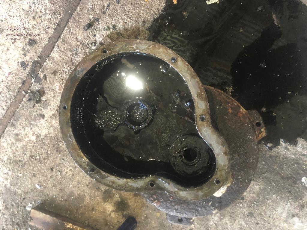

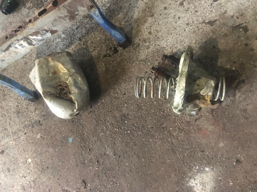

Managed to get the hub off and the brass thing under that. Also the end cap. Alot of water ingress into that section.
Still no luck separating the gearbox top housing from the lower aluminium housing.
Thanks for the link to that document, however my turbine is the Type BP 2kw and slightly different to that diagram. However the pearen.ca website has the correct manual.

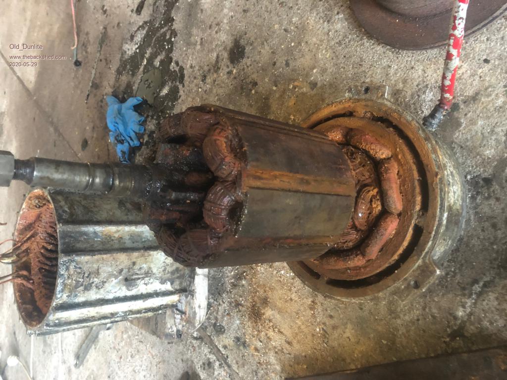

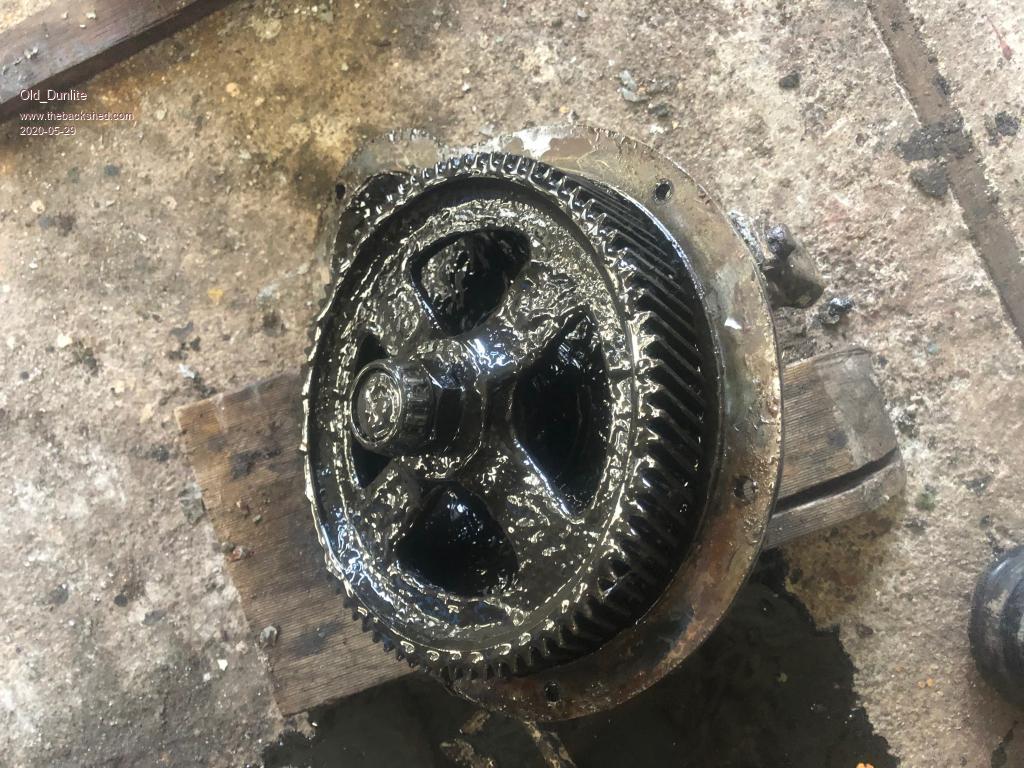

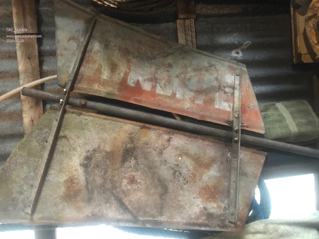

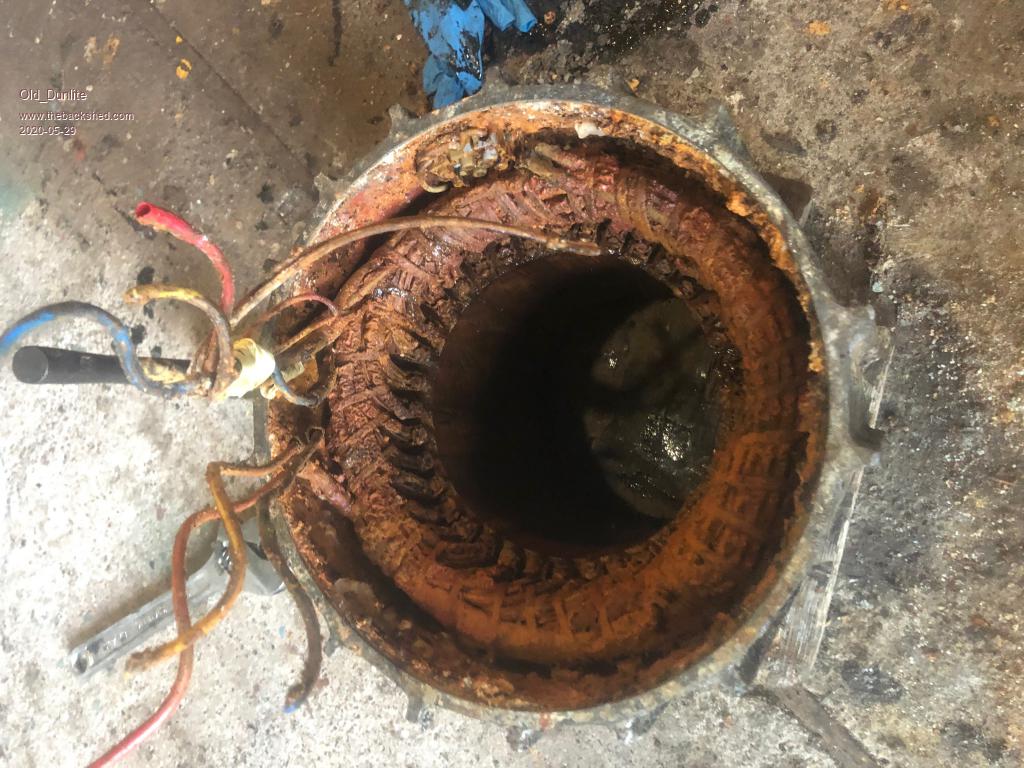

Well I finally managed to get a good amount apart. It took alot of penetrating oil, hammers, heat and leverage... And spare time! Luckily the gearbox didn't suffer from water ingress, however the alternator casing did. It's pretty crapped out.
I still don't know the voltage of this unit. Sitting in the bush for that long any stamps it previously had are long gone.
I also managed to find a smashed cradle mount (also hidden in the bush) and two old towers. From them I removed a brake handle and the broken cradle. Unfortunately no good cradles here.
In another scrap pile I found the tail vane pictured (dunlite). Also found 1 X Quirks tail vane, but it is very large.
New photos:

Hello Ol Dunlight ,
 Gee, looking inside that mess,I'd be sure you could get a really worthwhile genie out of it.  A bit of bush and muddies, but thats, cosmetic ,clean it up and you have a really well built genie,by the looks of it.
That angle cut gear is what made me sit up and take a second look -you be flat out getting engineering like that today.
If you matched it with PhillM 's blades and a bit of his engineering mods, you'll be on a winner.  Reckon  she might have been 32 volt ,but I built and rigged those scaffold towers in telecom, They were temporary,I did lots of microwave surveys for radiotelephone,and early television translators in Oz .I go back 50 years.
So, 48 or 32 volts a possibility , and cleaned up inside, that winding and they look like old secondary windings or magnets on the end plates-let us know ,when you clean it up -Oh,, another thing ,, consider converting it to Neo magnets , There would be no such magnets in those days...
I like it ,,there's a couple new ones in the PNG jungle if you can get "those "Janes" to go with you ,only grass skirts required,

  brucedownunder2 said  Hello Ol Dunlight ,
Bruce
Hi Bruce,
Thanks for the message!
Good to hear that you think it's salvageable. I'm certainly out of my depth in some ways with this project, but that's why it's long term!
I'll have to check out PhillM's stuff!
The reason I think it's 48V is I found some old schematics here that show 3X 48V wired up with 2 X Dunlite generators as backup. That was for telecom. However, it may have being a spare or another one they trialed prior to 48V, who knows. Not really sure if there's any way to tell if there isn't any markings on it at all?
Did you do any installs in Tasmania by any chance (that's where I am)?
Really the only part i'm missing is the cradle (the one I found is pretty buggered), propellors and tower. Theres a guy selling a smaller model on gumtree currently for about $3000. If I was in the area I'd probably buy it, there really is nothing comparable to these units.
We currently use a 48V superwind 350, which is great as it's lightweight and easy to install, but it's only 350W. It's a shame that nothing is really made like these old units anymore. I've read reports of these things lasting 7 years in Antarctica and 30 years in the field with little maintenance!
I'd be happy to retrieve the ones in the jungle, if they didn't weigh 450-500 pounds!
Can I ask what you recommend using to clean up the magnets and wiring? Pretty limited here with what we have and I don't want to damage them further!

I did some work in Hobart installing the ABC transmitters and a link to that mountain .Always remember that, as we were coming back for Xmas break and their was snow and ice on the ABC tower, late Nov. !!!!
Clean up ,gee, I,d get stuck into it with kero or diesel with a stiff brush .Could use a Gerni ,but not around the wiring.  If you can get the case parts naked, (remove bearings,Etc) have someone sandblast it with care, mainly the exterior .  The cradle,,, why not build a new one out of angle and plate , fit it ,make mods , then have it hot dipped gal'ed.
 Phill would steer you right if you decide to use his blades and he's made the hub for them.
Neo's, do a bit of drawing to see what will fit and where , then search for the size that would suit. They are usually protected, so inside the case you'd expect to get a couple years without maintenance..They'll be an expensive item .
 Bruce
